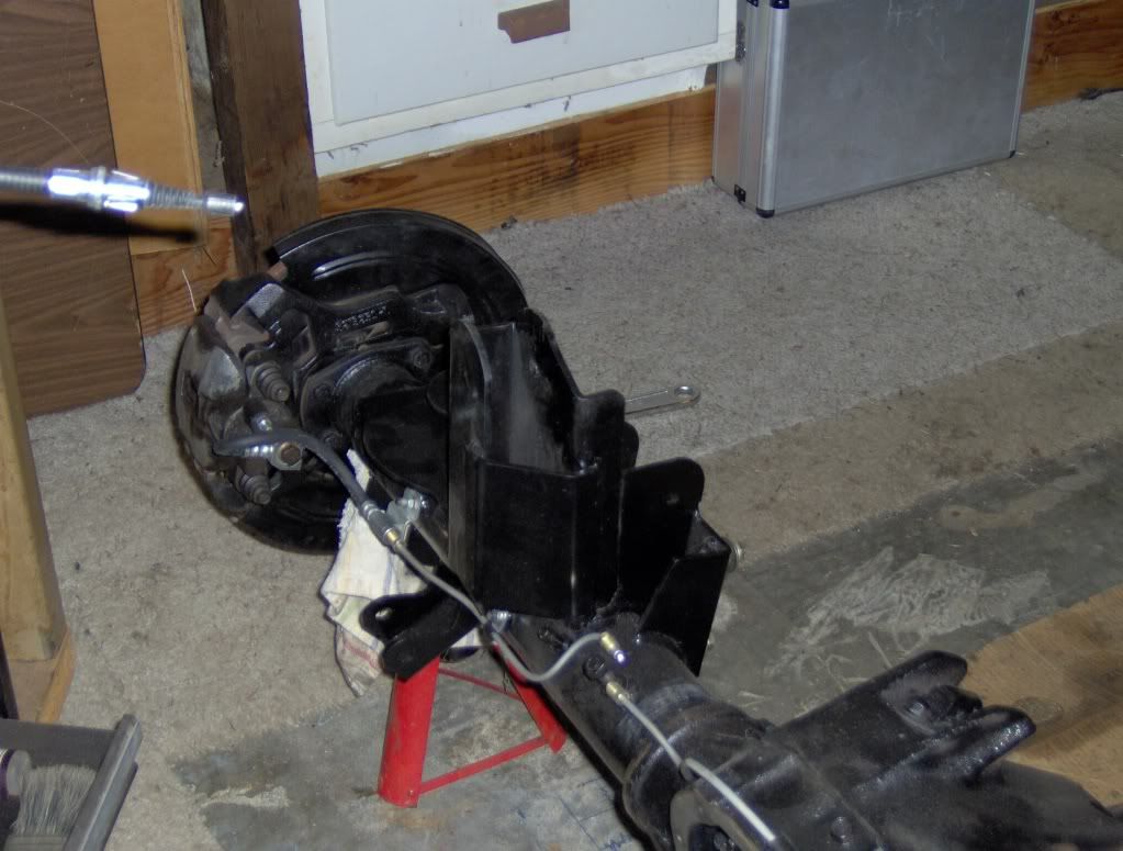

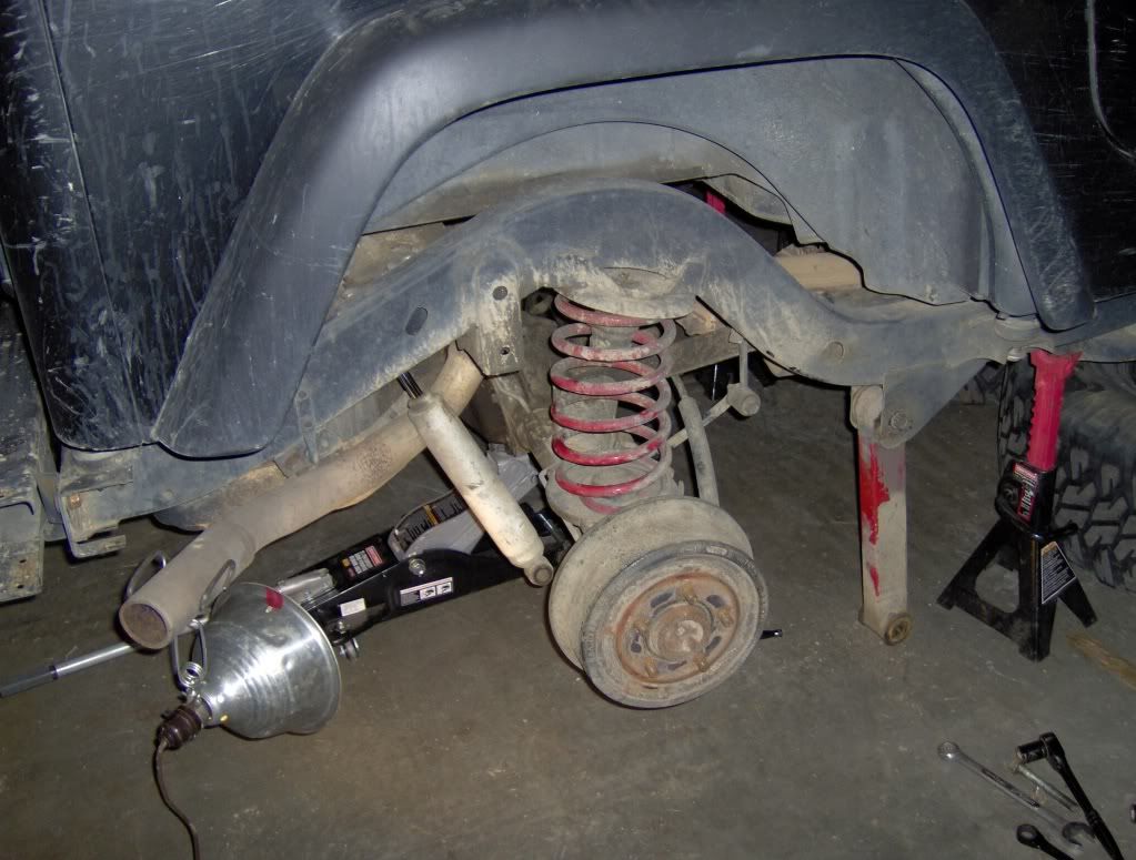

Yeah I can't wait :p Hahah we'll see how it performs, I'm sure it will be astounding. Started the 8.8 swap tonight...
http://img.photobucket.com/albums/v2...p/HPIM1949.jpg
http://img.photobucket.com/albums/v2...p/HPIM1950.jpg
http://img.photobucket.com/albums/v2...p/HPIM1951.jpg
straightened the bracket
http://img.photobucket.com/albums/v2...p/HPIM1952.jpg
new vs old
http://img.photobucket.com/albums/v2...p/HPIM1953.jpg
clean slate
http://img.photobucket.com/albums/v2...p/HPIM1954.jpg
http://img.photobucket.com/albums/v2...p/HPIM1955.jpg
this didn't line up, had to hack it off
http://img.photobucket.com/albums/v2...p/HPIM1956.jpg
http://img.photobucket.com/albums/v2...p/HPIM1957.jpg
I'll weld it back on later
http://img.photobucket.com/albums/v2...p/HPIM1958.jpg

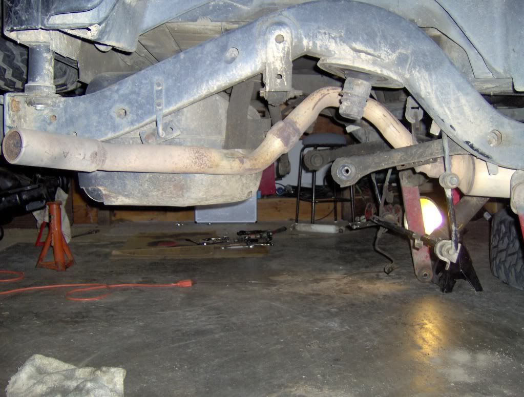

gtxracer 02.21.2010 03:01 AM
this is as far as I got tonight, more tomorrow

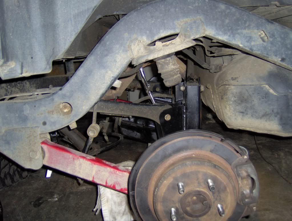

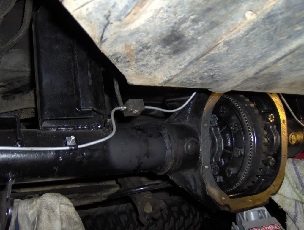

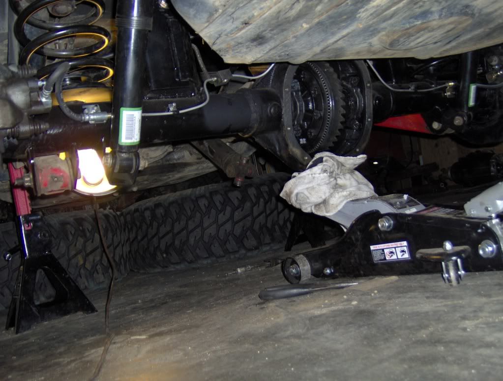

More progress tonight. Had a couple small snags but nothing big.
http://img.photobucket.com/albums/v2...p/HPIM1968.jpg
Got everything in there, not all the way buttoned up but on all fours again
http://img.photobucket.com/albums/v2...p/HPIM1969.jpg
http://img.photobucket.com/albums/v2...p/HPIM1970.jpg
pinion angle, might need to take out those pan spacers
http://img.photobucket.com/albums/v2...p/HPIM1971.jpg
http://img.photobucket.com/albums/v2...p/HPIM1972.jpg
I measured the Jeep again and it's lower in the front but seems to be the same in the rear. I might have to put a 1" coil spacer up front to even it out. I have the hardtop and spare on there and it's still higher than the front I think. I'll measure everything again when I get everything done.

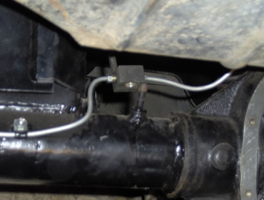

Taking out the spacers on my belly pan seemed like an easy 45 min task. Not so much. One of the nuts that is inside the frame came loose and was just spinning with the bolt. Thanks previous owner :no:
http://img.photobucket.com/albums/v2...p/HPIM1976.jpg

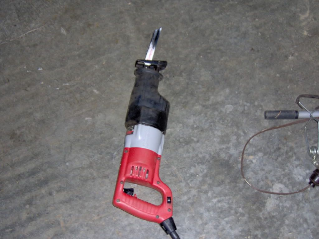

Tried a sawzall...ate FOUR of my blades and only cut half way through. wtf? Must be a grade 8 bolt! http://img.photobucket.com/albums/v2...p/HPIM1977.jpg
Busted out the grinder and cutoff wheel...got that sucker off there. Also got the insert out so I can put a new nut in there if I can find the part and order one.
