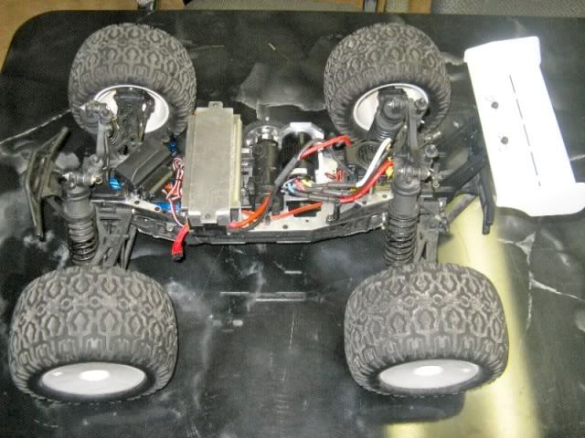

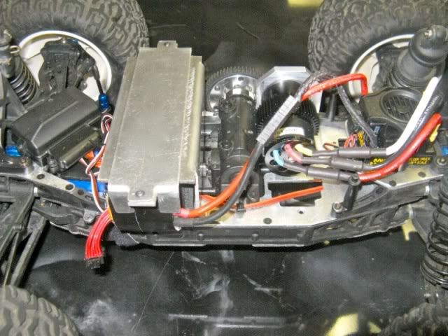

jpoprock 04.16.2010 04:21 PM
Here is a center shot of my ELST2.
http://i143.photobucket.com/albums/r.../E-LST2_20.jpg
http://i143.photobucket.com/albums/r.../E-LST2_19.jpg
I'm waiting for my buddy to get some XXL stuff cut, then will move everything over to the XXL chassis. I think we're making custom chassis too. It's a bit cramped here on the LST2 though, and I knew I'd be taking it all apart again anyway. So I didn't spend a lot of time with detail, but will.
I'm using a Revo receiver box that is screwed (tapped) into the existing tray, and a custom cut ESC tray shaped like the original one. The battery hold down is ok, and works. But it's too big, and has too much weight to it. That's going to be redesigned. I love the hold down that Maneba made!! Very nice!!
When I move over the XXL chassis, I'm going to gussy it up a bit and make everything much cleaner.
That being said... this ELST-2 with rear sways only is a pure DREAM to drive. My nitro XXL was too, so I know it's gonna rule after the conversion!!
