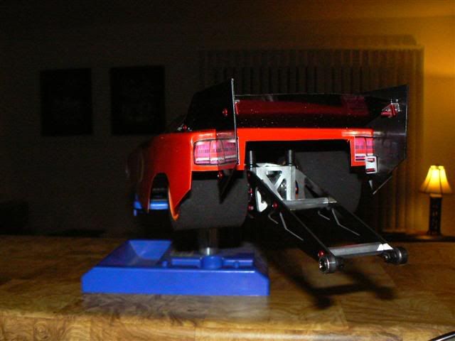

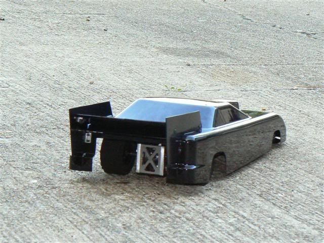

Here's the back of my RC funny car showing an "aid" to evacuate air out the back of the car:

And same from my True 10.5/Pro Stock
http://i256.photobucket.com/albums/h...40057Small.jpg
Mind you, the funny car goes 90+mph and weighs at 48oz (3lbs) and hasn't been airborne at those speeds. That gives you an idea how effective low pressure under the body is. Also note that the angle of the wickerbill is not that extreme: just enough to be effective and not create a lot of resistance.
PBO 05.31.2010 09:54 PM
That is in essence a diffuser...just a very large & efficient one, sucking the car down harder, the faster you go
SunnyHouTX 05.31.2010 09:59 PM
I don't consider it a diffuser in the strictest sense simply because the area of influence of the low pressure created is much larger here, but that's just me :rules:
But the important thing is that this all helps keep the car stuck to the ground :yes:
