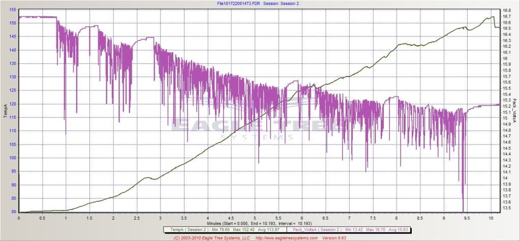

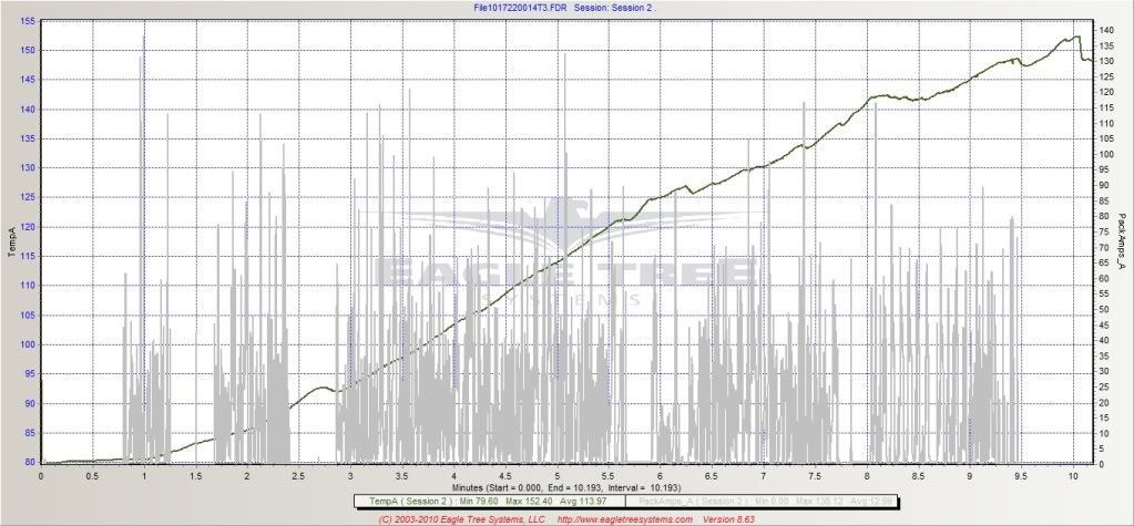

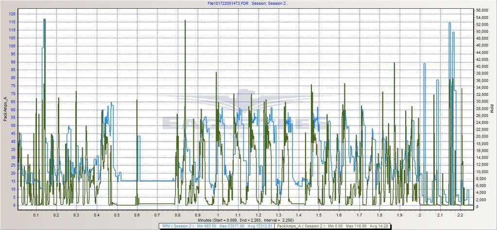

Here are the graphs. Keep in mind that last huge voltage dip was in a chicane not on a straight. My LVC was set to 3.1 V/cell for this test. I also tried firmware 1.29 for this test and aside from maxing out at 138A instead of my usual 110-120 the results were the same as 1.24.
Volts
http://i48.photobucket.com/albums/f2.../10172200V.jpg
Amps
http://i48.photobucket.com/albums/f2.../10172200A.jpg

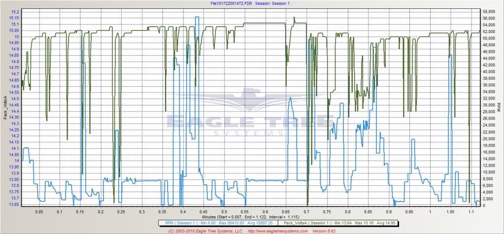

And the moment of shutdown including that huge drop in voltage:
http://i48.photobucket.com/albums/f2...f/1017zoom.jpg

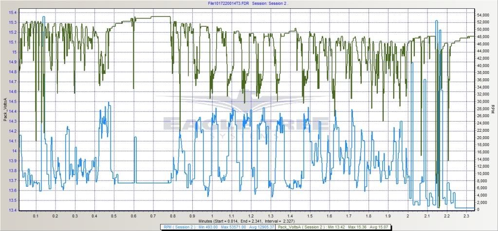

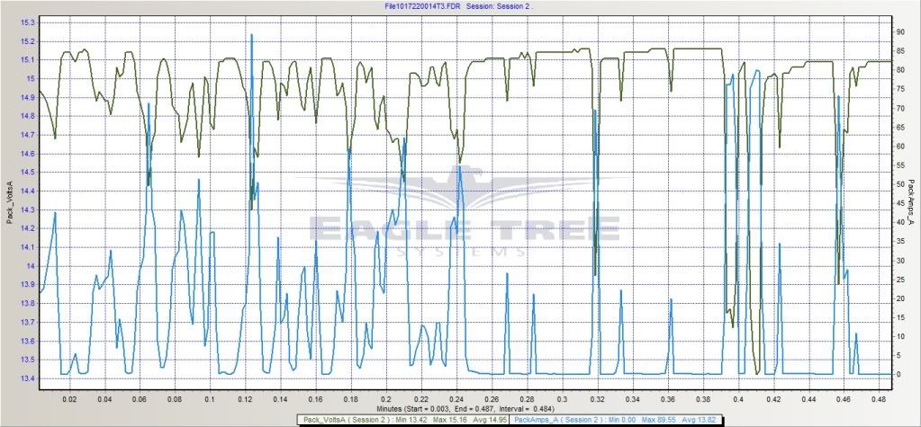

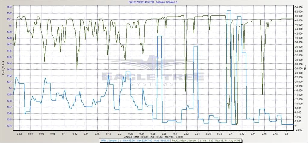

I just thought of something. Those huge voltage drops coincide with glitches in my eagletree brushless rpm sensor which reads esc pulses. I'll post a graph with the rpm when I get home from work. I wonder if that could indicate an esc problem.
KniteWulfe 10.18.2010 07:14 AM
Here they are:
When the ESC died, same as the other zoomed graph.
http://i48.photobucket.com/albums/f2...f/1017rpm1.jpg
RPM and V during a couple of the other glitches:
http://i48.photobucket.com/albums/f2...f/1017rpm2.jpg
RPM and A:
http://i48.photobucket.com/albums/f2...f/1017RPMA.jpg
pinkpanda3310 10.18.2010 08:57 AM
Something is not right there. Looks to me like you are using a 4s pack and getting over 50k revs from the motor.
16.8V * 2200kv = 36960rpm
KniteWulfe 10.18.2010 09:09 AM
Actually, something is causing the sensor to glitch. It reads the pulses from the esc to the motor, and since it is happening most often when I see huge voltage drops which sometimes don't even have an amp spike, I'm wondering if it could be a problem with the esc. Also I forgot to mention it reads 7k rpm at 0 but that is apparently normal for certain esc's and everywhere else is accurate. I think it might be when it's cogging that it glitches but I can't say for sure.
pinkpanda3310 10.18.2010 09:23 AM
So if i understand you correctly, with or without amp spike's the cogging and glitching and heat issues arise when the voltage drops too much? Does it only happen when the eagle tree is hooked up? (just had to ask) And the LVC is definitely set to 3.1v? If it was 3.4 that might cause issues (3.4*4s=13.6v). Just trying to think it through :) What if those glitches were not glitches but a problem of the esc? Hve you tried a better battery yet?

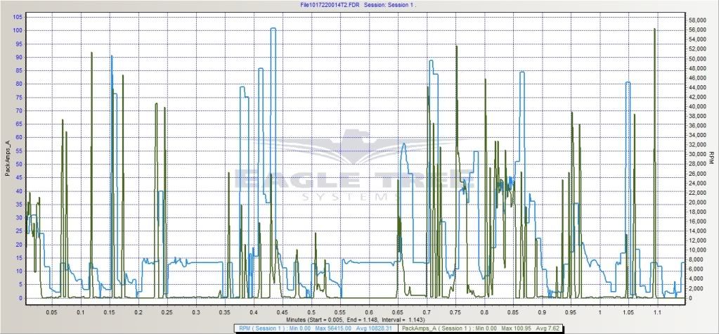

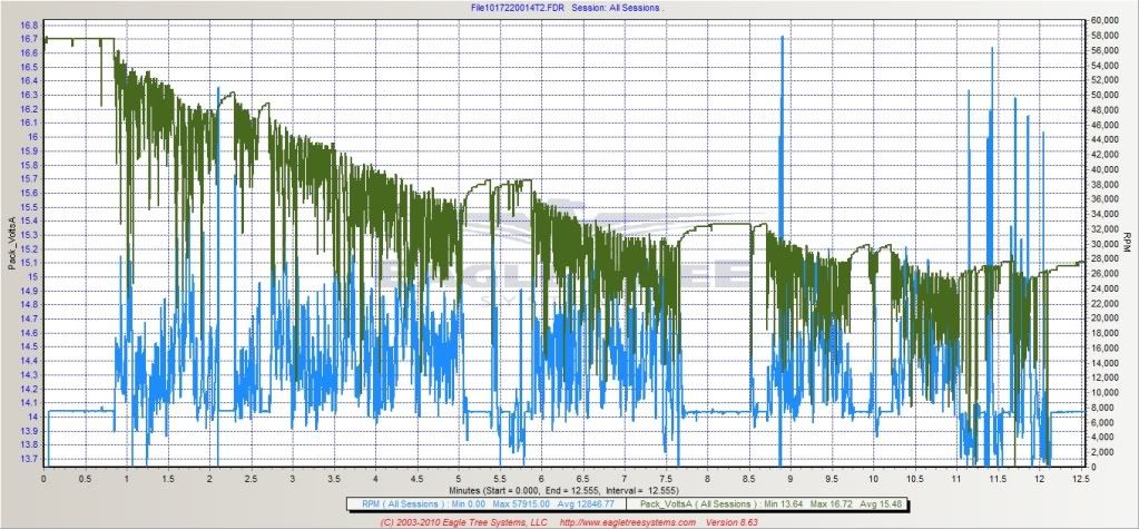

KniteWulfe 10.18.2010 10:35 AM
Here's the worst example of the glitching I have found. I don't know enough about FET switching and how the RPM sensor works to know if it really indicates a problem with the ESC. It might just be what cogging looks like. I got a little more run-time on this one but it still only used about 2300 mAh.
http://i48.photobucket.com/albums/f2...1017wacky1.jpg
http://i48.photobucket.com/albums/f2...7wackyzoom.jpg
http://i48.photobucket.com/albums/f2...wackyzoomA.jpg
