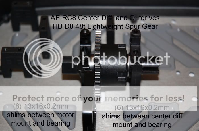

Btw simplechamp , the kyoshio spur gear wont fit the ve8 , the only one that fits there is the ve8 50t one ... but , Harley @ HHH industries did something cool
look at this setup --> http://i856.photobucket.com/albums/a...AEcntrdiff.jpg
and found this --->
http://cgi.ebay.ca/ws/eBayISAPI.dll?...=STRK:MEWAX:IT
only need couple of washers to have the perfect off set and im set ! ...so happyy ! :mdr:
simplechamp 02.17.2011 08:38 PM
OK I see now, I thought the VE8 used the same spurs as D8/D8T.
You should be able to fit any of the "smaller" sized center diffs in there with shims (AE, Mugen, Losi, Xray) but the AE is probably as cheap as any. I do the same thing with the shims to put the Slipperential in my Jammin.
bdebde 02.17.2011 10:32 PM
I tried the AE diff in my Ve8, but it took way more shims than I was comfortable with. I ended up using the 46t plastic spur from a Nexx8.
The Overclocker 02.17.2011 11:48 PM
nah im not worried , ones the top plastic part is bolted down, then its like a box , wont move anywhere
