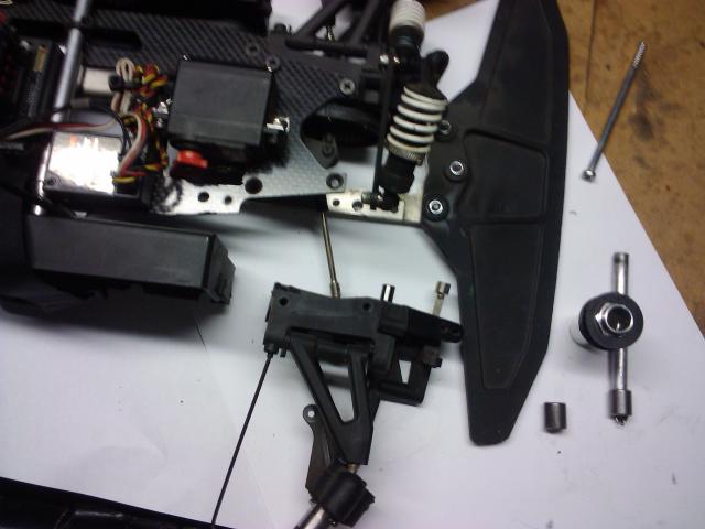

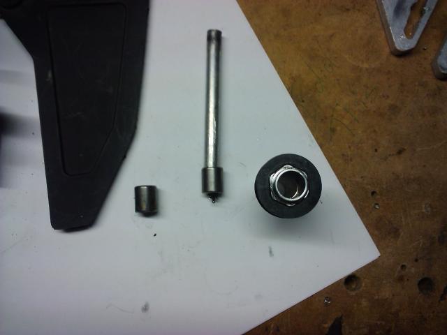

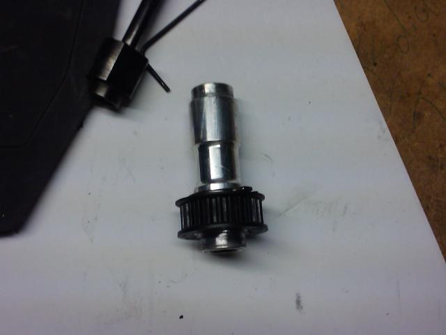

The bearing size is 10x6x12mm for these cars i looked for a while for a bushing this size with no luck and then i was forced to make them but now i have options so tomorrow ill have some bushings made. I will be thread locking the bushings then drilling then tapping and ending with a grub to lock the wheels.
