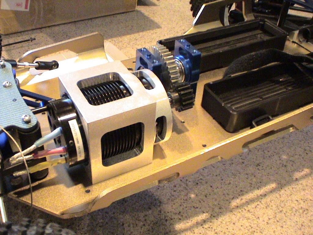

How is the motor/center diff positioning looking?
If it is like your 1/8 set up, then I would guess one battery tray parallel to the motor on the opposite side of the chassis. The other battery tray in the back where the gas tank used to sit (perpendicular to the motor).
I will be using 8S via two packs of 4S, so two battery trays would be great. It will also help with the weight distribution.
Thank you for the love for our MCDs. :smile:

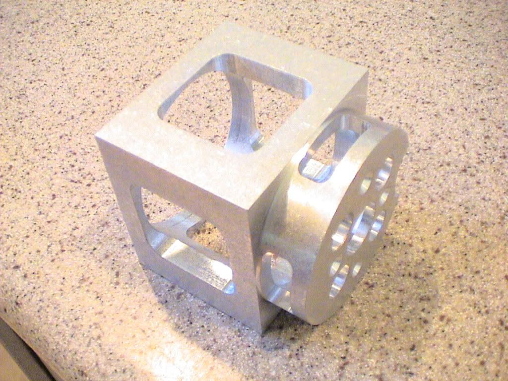

I think this is the best motor mount ever made, i'm biased of course:lol: http://i578.photobucket.com/albums/s...a/DSC01337.jpg http://i578.photobucket.com/albums/s...a/DSC01348.jpg
Were did that motor mount come from and how can I get one?
nitrostarter 04.25.2012 02:29 PM
That mount is similar to those offered by Tekno. They are intended to mount a motor where a nitro motor was as the mounting holes are the same as a nitro motor.
Big House 04.25.2012 03:41 PM
I get that...I was talking about the one shown here....is that one on the market anywhere. Currently the tekno only goes up to 42 mm. I would like one to fit a castle 1717.
