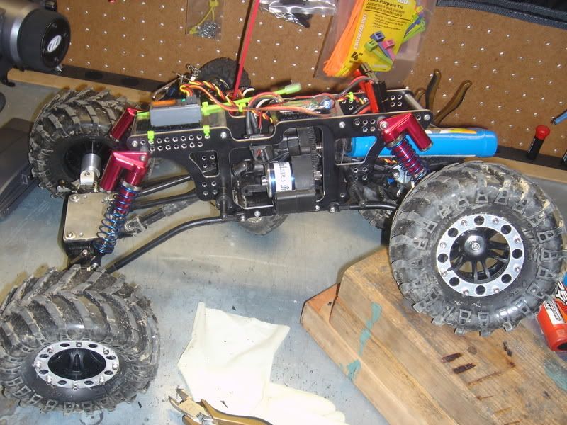

I run the mamba with an outrunner...
Regarding the video...you gotta love the brushless chirping.
http://i139.photobucket.com/albums/q...ems/RR2003.jpg
http://i139.photobucket.com/albums/q...ems/RR2004.jpg

rckcrwlr 01.24.2007 10:03 PM
Originally Posted by sven
sjcrss:
Battery placement really depends on what you plan to do with the crawler. If you plan to do a good bit of vertical climbs, then the forward position is better than the rear. But putting the battery too far forward will negatively affect how well you can drive down a rock.
rckcrwlr:
Nice SW2, the brushless does sound really cool.
I second that one. My rig is set up with 60/40 Delrin High Clearance Links. I have 2 oz of BB's in the front and a stick pack on the front links. I can climb anything vertical. The problem is when going back down. The Ars end goes over the top. I have added 4 oz on lead on the back upper link mount to balance it out. Have not been able to try it out but if it doesn't work then the battery will go back there.
Thanks for the compliment.

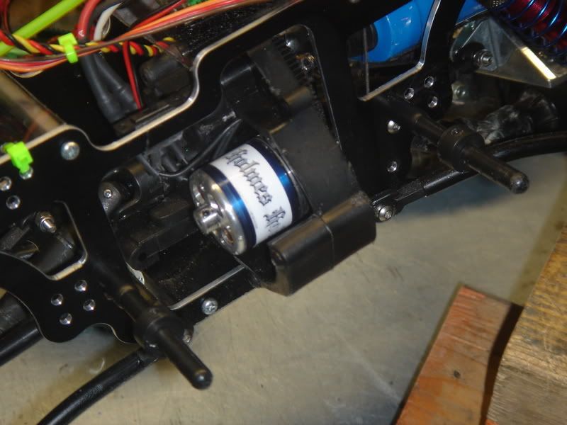

GorillaMaxx360 01.24.2007 11:17 PM
nice pics of the under side how do you like the outrunner motor.
sjcrss 01.24.2007 11:18 PM
I plan on running 7-8 cells on the xl-5 since it is rated for up to 8 cells, what if i split the cells ( 4 up front/ 4 in rear) or 4 infront 3 in rear and have the motor facing forward, i plan on doing some vertical climbing as well...I guess I will have to just toy around with it
rckcrwlr 01.24.2007 11:20 PM
Real smooth. Lots of torque with wheel spin when needed. I am running a 12T pinion that gives me a great balance. I had a GRU on it but it was way to slow. I think it was pulling up the asphalt in my driveway with all the torque.

rckcrwlr 01.24.2007 11:26 PM
Originally Posted by GorillaMaxx360
how do these motors compare to other brushless motors like the neus and lehners and will they work with other applicartions like an emaxx and why do not many people have them sorry for the many questions.
Outrunners are more torque than RPM's. They have smooth acceleration and are brushless.

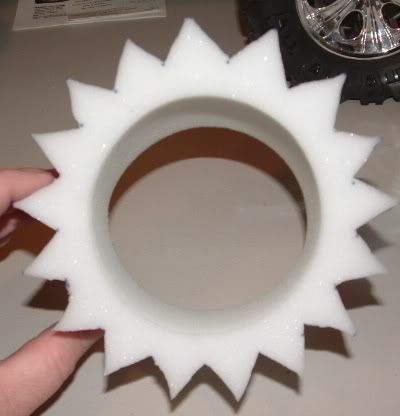

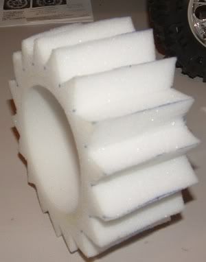

rckcrwlr 01.25.2007 10:17 AM
What tires are you running? If you are running moabs or masher 2K's I would star cut the foams to keep the sidewalls from buckling. You will still get the grip.
http://i139.photobucket.com/albums/q...arpattern2.jpg
http://i139.photobucket.com/albums/q...tarpattern.jpg
sjcrss 01.25.2007 10:44 AM
i'll be running moabs, and how hard is it to cut them in the star pattern, it doesn't look to hard
