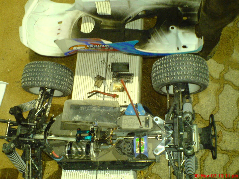

Marty (the guy with the Hyper ST on 4s with Align esc) decided to do some more practice after the race on a 6s pack, not such a good idea.
**Hint** follow the motor wires :lol: Also the body doesn't have black paint on it.

yea boi !!! smoke it hard .. the main reason why i smoked that esc was because it dropped off the back of a berm , and i couldnt see it , i squirted the throttle a few times to see if it would pop over the berm ,but obvious that locked rotor full load amps was what broke the camels back ... 30 min race , wack 6s in within 5 mins , and did another 5 mins running with 6s , im not that surprised i smoked my esc ,, haha .. oh well ,, was only $100 align 100amp

thanks for the pic Pat ! rip align esc!
