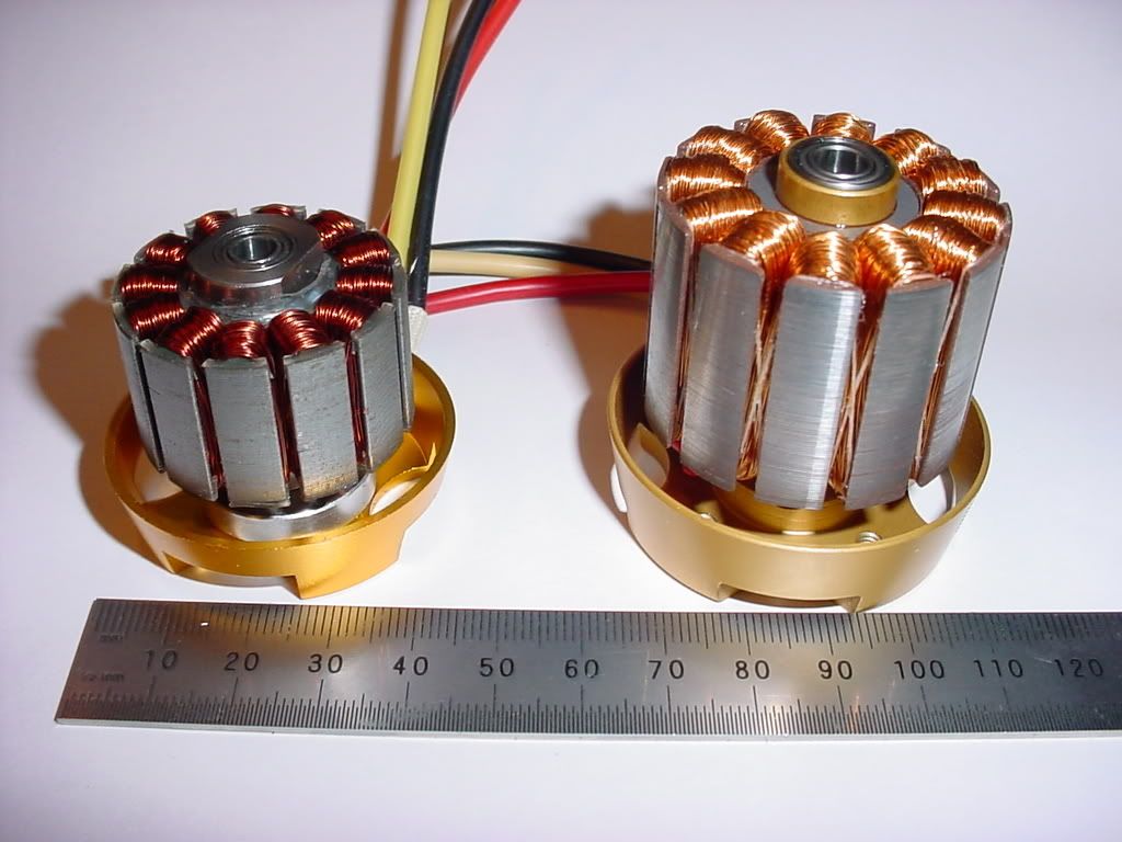

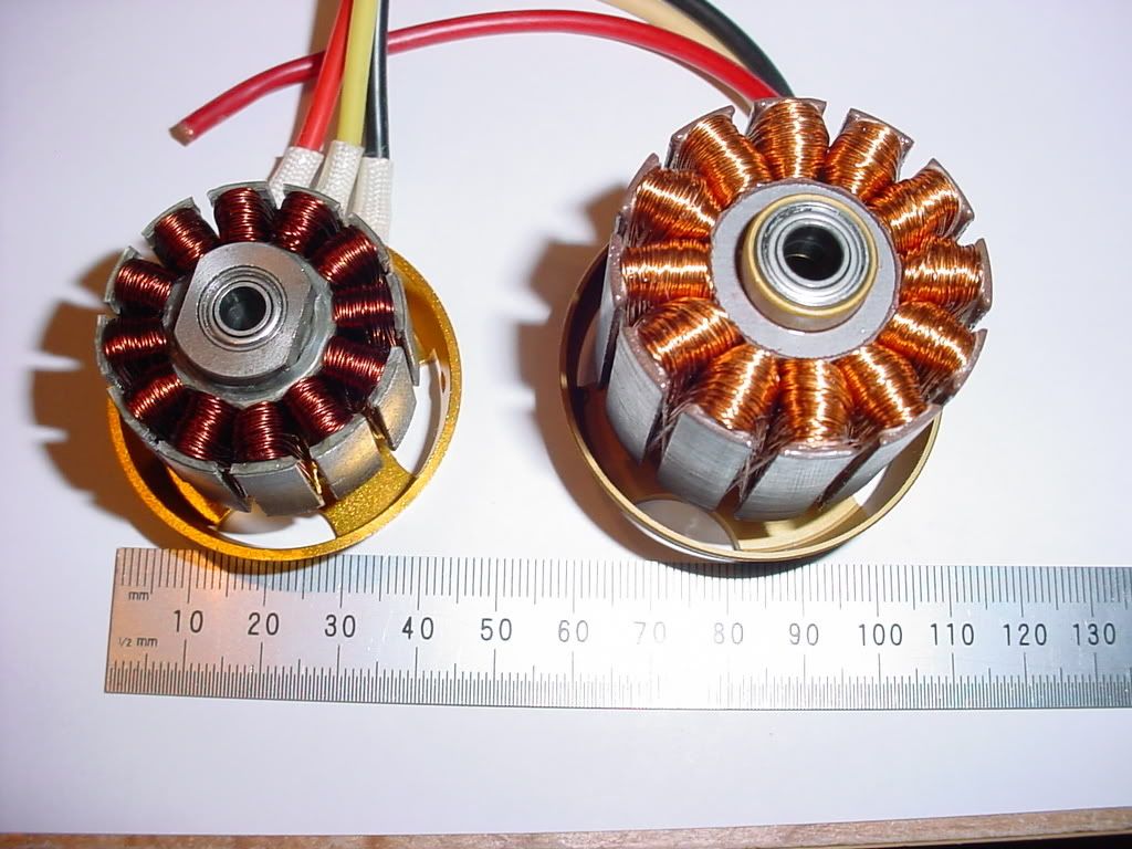

I thought I would show you the difference in the Outrunner used in the E maxx 40mph setup (direct drive to transmission) and the AXI 4130/20 that is going in the Revo. Big Difference!
http://i160.photobucket.com/albums/t...m/DSC06635.jpg
http://i160.photobucket.com/albums/t...m/DSC06636.jpg

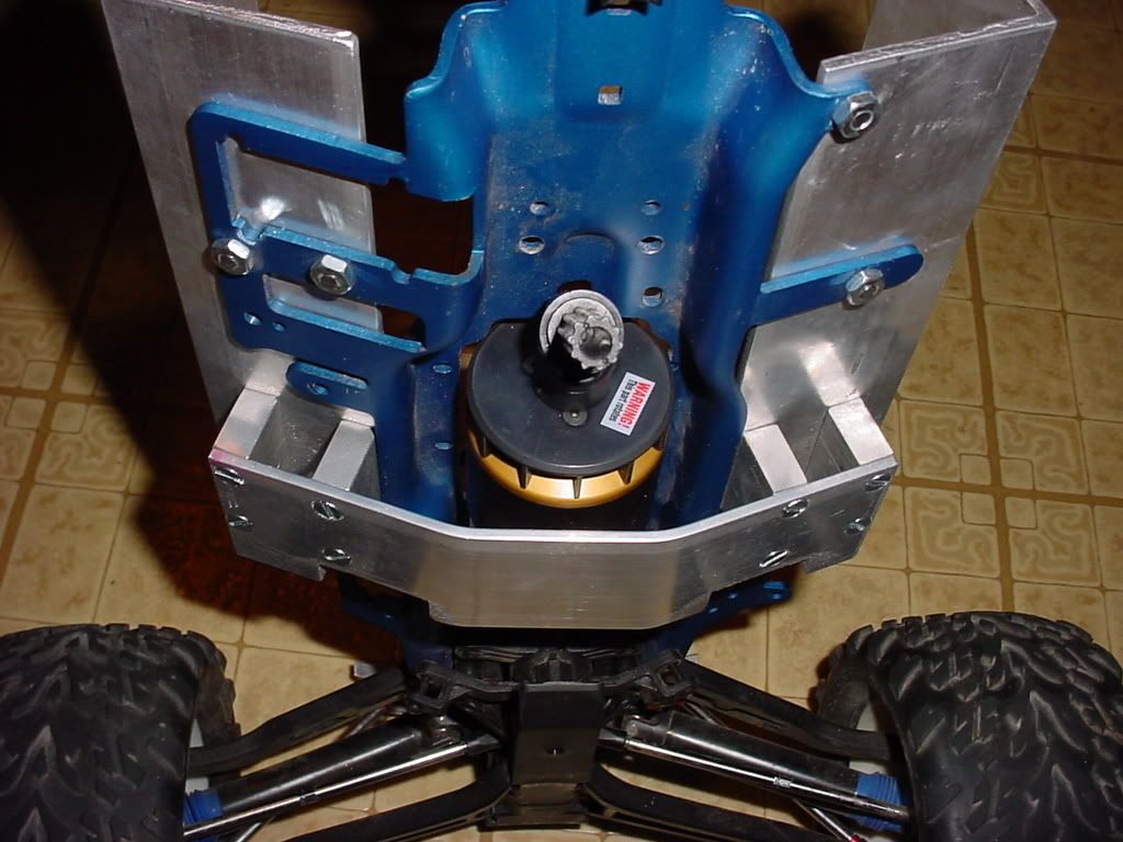

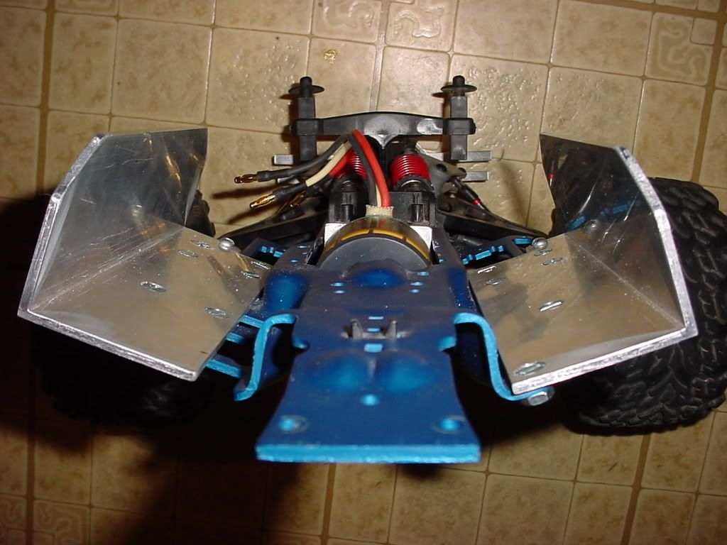

Made some Progress tonight.
Here's a few pics of the progress. Still in it's rough form. I plan to line the lower part of the battery tray with the "loop" side of some velcro. This will cover up the counter sunk screw heads and help protect those precious Lipo's.
http://i160.photobucket.com/albums/t...m/DSC06637.jpg
http://i160.photobucket.com/albums/t...m/DSC06639.jpg
