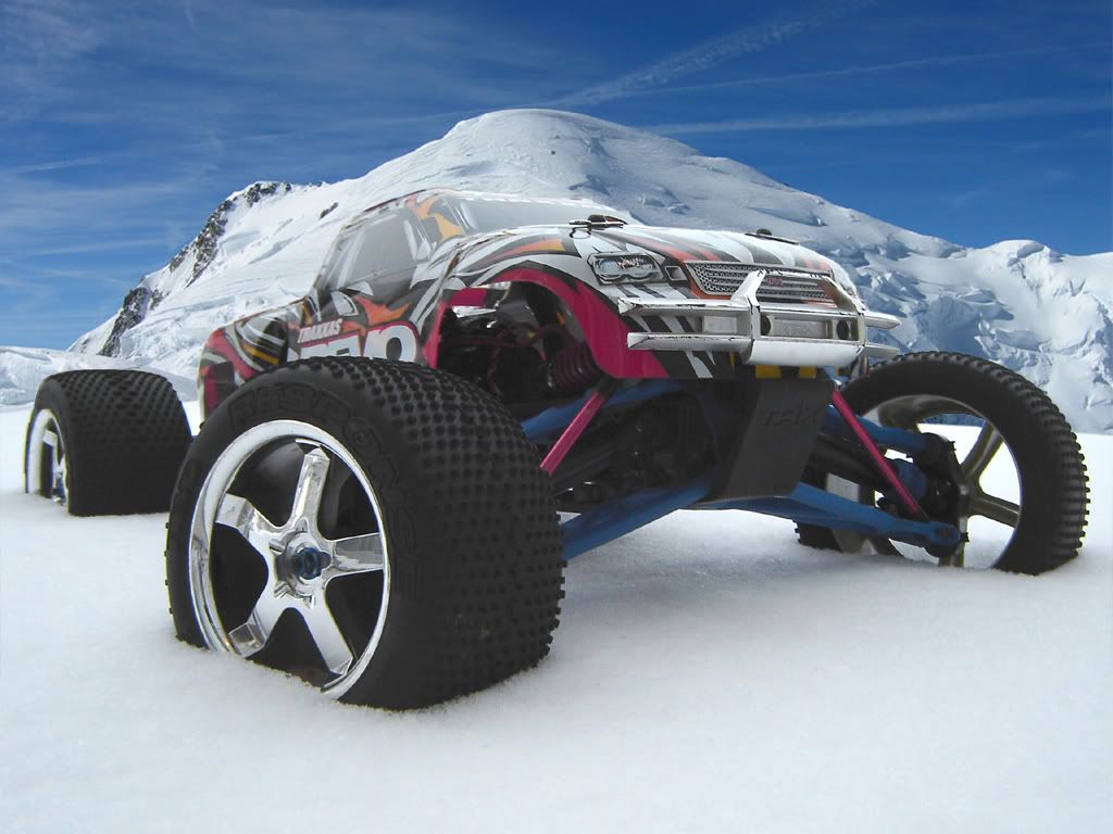

Happened bring my camera along for my bash in the himalayas! :tongue:
http://i248.photobucket.com/albums/g...-snowsmall.jpg
suicideneil 02.07.2008 02:28 PM
Is that real?! Awesome....
