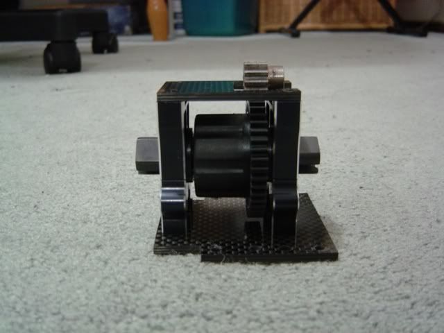

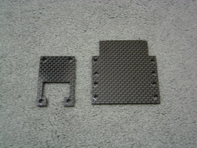

jordan... 05.13.2008 03:51 AM

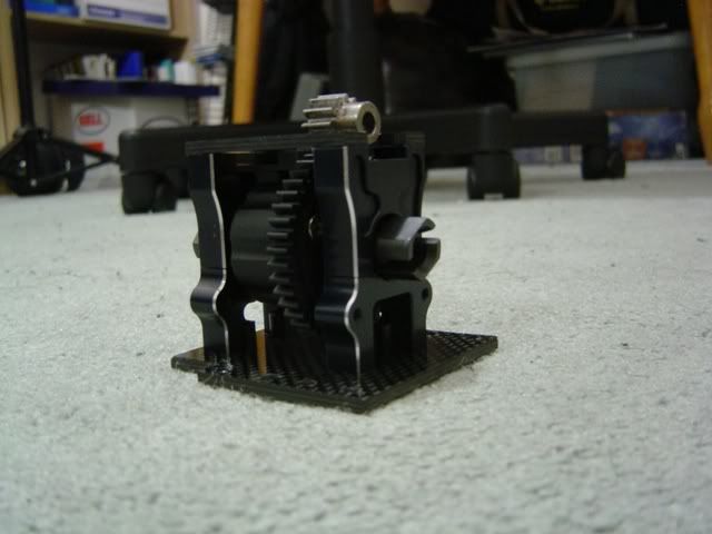

i had to read that a few times to understand it, then i looked at the pics and was like, aaahhhh :lol:
im still going to be using the gmaxx lower plate, i just had it off to fit the CD mount, and didn't get it back on for the pics. It was really only a mock up in the pics, you can see that i only have four screws holding on the plate instead of eight, and theyre all different lengths.
I had to make the CD plate because if i mounted the CD on the 'floor,' (lower gmaxx plate) i wouldn't be able to get clearence between the motor and the upper back plate, if that makes sense... :whistle: also, the 44t kyosho spur fits EXACTLY in between the frame rails, like perfectly, not even half a mill on each side to spare, so i had to raise the CD for clearence there as well.
i think i've answered your question :neutral:, if not, please feel free to clarify. Im open to any suggestions/questions/comments/criticisms, after all, it can only make the truck better.
thanks
jordan

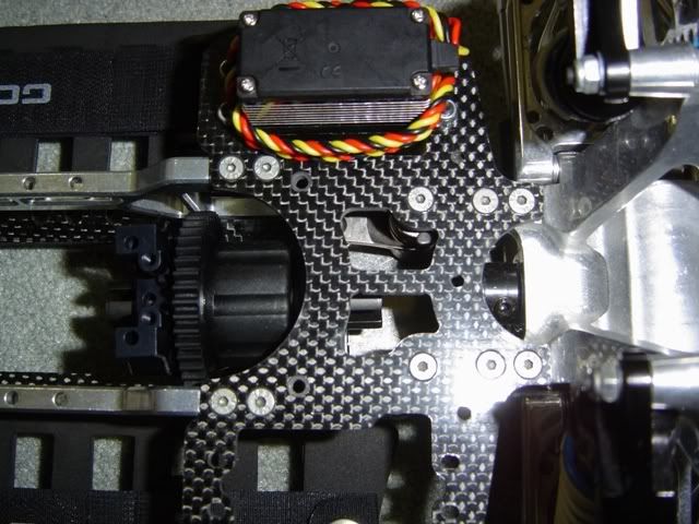

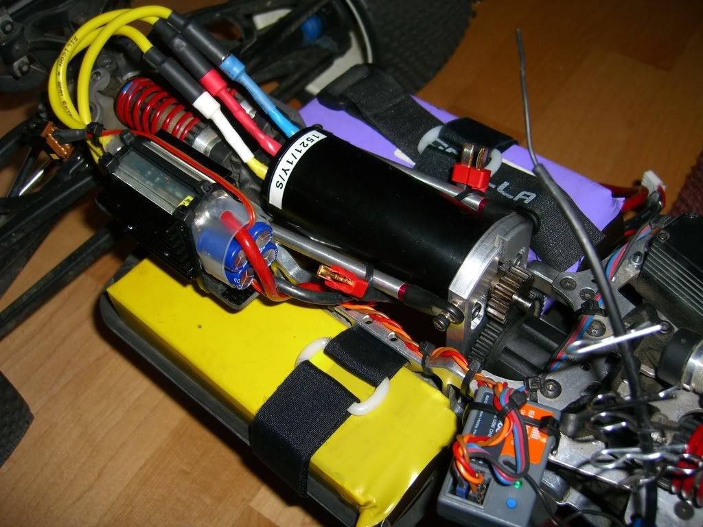

jhautz 05.13.2008 04:04 AM
Couldn't you mount it on the lower deck and just move the whole diff assembly forward?
Like this. This is my G2R Revo with one of Dafs center dif mounts in it. The diff is totally forward and allows the motor to sit low, almost in between the rails of the chassis. With a little creativity you could probably get it even farther forward on a Maxx. With the revo you start running into the shock positions that cause more problems.

Here is an earlier incarnation of it with a 1521 just to show you that a longer motor will fit. I would think that on the maxx you could find another 6mm to fit the 1527 you are planning.

jordan... 05.13.2008 04:25 AM
that is one slick setup jhautz, i love the swaybar braces coming off of the sides of the mount, and I see you've already predicted and rebutted my first question/argument about the size of the motor :lol:
Does daf still produce these mounts?? looking at the design, i might still be able to use the Xray mounts i have, and just make a motor mount to fit the motor.

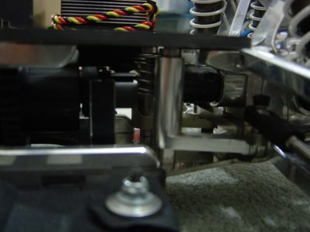

jordan... 05.13.2008 06:10 AM
i've just been playing around with different placements of the CD on the lower deck. Having the diff placed exactly where i see it in the pics, just before the front upper gmaxx plate, the diff hits my servo saver. Maybe the steering assembly on the Revo is a little farther forward than it is on the Maxx??
When i move the CD unit back far enough for the SS to clear, the bottom of the spur hits the lower deck. Maybe Dafni's mounts position the diff a little higher up than standard buggy/truggy CD mounts?
[EDIT] i think i know whats causing the problem. Due to the Revo's suspension setup, the bulkheads are located further away from the chassis than they are on the maxx, thus the steering assembly is also further away. From the third picture down, i can tell that there is a fairly long driveshaft. On the maxx, the dogbone would only be around 2cm :oh: i'll get some pics up shortly
[EDIT 2 :lol:]
http://i212.photobucket.com/albums/c...x/DSC01066.jpg
http://i212.photobucket.com/albums/c...x/DSC01068.jpg
sorry for the crappy pics, my camera doesnt take good close ups. Please let me know if im doing something wrong here, i would still love to mount the motor low down in the chassis.
thanks
jordan
BL_RV0 05.13.2008 08:43 AM
If your front dogbone is that short, it should in theory be bulletproof because there's not much that can bend or break. About how long would your rear dogbone have to be?
jordan... 05.13.2008 08:50 AM
that equals a rear dogbone length of 7 inches :gasp:
if you look at the first pic, you can see the centre diff cup is past the SS arm though, so i would have to mount the unit further back, which means the motor might not fit. Maybe if someone hadn't gone overboard on the motor, then this setup would be way easier to install :whistle: :oops:
what can i say, i NEED power :diablo:
BL_RV0 05.13.2008 08:52 AM
Yeah, I would too if I spent (I'm guessing) $3500 on a truck. The rear dogbone would have to be pretty dang fat to not snap, though.

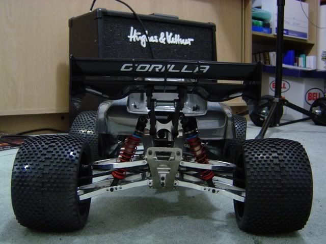

A quick update nothing major, still not heard anything about the motor :grrrrrr: I managed to fashion a top plate for the centre differential unit out of the carbon fibre i have today, and i think it looks ok (a little rough around the edges). Hopefully it'll provide enough clearance when its all fully together.

Also put a Gorillamaxx sticker on the back of the wing which i think looks pretty funky, also thought id just throw in a full picture of the truck with the different headlights and vinyl'd wing.

http://i212.photobucket.com/albums/c...x/DSC01130.jpg
I've ordered a XB808 centre diff, because it comes with a 42t spur, so when that gets here i'll get to work on mounting the CD and motor on the truck. I'm working on some tricks with the centre diff position at the moment, and i'll post a full 'how to' when everythings done.
Enjoy!!!!
jordan

The truck is Awesome but I gotta say...this motor is HUGE!!! :surprised:
JERRY2KONE 07.03.2008 06:32 AM
crappppppp
HOLY CRAPP BATMAN. Just looking at that thing is incredible. You could push quite a bit of weight with that monster. I shutter to think how hard it will be to control such power in that truck. With the right setup you should be able to achieve some pretty high speeds with that thing. If you do go for speed you are going to have to really think about your entire setup, like taping your tires and using beadlocks rims to keep them from flying apart. Your drivetrain should hoold up nicely. WOW that thing is amazing. Good luck with that Jordon.
jordan... 07.03.2008 08:36 AM
Thanks alot guys, i can't wait to get this installed and ready to go.
Thanks for the tips Jerry, i've already got the tyres taped with multiple layers of duct tape :mdr:, hopefully the superglue holds up :oh: At the moment, im thinking the most important thing to running this motor will be the ESC setttings just right, but we'll have to see i guess...
drkros3 07.03.2008 11:08 AM
holy crap that is one big motor.
