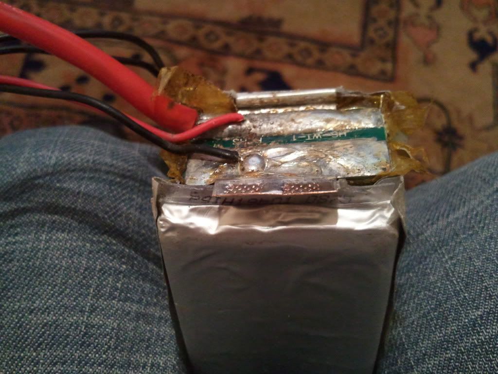

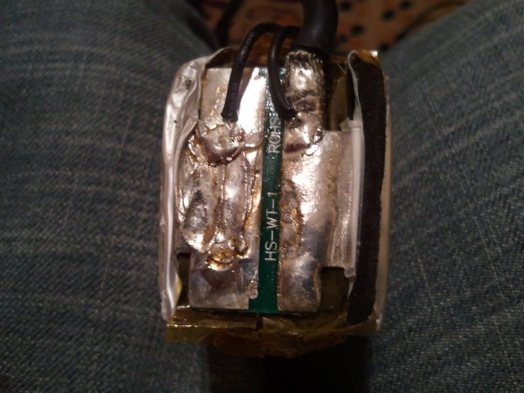

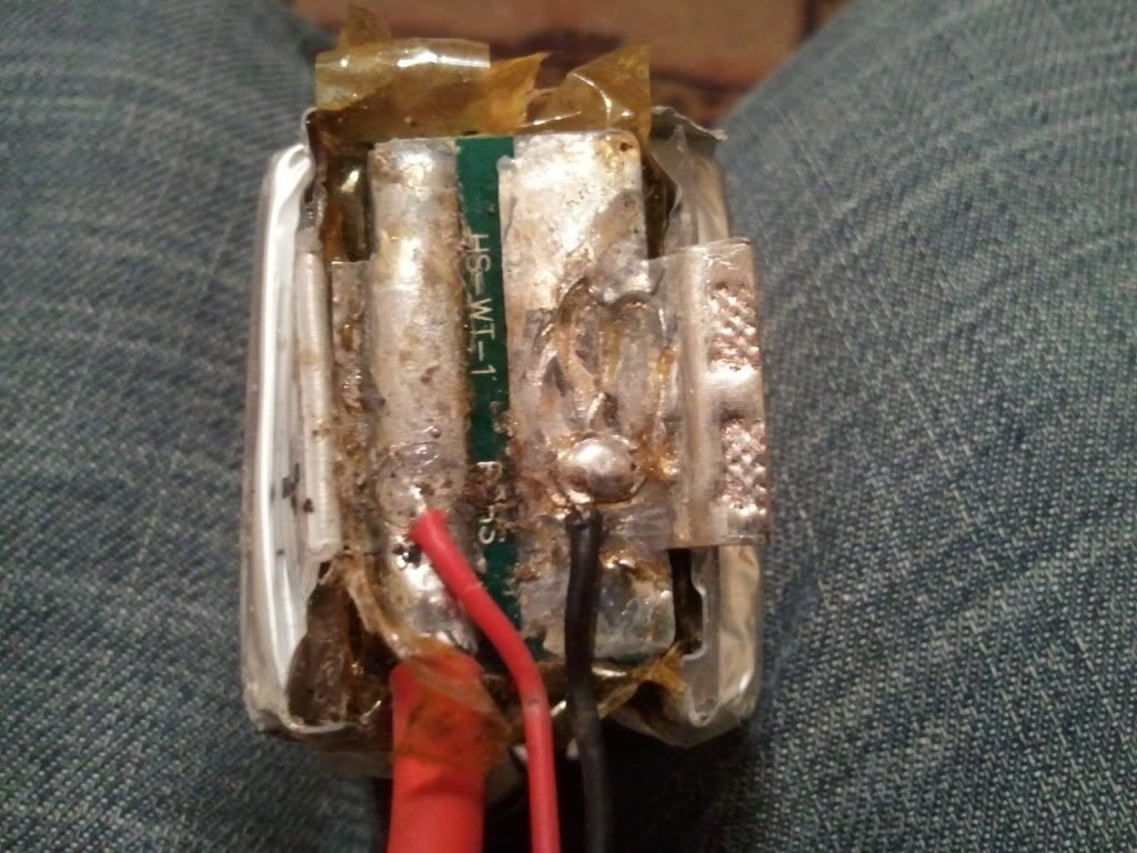

i have taken the heat shrink off but i have wires coming out at either end... here are some pictures close up of either side. If you can spot something that i am completely missing, then please let me know and advice on how to sort the problem...
Thanks

In the picture below... is this metal part meant to be sticking out??? or should it be tucked in somewhere like the rest?

I hope these pictures help... As you can see there are positive and negative wires at either end and balance leeds connecting... i cannot see any cracks in the solder or obvious breaks. Is the flap that seems to be sticking out possibly the problem??
Thank you

Hmm, it all looks okay more or less. The sticky out flap shouldnt be an issue, though Im wondering if the join it solid or not- just looks like its stamped together ( all the little dimples ). Im also looking at the other join on that end and wondering if that is solid too- might be worth doing a continuity test with the multimeter to find where the break is, though if its only intermittent it could be tricky...

THat picture, left side, looks like a crack in the solder, hard to tell. Reflow those puppies- they look ghettooo(means alot coming from a black guy):lol:
that metal peice is where the cell's aluminum tab is attached to the copper tab for soldering
Tuck it up out of the way
