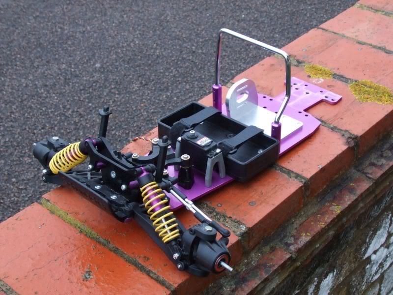

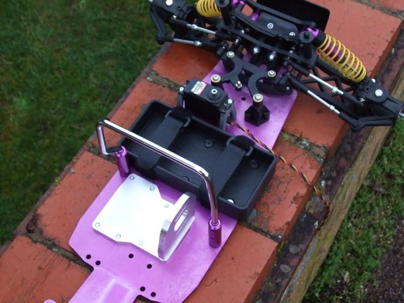

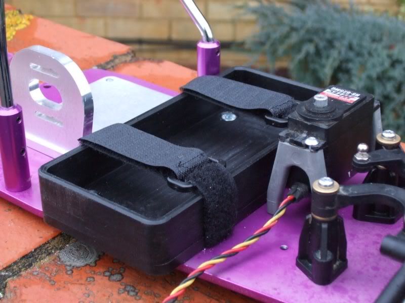

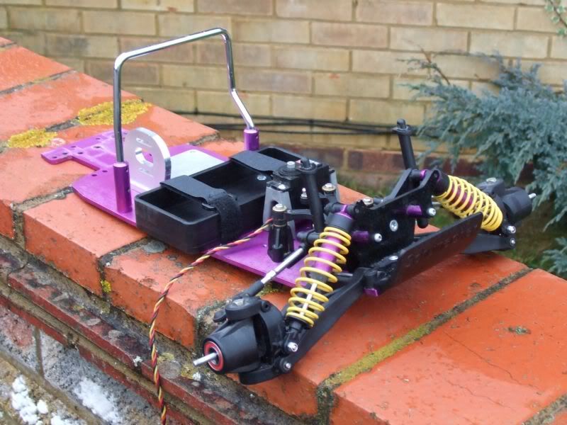

I'm really sorry for the lack of updates. Reason for this is that, well...there just hasn't been anything to report. Money's been kinda tight lately, so this really has been *inching* along, but I finally have something worth reporting (yay!): the battery tray is here, finished and fitted:
http://img.photobucket.com/albums/v6...r/DSCF0215.jpg
http://img.photobucket.com/albums/v6...r/DSCF0218.jpg
http://img.photobucket.com/albums/v6...r/DSCF0219.jpg
http://img.photobucket.com/albums/v6...r/DSCF0217.jpg
http://img.photobucket.com/albums/v6...r/DSCF0216.jpg

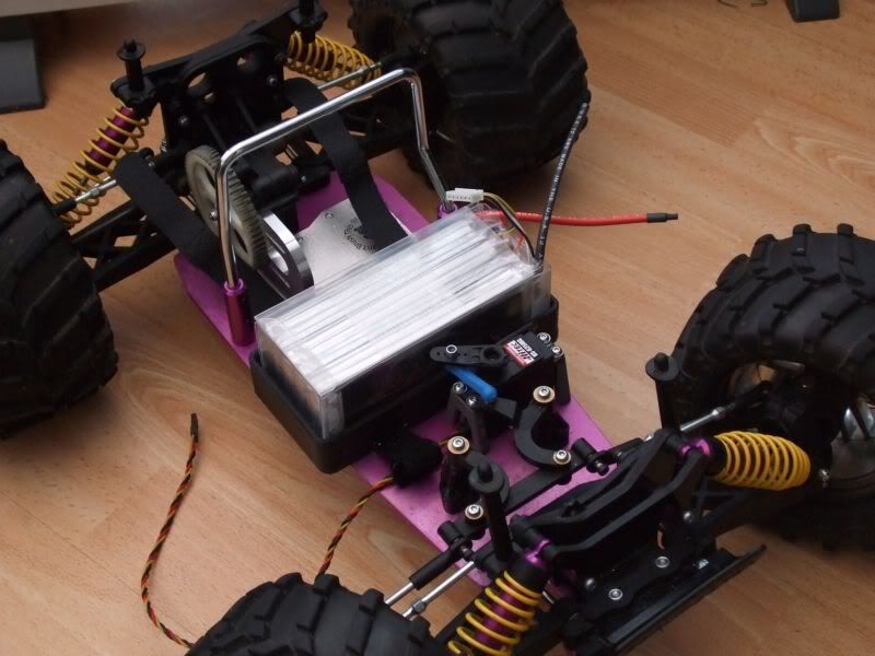

Nothing groundbreaking, I know, but thought I'd take pics nevertheless.:na: It's a custom RC-M tray, with a completely flat bottom (except for the strap slots), unlike the usual stepped kind. It's dimensioned to fit the 5S Elite 5000mah 35C LiPo I now have on its way, and is achored to the chassis by means of six M4 countersunk screws...so it shouldn't be moving any time soon.
Only thing is that I don't think the straps will be long enough to wrap around the battery, but I'll cross that bridge when it comes. I also mocked up the steering servo for the pics. It's not fitted yet because I need to shorten the T-Maxx throttle servo mounts it's using, so the servo sits lower, but that's where it'll be. I also have an aluminium ESC plate I'm knocking up to sit behind the motor, so everything should fit snugly.

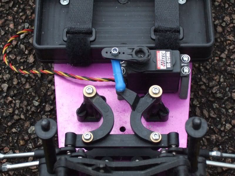

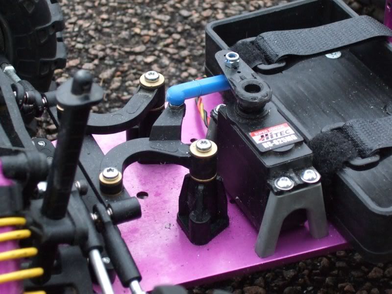

Only a small development, but I finally got around to sorting out the steering servo setup. The stock location for the servo is halfway up the chassis, which isn't any good for this conversion, so I've had to reposition it right up at the front with some T-Maxx throttle servo mounts which I've shortened:
http://img.photobucket.com/albums/v6...r/DSCF0225.jpg
http://img.photobucket.com/albums/v6...r/DSCF0226.jpg

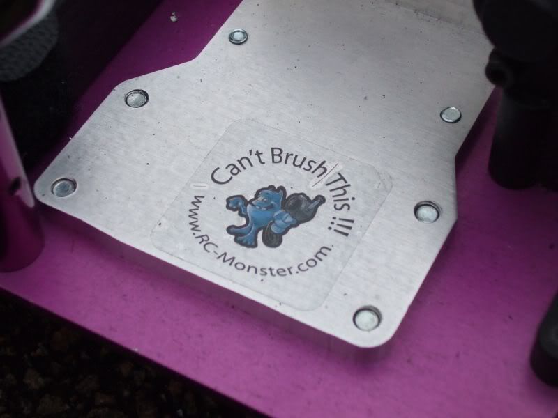

...and some RC-Monster love lol. Had to use that sticker for something!:yes:
http://img.photobucket.com/albums/v6...r/DSCF0229.jpg
For the time being it's set up without a servo saver, as I just don't have one that will fit. The short blue link in the photos though is a pair of RPM ball ends (one shortened) with threaded rod, and this has some flex in. Hopefully if (sorry; WHEN) I crash, that'll give way instead of making the servo's innards into iron filings.:lol: Not that it matters, as itll only be running a cheapo TowerPro until I can afford a decent servo.

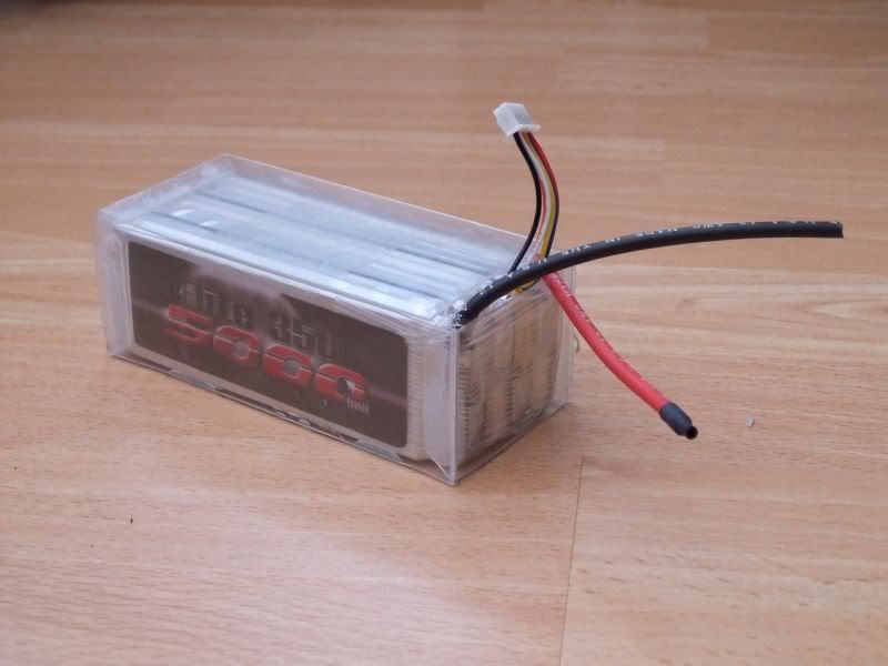

:lol:Just kidding of course. This is the beastie. I got to work straight away, and made up a lexan hardcase for it to protect it from sticks and rocks during the bashing I have planned:
http://img.photobucket.com/albums/v6...r/DSCF0231.jpg
http://img.photobucket.com/albums/v6...r/DSCF0232.jpg
http://img.photobucket.com/albums/v6...r/DSCF0233.jpg
Unfortunately, the battery straps that came with the tray aren't quite long enough to hold it lol, so I'll have to sort something out there. Still...I'm just happy it fits the tray like it should. Just gotta stick some foam in there now, to pad it out. :)

If the straps are to short you might try the losi straps. They are a bit longer than the RCM straps. Mike caries them. http://www.rc-monster.com/proddetail...osb4463&cat=18
Everything looks great. Cool project. :yes:

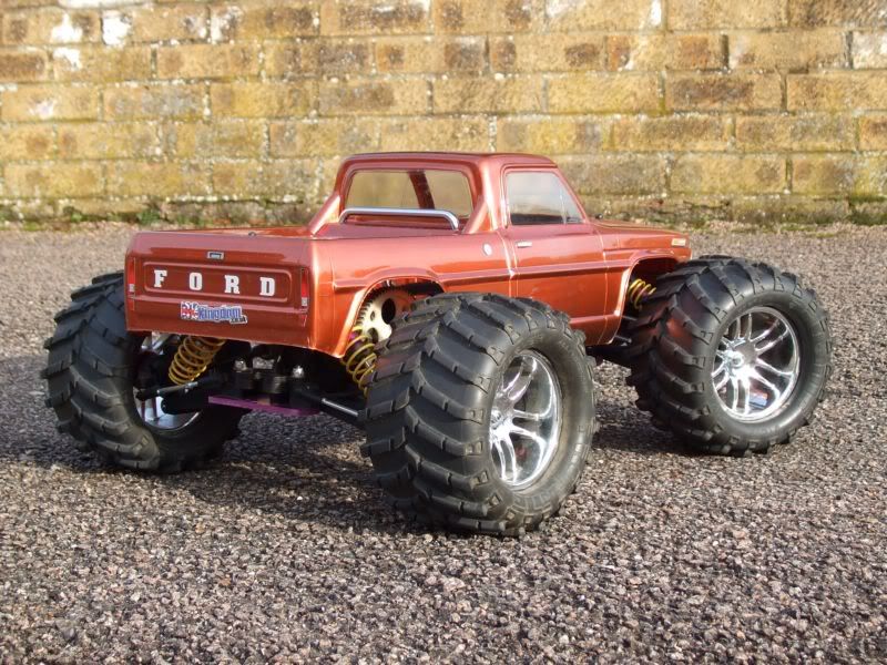

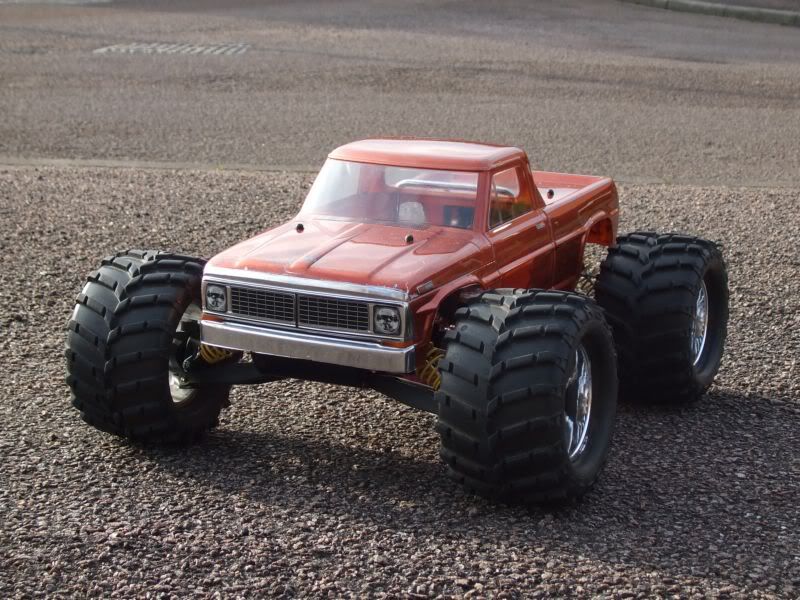

...the worst paint job in all of history:
http://img.photobucket.com/albums/v6...r/DSCF0240.jpg
http://img.photobucket.com/albums/v6...r/DSCF0241.jpg
http://img.photobucket.com/albums/v6...r/DSCF0242.jpg
http://img.photobucket.com/albums/v6...r/DSCF0244.jpg
http://img.photobucket.com/albums/v6...r/DSCF0243.jpg

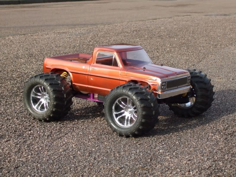

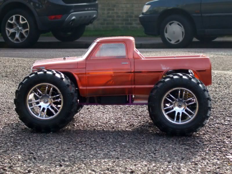

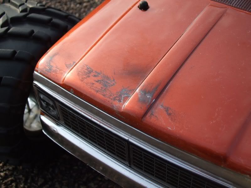

It's a long story of how it came to be that bad, but suffice it to say that me, and paint, don't get along very well. Originally it was going to be black fading into the Tamiya Copper colour you see there, but the supplier sent me blue instead of black, so I thought I'd just try solid copper with a chrome grille. Big mistake.
The masking bled paint everywhere, the masking tape itself left a load of gunky residue (hence the mess on the front of the bonnet), and the rest of the paint came out patchy due to it being so cold in my garage I think. Still...I think it kinda looks like a bit of a rustbucket lol (the mess up front kinda looks like bare metal when you see it in person).
It's only going to get beaten to death anyway, so doesn't really matter I guess...:whistle:
