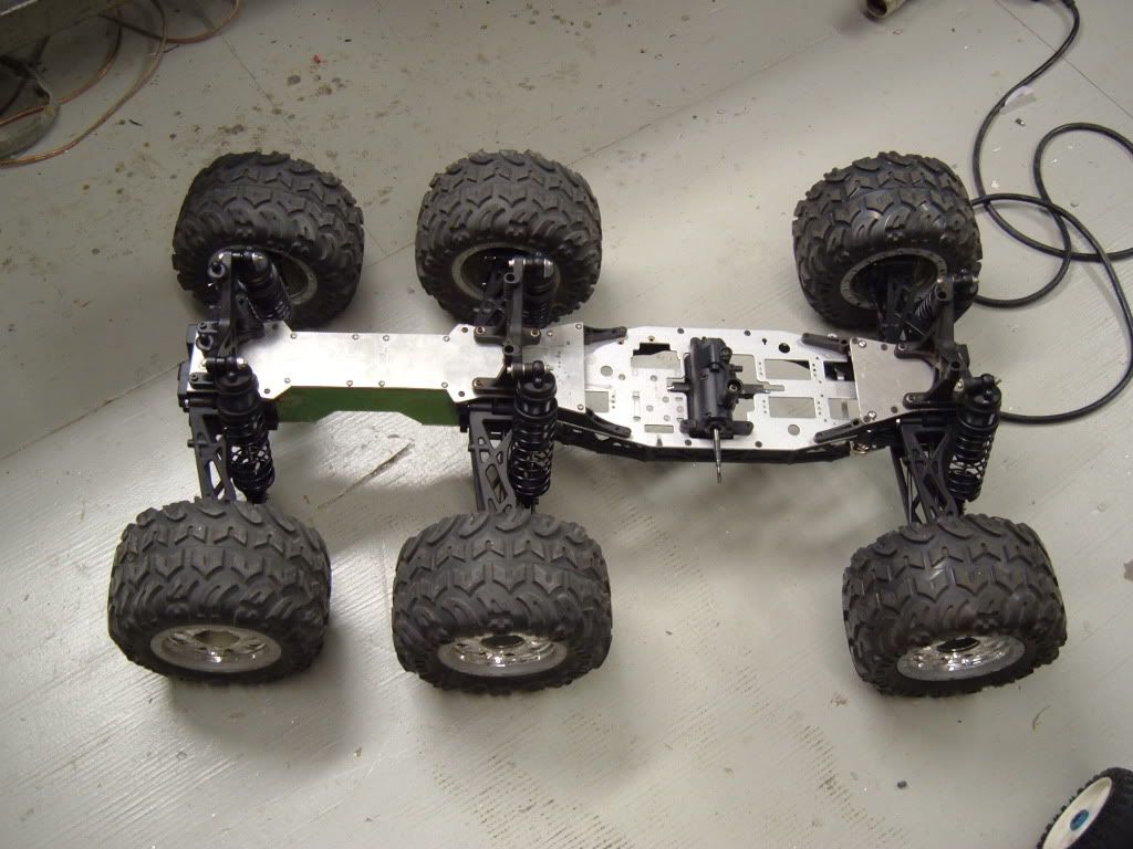

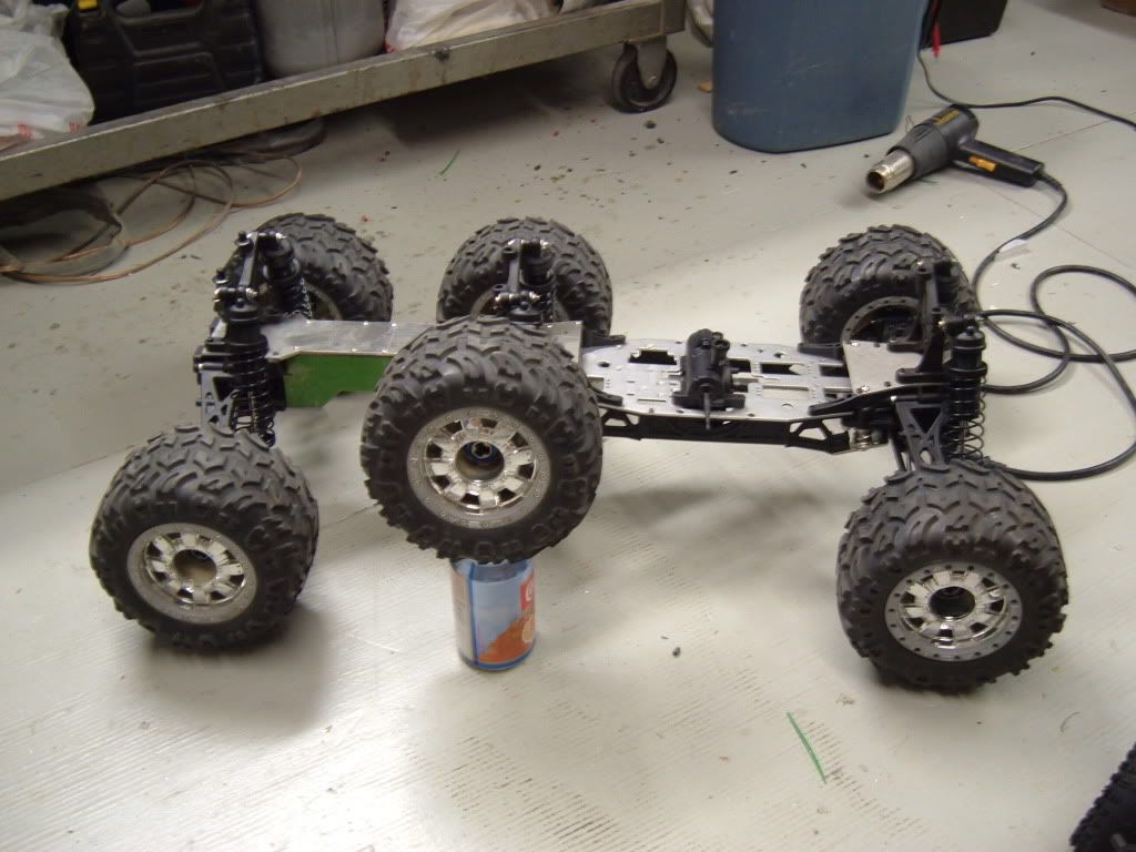

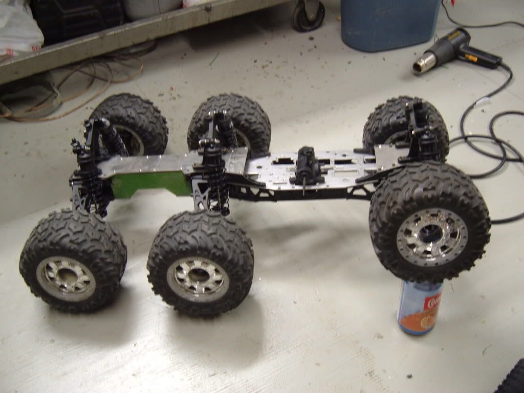

So I got some more work done on the truck tonight.
Added full lst2 front suspension, 6 aftershock shocks and modded 2 more Cen 23mm hexes to fit the front axles. Mounted up the last 2 tires and set it on the ground to eyeball it. Completely blown away by how well it articulates. That is a std size 12oz al can under it in the pics. I have a feeling I will be finishing this up pretty soon!

brushlessboy16 06.10.2009 05:50 AM
thats sexy!
If only you could find a trans with a really low first gear to crawl, and a decent speed gear for everything else.
Hmmm... Revo 6x6 ;)
lincpimp 06.10.2009 10:59 AM
Originally Posted by brushlessboy16 (Post 294451)
thats sexy!
Hmmm... Revo 6x6 ;)
I have that, the stock lst tranny has a manually selectable high and low gear. Low is 4:1 and high is 2.something:1. So if I gear for 35mph or so in high I can switch down to low for about half of that speed and bunch more torque.
