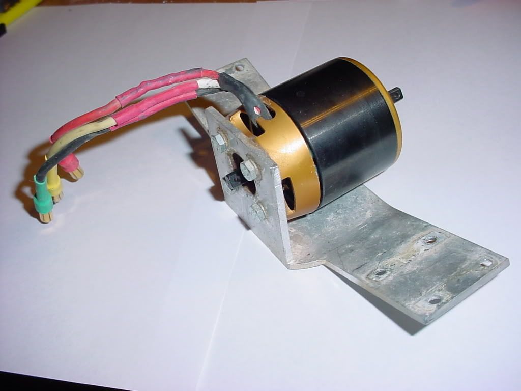

sikeston34m 10.07.2009 08:10 PM
Originally Posted by zeropointbug (Post 325774)
Hey Sike I just checked out that century outrunner... YIKES is what I have to say as well. I can't see it holding 30krpm though, that just seems like too much, and it doesn't state how many poles there are.
There are several places that comfirm it being 8 pole.
Here's one source that you may find useful with other things: :yes:
http://www.progressiverc.com/Brushless_Motor.html
It has 10 Magnets inside the rotating endbell instead of the conventional 14 as with a 12 pole outrunner. So it's a different "8 pole" wind also.
sikeston34m 10.07.2009 08:26 PM
Originally Posted by redshift (Post 325775)
Yeah, I got the 2 ideas going at once, sorry. And I know the outrunners don't have the nut for that.... yet.
But it seems like if it was to be tried it would work better on a 1/5. I don't think we're quite there yet. I also am tossing around doing either a single outrunner solid center like sike's, or a twin inline setup.
Make me an offer via pm if you're interested. I like to trade as I am in the market for several items of interest.
The motor shown is my own custom wind. If you prefer a factory wind in the 4120 series or the 4130 series, I'm sure I have that on hand as well. In fact, I believe I still have all the custom mounting hardware for the Direct Drive to Diff Revo Conversion.
This offer isn't exclusive to Redshift, but he has first dibs. Must be a reputable RCM Member.
Sorry ZPB, not trying to highjack your thread. I thought you might have interest in this as well. Since it is custom stuff that pertains to what you're doing.
PM only on this please.
http://i160.photobucket.com/albums/t...m/DSC07768.jpg
