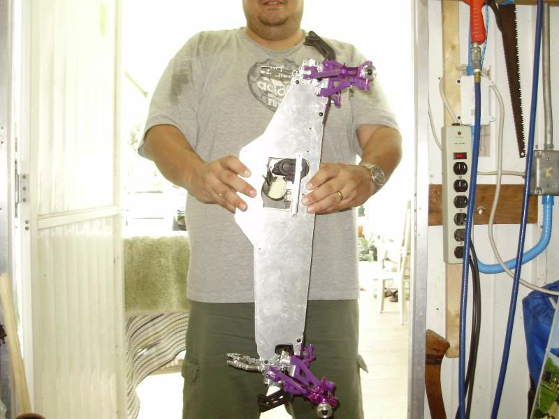

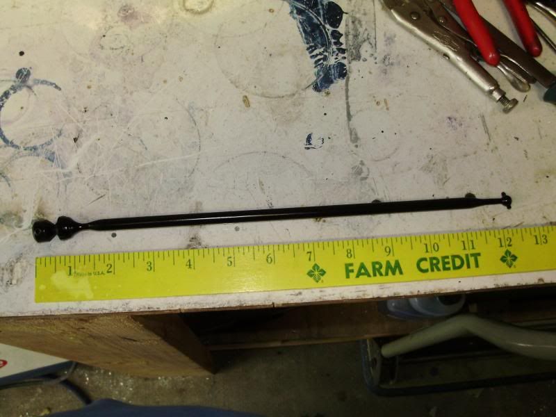

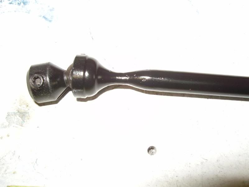

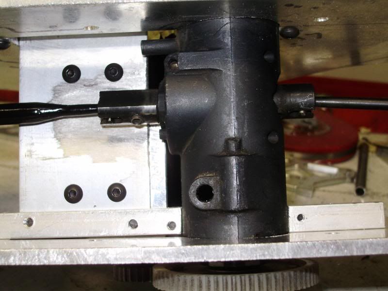

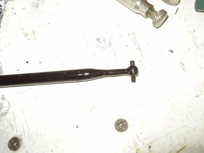

I was able to install the battery tray, ESC/RX Tray and make the center CVD's today. The rear CVD was a cinch, I had a MIP LST gen 1 center CVd and it was a perfect fit !!! The front one I had to make from the other MIP axle (see pic)
http://i88.photobucket.com/albums/k1...E/P8280002.jpg
http://i88.photobucket.com/albums/k1...E/P8280004.jpg
http://i88.photobucket.com/albums/k1...E/P8280001.jpg
Heres the front and rear assemblys installed

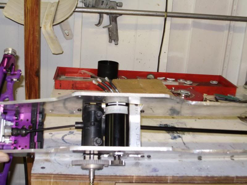

And a pic for scale
http://i88.photobucket.com/albums/k1...E/P8280005.jpg

Sorry to dissapoint but thats as low as it can go with the TVPs and have some metal underneath it, I'd rather of had it lower myself but look at the last pic above of it sideways . The trans case is 1/2" from the bottom, I wanted plenty of material underneath it for strenth. I believe the over all COG is gonne be roughly the same as a Flux maybe a bit lower ?

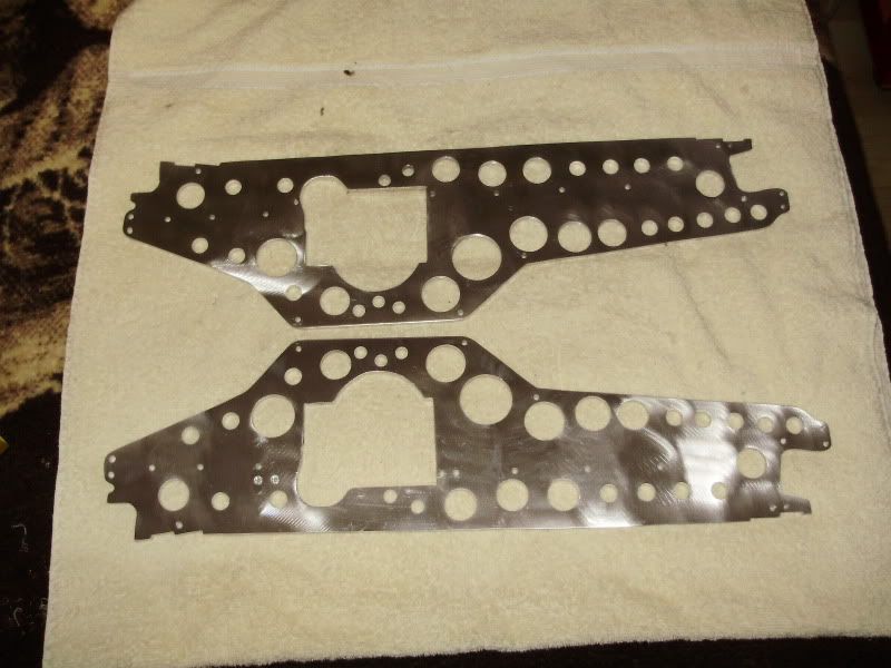

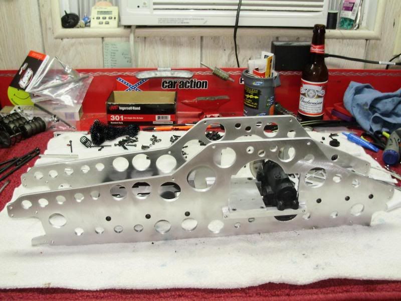

Chassis is finished ! My Gaaa, what a PITA !
I've made numerous T-Emaxx,1/8 scale flat chassis and several custom spin offs of my own but this was by far the worst yet. The biggest problem was I used to thick of material (3/16"), it made the job a lot harder than it needed to be.
Tools used were a Jig saw, 3" angle grinder, metal hole saw kit, cordless drill & bits and hand files.
Final weight is ..........................1lb 13.7ozs CHUNKY

Ouch! You cut all those holes with a jig saw?
Looks good tho! I take it that you are pretty set on the location of everything?
Bondonutz 08.29.2010 03:13 PM
No, I have a metal hole saw kit.
Yup, everything has it's place. Batterys in front, ESC in the rear & RX ?
Everything seemed pretty balanced in mock up, I'm content w/it anyway. Hopefully I didn't overlook nothing.

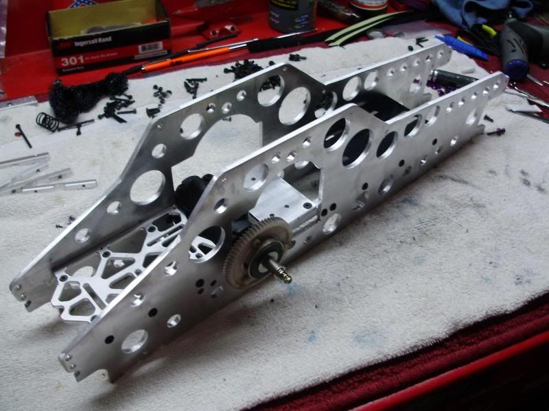

I didn't make the progress I expected I would today considering having the day to myself but due to a few unforseeables I did mange a bit.
I had to spend a lot of time getting the steering where it needed to be, I had wanted to order a aluminum drag link but I guess I forgot, the stock plastic peice of shiz was dragging big time on the FLM bulkhead. I tried using a few different links I had in the "treasure drawer" but nothing worked so I had to dremeled the stocker. I did however order a Aluminum link via Fleabay today, hope the farkin thing fits ?

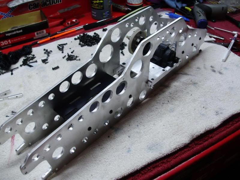

Trans is in, as well as battery & ESC tray.
http://i88.photobucket.com/albums/k1...E/P8300010.jpg

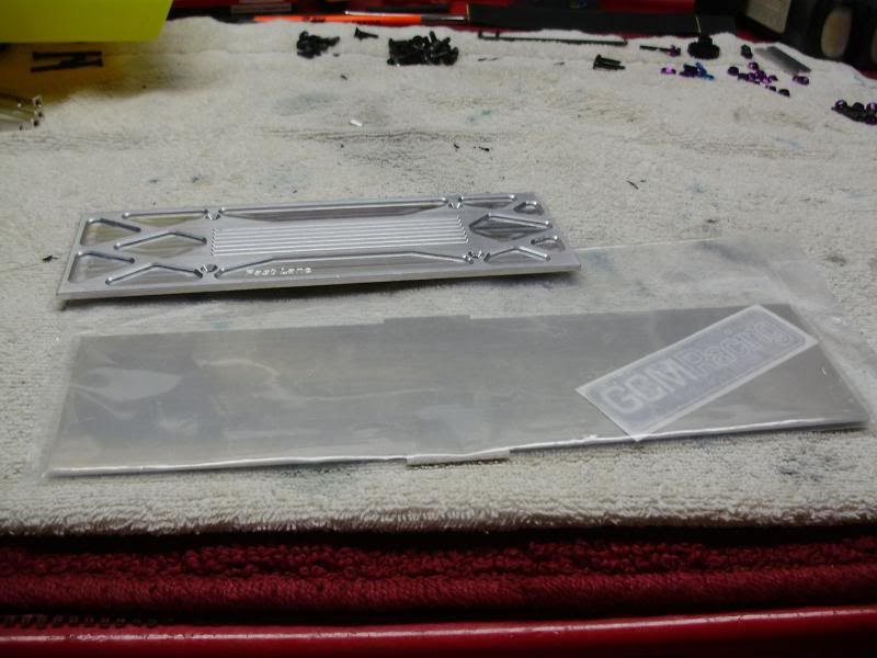

I think I can manage nearly a full lenth skid plate out of these pieces,Bonus ...

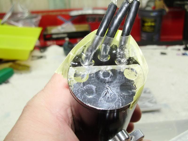

Sealing up the NEU 1521 1.5Y. Aluminum tape and ShooGoo
http://i88.photobucket.com/albums/k1...E/P8300020.jpg
redshift 08.30.2010 11:02 PM
Looks unholy... except it's really holey!
I wonder if 3/16" will do it... :whistle:
Yikes, I would not want to be hit by that!
Coming along well :yes:
