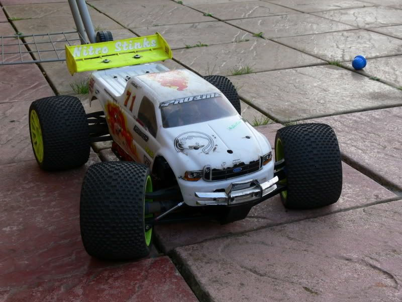

cheers Bud, that shell looks a bit batered now though
go4gold 09.13.2006 11:07 PM
Looks to pretty to bash. Were's all the dust and dirt? or is it just a inside truck? LOL I actually like your setup.

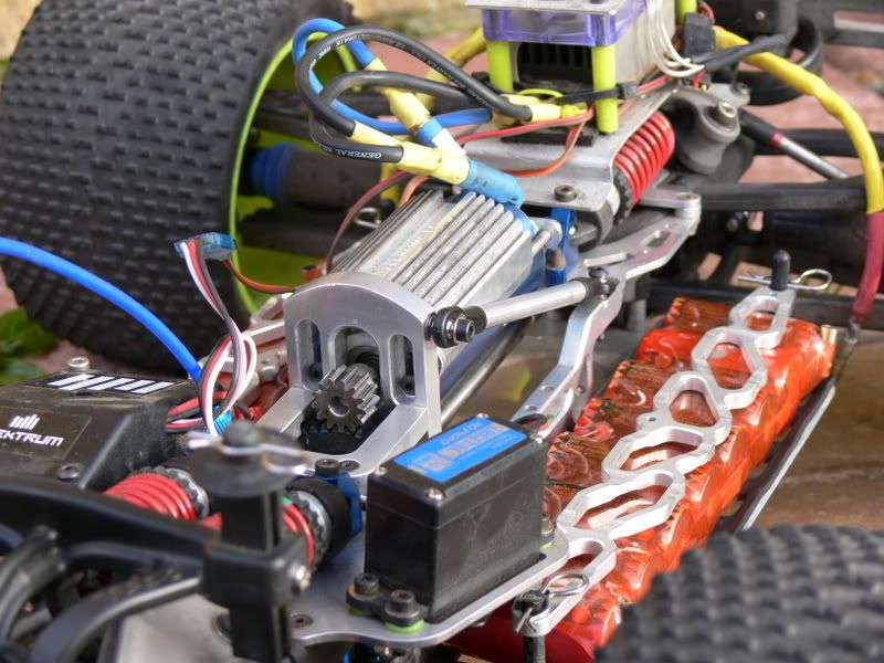

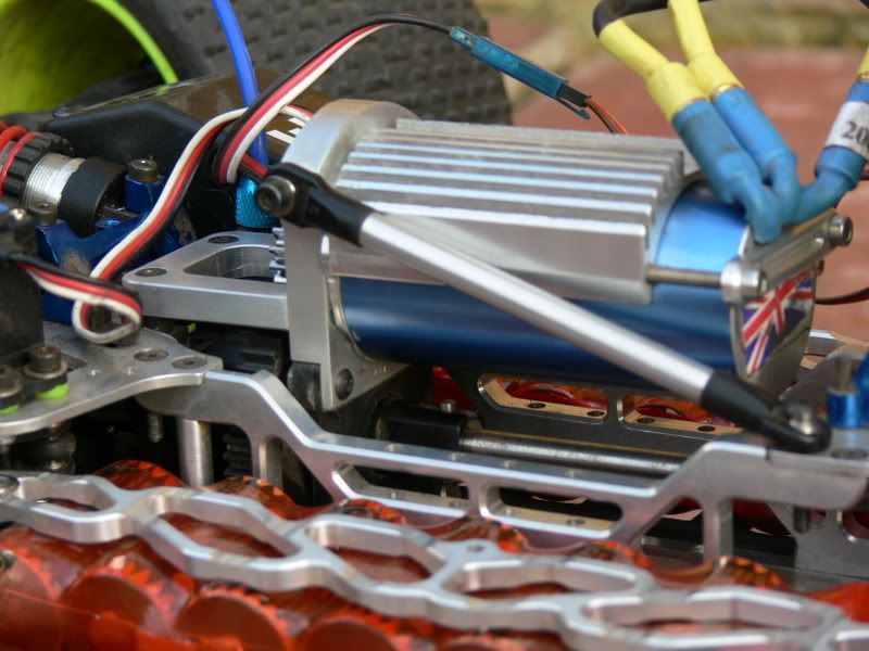

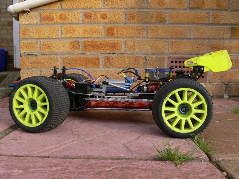

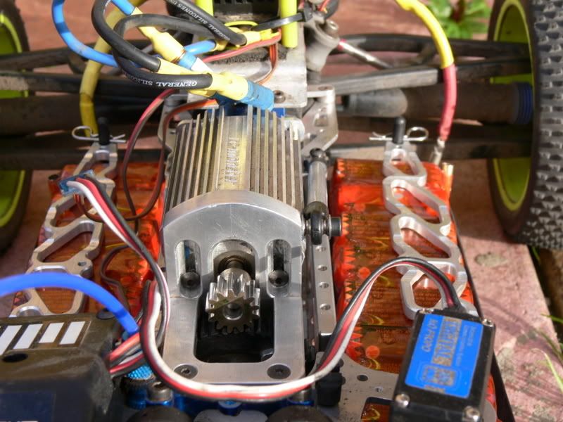

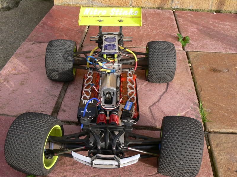

Ive made some changes to the Revo.
Namely, Ive installed Daf's motor mount and 8th buggy diff in the centre and some Traxxas set back arms.
Ive had the set back arms on for some time now and they make the truck a lot less prone to wheeling when you give it full stick, and it just skitts over the rutts and bumps at our track, but that is to the detriment of the turning circle, especially with the on power turns.
The Motor and diff mount is a bit of genius ( is this too much Daf?:005: ).
Ive yet to track test it, as I need a smaller pinon and tidy up the wiring. but the 13th that I have on it does give some good speed runs.
thanks again Daf...........................

Nice mods. Did you buy that motorplate, or did you make it?
read on.........................http://www.rc-monster.com/forum/showthread.php?t=2332

hey cabking, what is your gearing?:032: i would just like to know because now i am running a center diff in my e-maxx with 2.85:1 diffs like you......
cabking 10.22.2006 11:18 AM
well the pinion is a 13 tooth, I'm not sure about the spur, I could go and count it. but its not here at the mo. Mabye Daf will say.
For me I think it would be better on a 12 tooth though.
Dafni 10.22.2006 03:30 PM
It's a Ofna 51t spur gear.

Daf's mount is definitely as tough as it looks, it has had some real intensive testing over the last few months and has put up with the abuse admirably.
The only problem I came up against was the gearing. As Daf pointed out when i bought it,the mount will only alow the moter down so far, thus limiting the gearing options.
will the truggy diffs sort this out??....anyone?
Serum 05.05.2007 05:49 PM
Yeah, the 1/8th revo diffs can be bought in 43/13 or 43/10. This should address your gearing problems.
