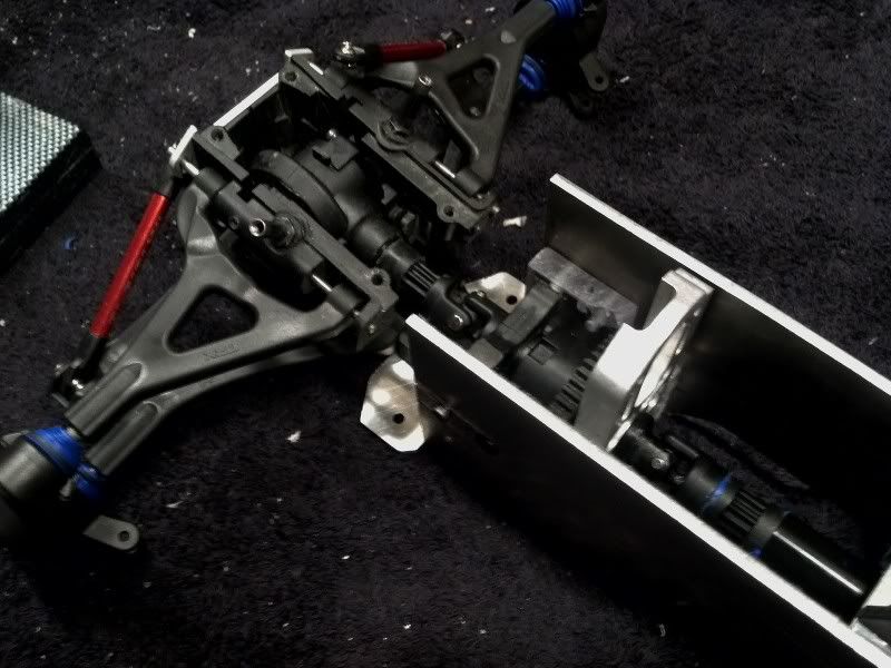

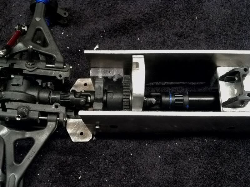

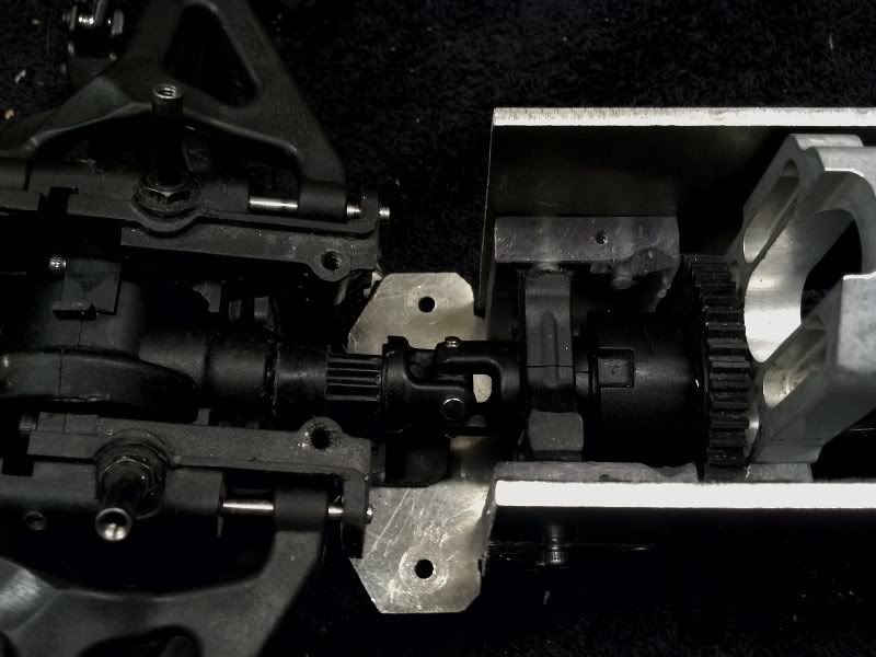

Now.. the front on the other hand was a bit more of a handful. I was planning on using just a cut-down slayer drive shaft for the front center drive shaft..but that ended up being way too long. The other problem is that on the Revo/Slayer/Summit the front differential is angled upward. My center diff is mounted horizontal. So I had to trim down the bulkhead so that the front differential could be at the correct angle to match up with the center diff.
I noticed that the male end of a Slayer drive shaft fits perfectly over the output shaft on the front diff. So I trimmed one down drilled a hole and put a pin thru it. To keep the pin in I made a simple sleeve. I have to say that so far this is the part that I'm the most proud of..because not being able to hook up a front center drive shaft is a big problem and I was able to fix it in a creative way..anyway enough talking..more pictures.
http://i8.photobucket.com/albums/a2/...3119-12-31.jpg
http://i8.photobucket.com/albums/a2/...3119-13-16.jpg
http://i8.photobucket.com/albums/a2/...3119-14-32.jpg
http://i8.photobucket.com/albums/a2/...3119-13-46.jpg

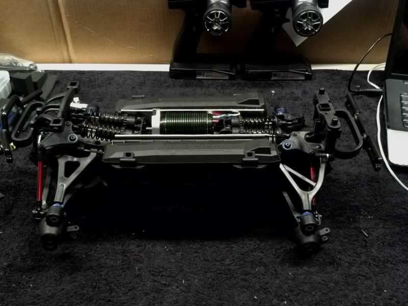

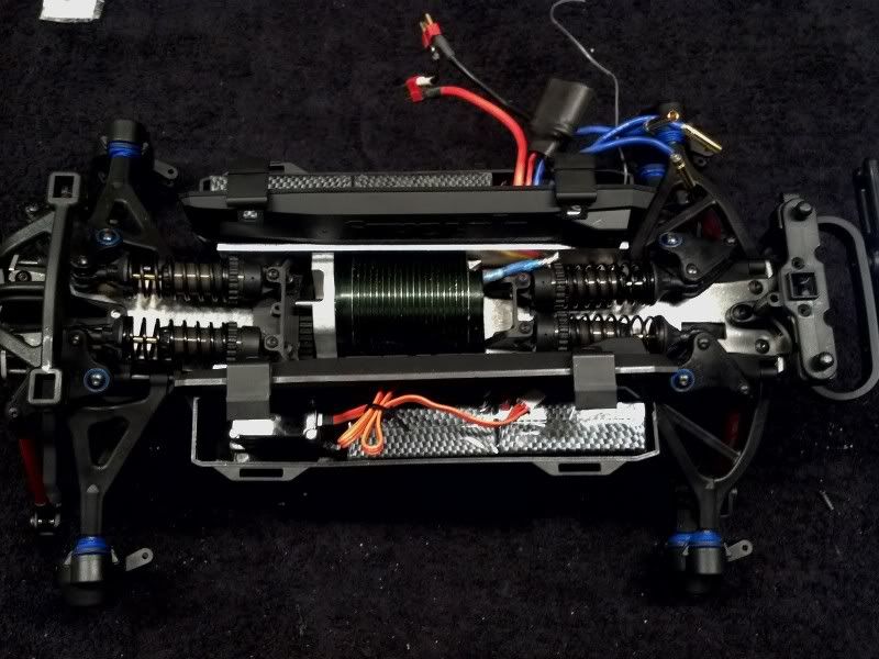

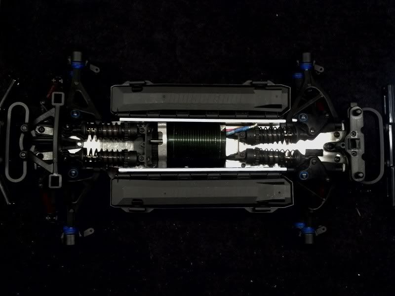

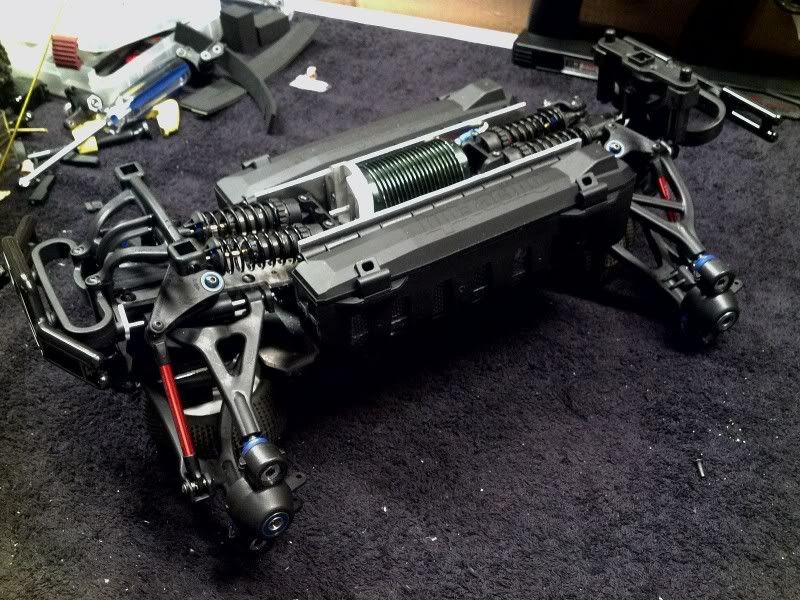

Anyway...got the battery boxes mounted and I'm getting very excited about this project!! Here is as it stands...need I say more?
http://i8.photobucket.com/albums/a2/...0221-13-15.jpg
http://i8.photobucket.com/albums/a2/...0221-13-58.jpg
http://i8.photobucket.com/albums/a2/...0221-15-32.jpg

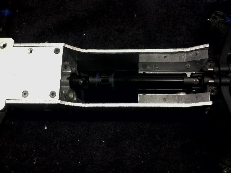

The battery boxs fit awesome... and the esc,receiver,and servo will also be mounted in the boxes. I'm going to try and route as much of the wires in the boxes so that it will be a very clean electronics install. Here is how I'm planning on having the batteries/electronics layed out

wow those flux battery boxes fit sooo good on there
is that one of those fragile hk100 escs with the remote caps poking out there ?

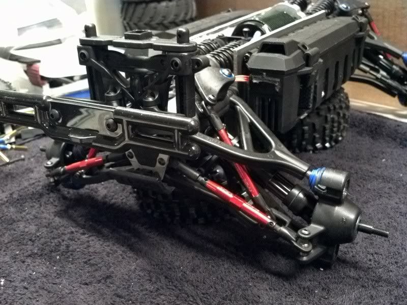

JoFreak 09.04.2011 03:43 PM
Looks nice and packed, no wasted space in there, like it!
One thing though:
What wheels/tires are you going to use?
Because from the looks of it, I'd say pretty much everything without a lot of offset will hit the battery trays at full steering lock.
But maybe it's just the angle of the pictures that's missleading me...
brainanator 09.04.2011 04:21 PM
Make sure you get some velcro straps to throw around those battery boxes. Also, try switching them around, so the hinge is on the outside. They give you a little better access that way. I don't run that way, but my brother does, and I kinda like it...lol

Jofreak: Thanks. Definitely no wasted space on this.
I will be useing Imex rear Jato wheels and Proline 2.8 badland tires. The Jato wheels have plenty...almost too much offset to them..and don't come anywhere close of hitting the battery boxs.
Brainator: Yep, I have some tekno ones I'm going to throw around them. I looked into doing that and since the shocks and motor are there..I feel like it would be hard to squeeze the latches. Once I trim down the TVP's the battery box tops will open up more than enough.

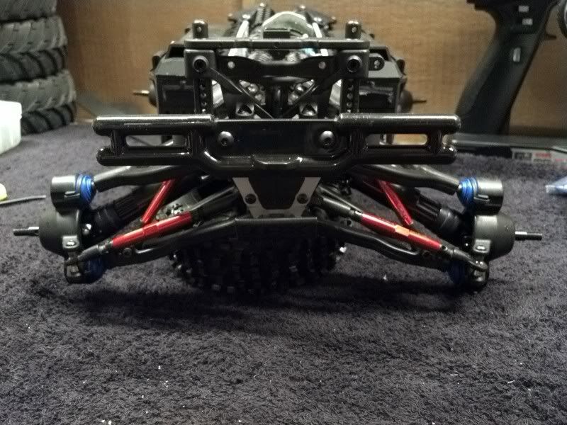

I got a small update for you guys today...

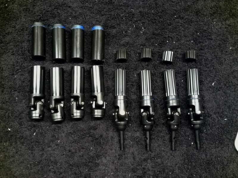

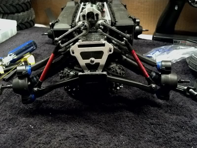

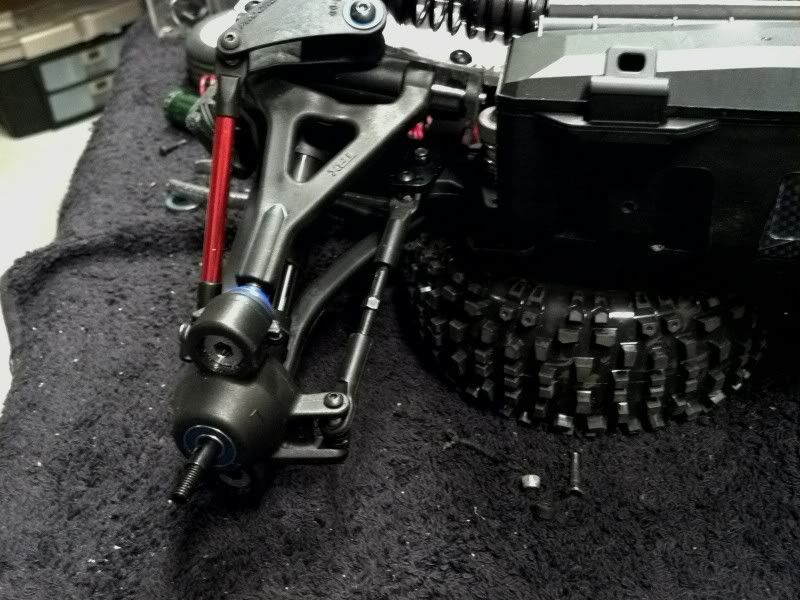

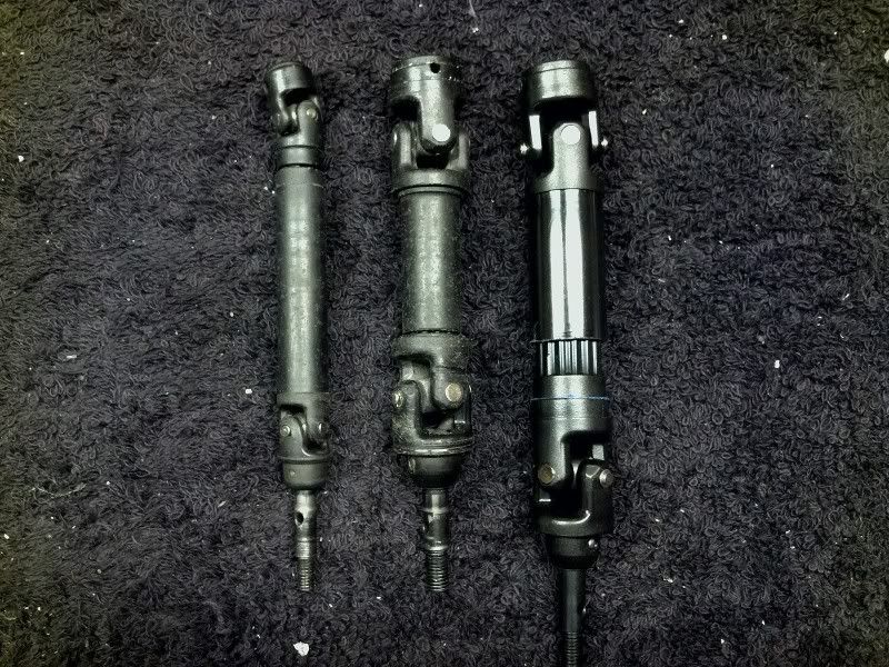

When I got the Slayer Pro a-arms I was under the impression that the stock Slayer Driveshafts would be long enough to work with the Pro extended a-arms. I didn't feel like they would be so I bought some Revo Driveshafts. Summit driveshafts would've been better since you don't have to worry about the little e-clips falling out but the Summit drive shafts are crazy expensive. So, I went with Revo drive shafts. Revo drive shafts are obviously way too long...so I got out the scroll saw and trimmed them down.
http://i8.photobucket.com/albums/a2/...0623-39-57.jpg
As many of you know Revo driveshafts are beefy...how beefy you ask? This beefy!
(Left is a Jato/Rustler/Stampede drive shaft, center is a stock slayer drive shaft, and right is the revo drive shafts )
http://i8.photobucket.com/albums/a2/...0623-41-47.jpg
With the drive shafts installed...
http://i8.photobucket.com/albums/a2/...0700-03-52.jpg
While I was at it I put some Jato rod-ends on the Rc8 steering turnbuckles I had used on the Evo8 in order to make them long enough and mounted them
http://i8.photobucket.com/albums/a2/...0700-04-11.jpg
On the rear I installed the drive shafts and installed Jato rod-ends also on the Toe links.
http://i8.photobucket.com/albums/a2/...0700-08-21.jpg
http://i8.photobucket.com/albums/a2/...0700-11-24.jpg
