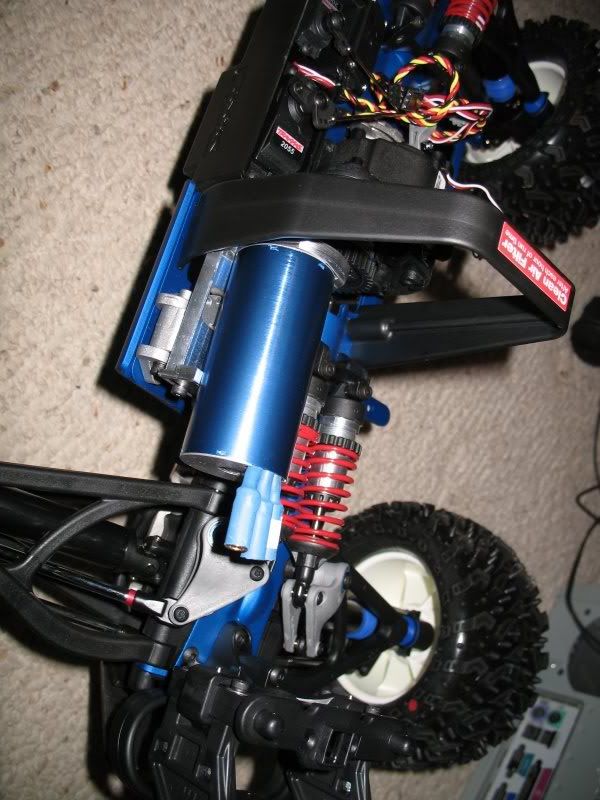

are my eyes playing tricks on me?
http://i118.photobucket.com/albums/o...s/IMG_0926.jpg
Looks like the motor is at an angle?
[img]
No, you are correct the motor was at a slight angle. There is a blurb in the post about it just being set in there. I did bolt it on today though.
