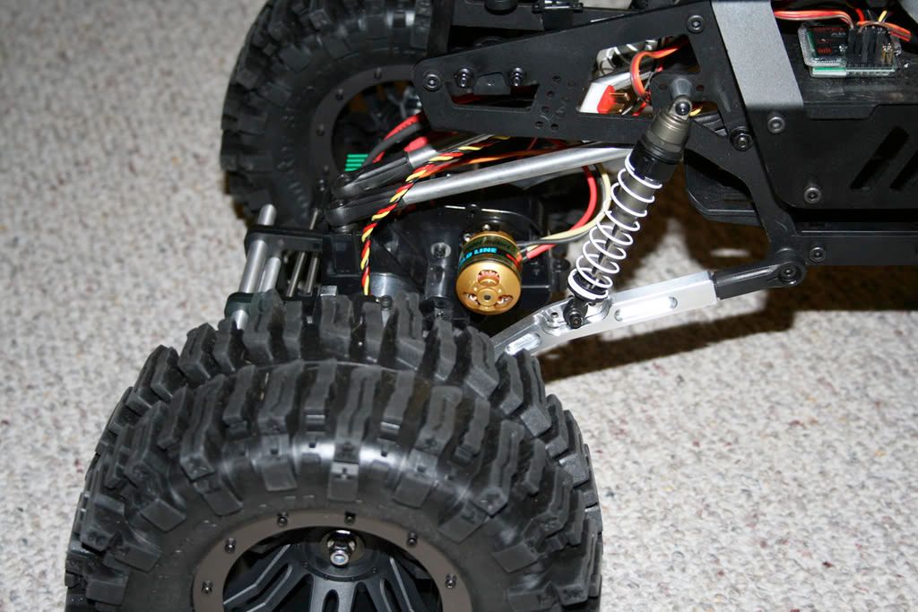

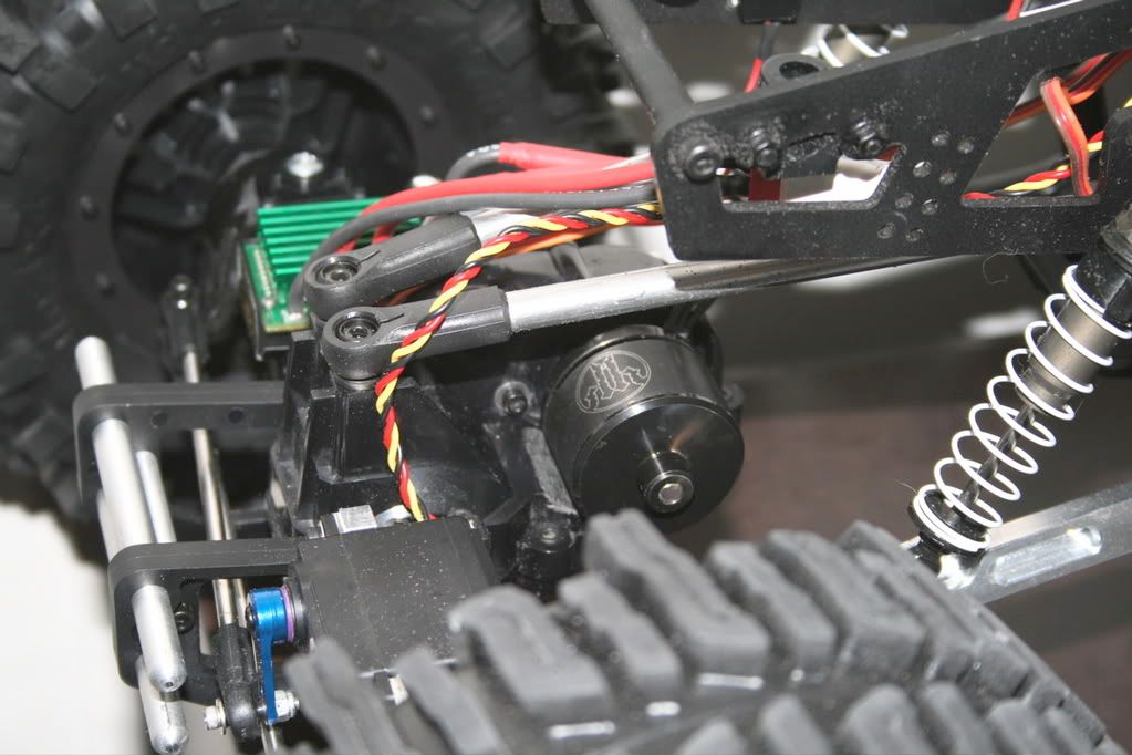

the Stealth has seen some serious wrench time (and cash) in the form of lots of upgrades. i'm tired of waiting for a nice sunny day outside to take it out for shots - so i took these 2 inside shots.
what i've done:
* brushless! i threw a pair of AXI outrunners on. 2217/16 Gold's each attached to it's own MM, and 3s a123 racing packs. the AXI's are max 83% efficient, and each has 1050 rpm/volt
* 9 tooth long hardened steel pinions from RC4WD
* new wheels/tires: Axial's new oversize narrow Rockster beadlocks paired with RC4WD 40 series Mudslingers. these things are huuuuuge
* the lightest, softest springs i could find. they're Losi's, and fit over the big bores nicely
* a Spektrum DX6 radio system so each stick can control the front and back (1 stick controls front throttle and steering, the other stick controls the rear)
the lower chassis plate now has 5.5" of clearance! the power this thing now has is absolutely crazy too...
sorry for the poor pics - i'll shoot some better ones when the weather clears up. inside pics suck. :sleep:
http://i271.photobucket.com/albums/j...r/IMG_0817.jpg
http://i271.photobucket.com/albums/j...r/IMG_0816.jpg

Axle mounted ESCs. Is that safe? Those tires are huge. We need more pics and some action videos.
ClodMaxx 01.16.2008 11:09 AM
axle mounted esc's aren't totally unheard of in Supers. here's one example of a nice one. the esc's are tucked away in an area that is fairly well protected by the wheels, and there is no speed at all. if the truck flips or falls, there won't be any impact on the esc. i just have to worry about no servo saver. i already had to replace the gears in the front 645mg due to running into something with one front tire too fast.... :oh: stripped out instantly.

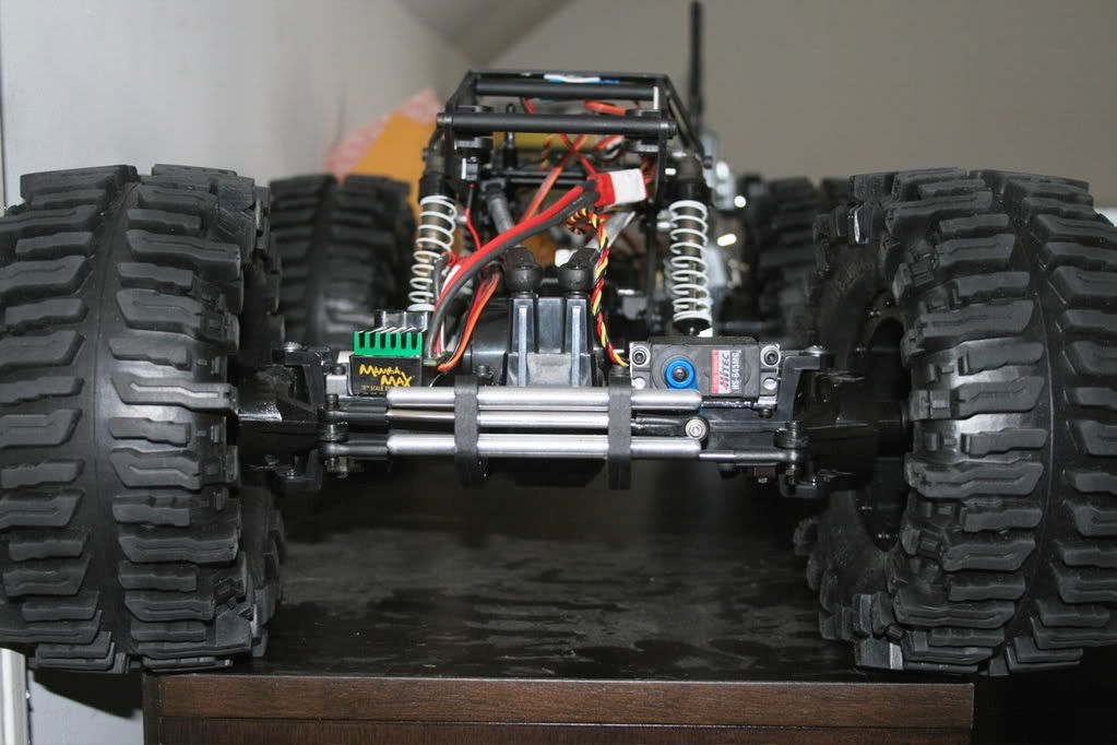

it took some modification, but i managed to get my new Holmes Hobbies Crawlmaster Sports installed. :yipi:
http://i271.photobucket.com/albums/j...r/IMG_0839.jpg
http://i271.photobucket.com/albums/j...r/IMG_0838.jpg

I really like the way those look. What pinion are you using? All that isn't black are the links.
ClodMaxx 01.28.2008 12:13 PM
i'm finding people either love 'em or hate 'em... very little in between. the ones who aren't crazy about the design seem to be the hardcore crawlers who like the tubers, sticks, etc.
funny you say the only thing that isn't black are the links... i'm looking at possibly replacing the aluminum links with black delrin rod, and would increase the wheelbase at the same time (like what kamikaze did to his super). then it would be all black, and longer than the 16.5" it currently is.
i'm still using 9 tooth pinions. i just got a set of 7 tooth pinions, but they won't fit - the ONLY thing i'm not happy about this truck is that GMade made adjustable motor mounts but won't allow the shaft (with the 7 tooth pinion) to get close enough to the spur. i have to dremel out material so it can get closer.
last night i saw that GMade came up with a super-strong servo saver that's integrated into the steering link. i placed an order for 2 of them, to see how they do. i fried another 645 last night.... :grrrrrr:
