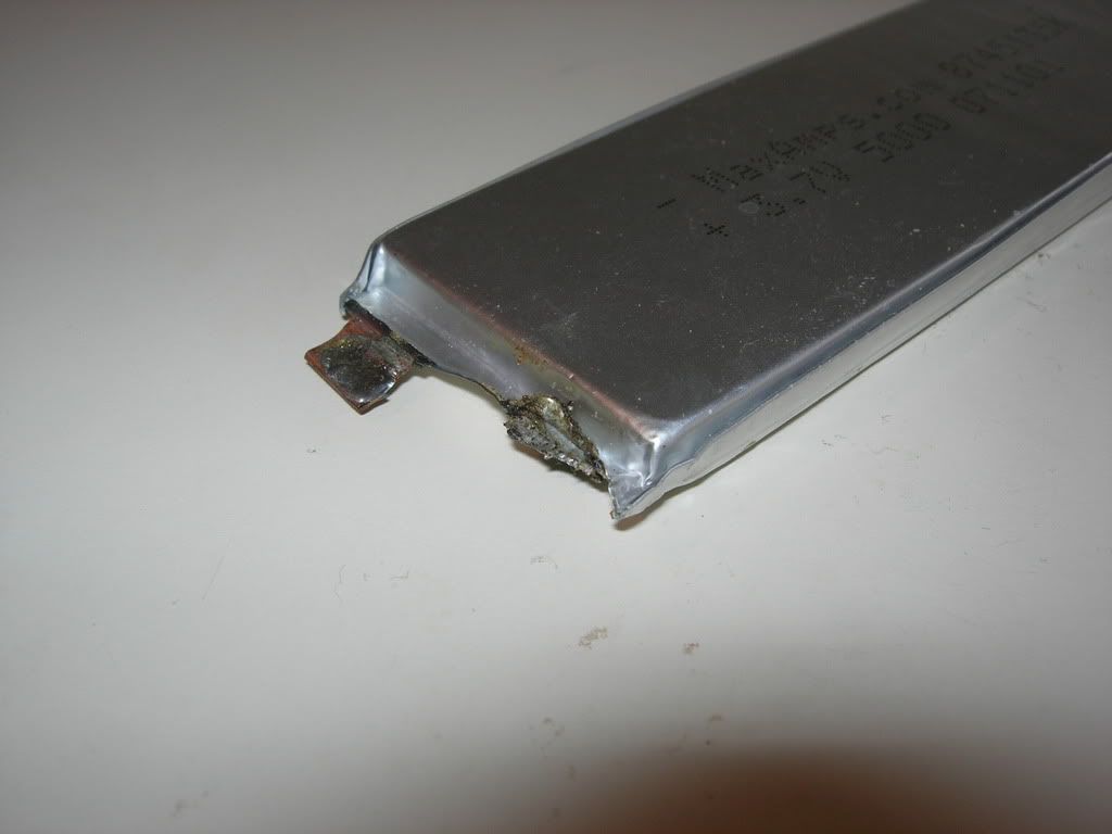

DrKnow65 04.30.2008 08:19 PM
Fair enough :yes:
Guess I need to get an eagletree data logger and figure out how many amps my 3.5lb 4wd 1/10 buggy is pulling :no:... I have had 2 3S 5000mah packs give out on this car running a MM and a 5700kv motor.
The most recent failure (and I believe the same failure that happened to the last pack but I didn't open that one up) was one of the cell's tab burning off. I'll post up a pic here in a bit.:neutral:
The first batt I got wouldn't balance. Guess I must have just been in the small percentage of factory defects 3 times in a row...
DrKnow65 04.30.2008 08:21 PM
Edit, forgot to say thanks for posing up the graphs. It feels funny that so many people have askes sop many times with no responce, I ask once and here they are hahaha. Suppose I should have asked sooner :)
DrKnow65 04.30.2008 08:37 PM
http://i217.photobucket.com/albums/c...5/DSCN4735.jpg
lincpimp 04.30.2008 09:11 PM
I had the same thing happen with a few cells. I often doubt that the thin tabs can hadle the current, especially when it gets over 100amps.

DrKnow65 04.30.2008 09:22 PM
Is it possible i've hit 250amps with this rig?
Specifically a Team academy SBV2-Pro 1/10 4wd buggy, MM/5700Kv, 5000mah 3S, 15/86 gears (around 78mph on BrianG's speed calc)
I would think the tabs would have to conduct the burst rating of the pack. I mean the sustained rating is 150amps, and the continuous is 100...
So far this is the best arguement for high voltage I have seen. No matter how good the cell is, if the tabs can't handle the load, better run more volts and less amps.

Sike and I came to the conclusion that there is no way that the thin little tabs could hadle the spec discharge numbers, just not going to happen. High voltage is a much better way to go. My 8s savages with the 14xl feigao runs 3600 12c poly rc packs (around 45 amps cont) and has no issues. Motor gets to around 140 and stays there for a 30min run. The 60 amp esc barley gets warm, maybe 110, and the batteries are around 105 when the run is done. It is a heavy truck, and has plenty of power, more than my 7xl 4s revo.

The tabs that we use are copper, not nickel. Copper is 10X more conductive and our copper tabs are very thick. Twice as thick as most the manufacturers I have seen. They can handle those very high amp draws in bursts. I think I have an eagle tree showing bursts in the 250 amp range. I will see what I can dig up. Very few setups are running in this range.
