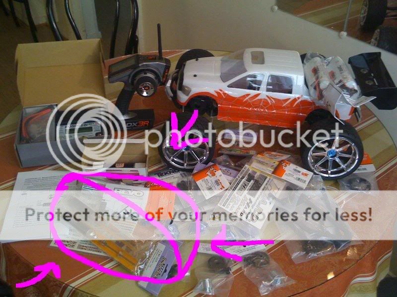

So I have think what else would I need.. Here's some preliminary list

I forgot to take a picture of it but here's the same concept on my tmaxx/revo tranny. http://i256.photobucket.com/albums/h...xx/Picture.jpg |
