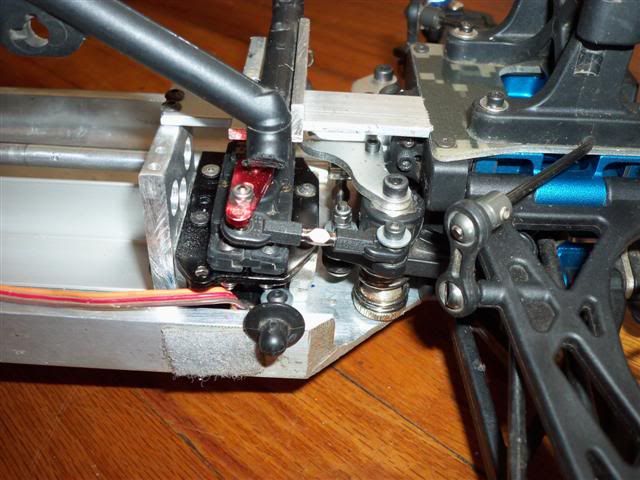

I had some time to finish rebuilding the front end:
http://i779.photobucket.com/albums/y..._0702Small.jpg
I spent some time getting the steering as smooth as possible, there were some places that were offering a little resistance. I also moved the steering servo forward as far as possible:
http://i779.photobucket.com/albums/y..._0707Small.jpg
in order to open up more room for my battery compartments:
http://i779.photobucket.com/albums/y..._0703Small.jpg
http://i779.photobucket.com/albums/y..._0705Small.jpg
I want these to be as large as possible to give me more options when I buy new packs. I'm planning to purchase 2x5s 5000mAh packs to run in this and I should be able to get them to fit now. I have both more length and width on the trays and they are adjustable, too. (max length = 170mm, width = 50mm on one side and 45mm on the other side) I can move my current batteries farther forward to get more weight over the front tires - maybe improving handling. I can also adjust the width of the tray by loosening two screws and sliding the long Al angle. I have to cut pieces for the other compartment and then I will make a single Al strap to tie both batteries down. I'm hoping to be able to make something that is easier to use than a bunch of velcro straps under the rollcage, which I used previously.

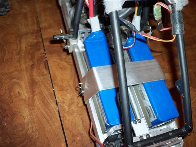

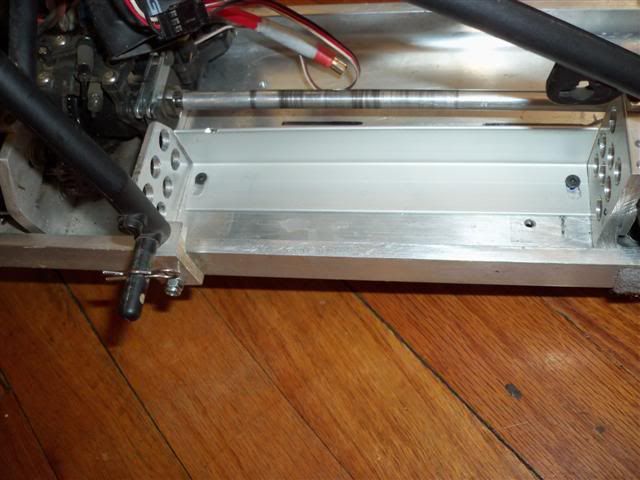

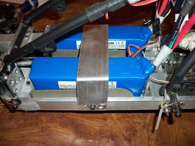

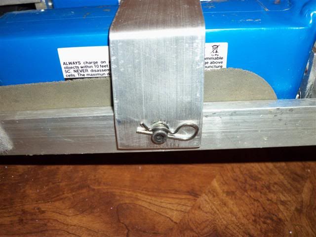

Battery compartments and new strap are complete. I used 1.5" wide 1/16" thick Al to make the strap. It attaches to M4 screws with holes drilled through the cap heads for clips. I'll see how I like it:
http://i779.photobucket.com/albums/y..._0713Small.jpg
http://i779.photobucket.com/albums/y..._0714Small.jpg
http://i779.photobucket.com/albums/y..._0716Small.jpg
Bmr4life 01.26.2011 05:24 PM
I hope that's really tight. Don't want the batteries being able to move at all because they'll hit that metal strap and potentially get cut.
Some velcro strap routed through the chassis would be a nice plan B.
brian015 01.26.2011 05:35 PM
Yes - I'll be adding some padding under the metal strap before I use it to make sure everything is snug.

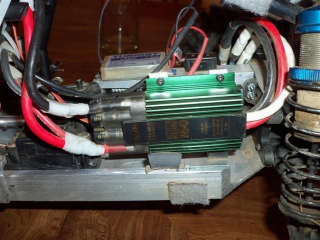

I just had a close look to see where your ICE ESC and BEC were mounted. Have you thought about installing a fan connected to the 3rd channel to keep the ESC Cool??? Have you got any clearer images of the esc mounted to just give me a rough idea as to how large it is and mounting points etc????
Thanks

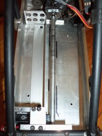

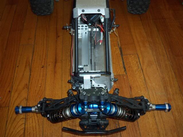

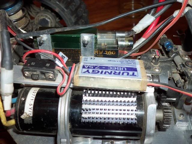

brian015 01.26.2011 08:19 PM
I didn't have room to mount the esc flat to my chassis so I made vertical brackets from Al strips and secured them to the chassis through some rubber pieces (to give it a little shock absorption). The esc is the same length as the 1527 it runs next to - so it's right at 4" long. I didn't have any problems with temps last summer in 80-90F weather (see back a few pages) so I didn't bother with a fan.
http://i779.photobucket.com/albums/y..._0721Small.jpg
http://i779.photobucket.com/albums/y..._0723Small.jpg
I haven't yet cleaned and rebuilt the back half of the truck yet, which you can see from some of the dirt in the pics.

Just looking at your wiring... How do you have the BEC wired up exactly?
brian015 01.26.2011 10:15 PM
Originally Posted by Jahay (Post 395435)
WOW IT IS HUGE
im going to struggle to fit that in my already tight chassis. I will need to make a secure mount for it.
BEC input (power) wires are soldered to wires going to my extra capacitors which are soldered to the battery leads of the esc (connected near the esc caps). BEC output goes to the battery input on the rx.
If that makes sense.

i guess i sort of get that... i may ask for a clearer explaination once i eventually get my pieces...
the CC BEC PRO is $44! i think ill be getting the turnigy one instead!
brian015 01.27.2011 09:23 AM
You could simply solder the BEC power wires along with the esc power wires to whatever battery connectors you put on the esc. I did it the way I did because I was adding extra caps at the same time I was connecting the BEC.

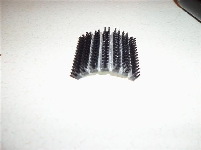

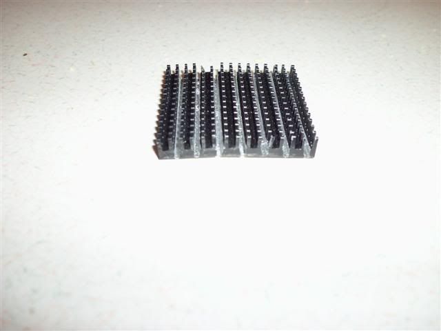

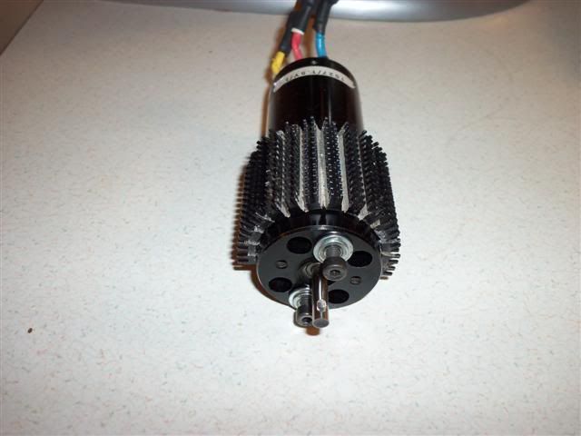

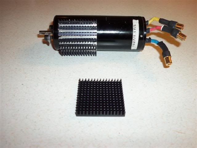

I decided to add another heatsink to my motor. I was unable to find any clip on ones that would fit in my confined space, so I made my own from cheap cpu heatsinks.
Here is one I've had installed, and a new one:
http://i779.photobucket.com/albums/y..._0725Small.jpg
I cut grooves in the new one with a hacksaw through (almost) to the thermal tape:
http://i779.photobucket.com/albums/y..._0732Small.jpg
next I bent it around the motor:
http://i779.photobucket.com/albums/y..._0737Small.jpg
and then installed it:
http://i779.photobucket.com/albums/y..._0738Small.jpg

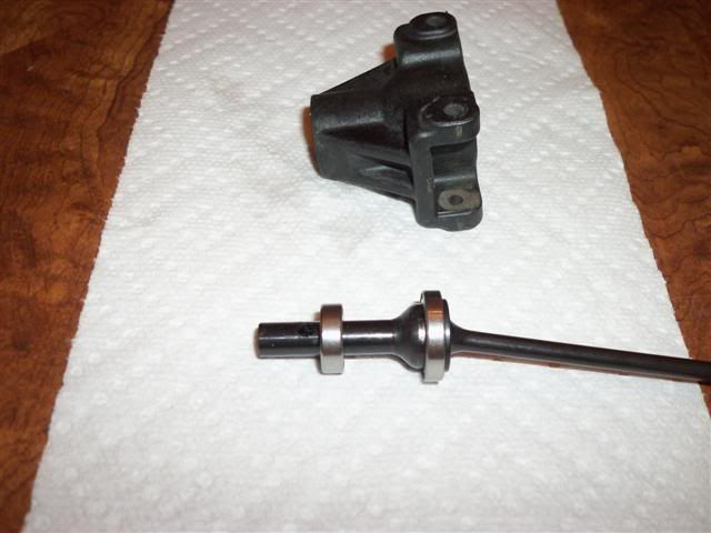

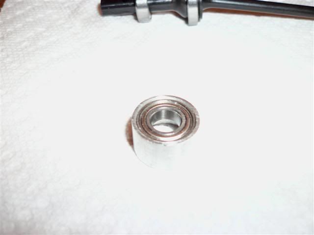

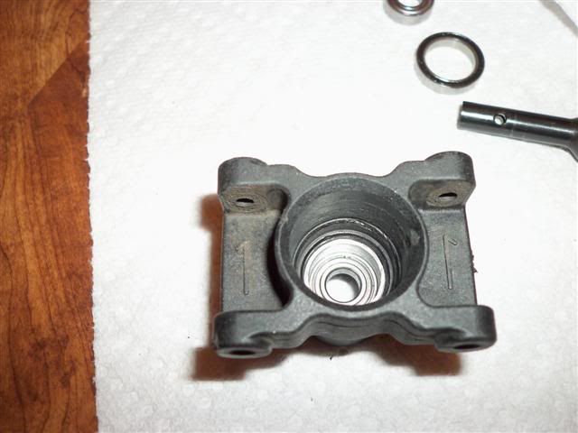

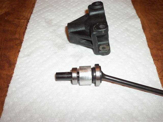

I previously added a bearing to each of my front carriers:
http://www.rc-monster.com/forum/show...t=26979&page=8
Now I'm getting around to doing the same to the rears. I used an 18mm OD Al tube, 1mm thick, as a sleeve for another 16mm bearing:
http://i779.photobucket.com/albums/y..._0787Small.jpg
So that I can go from this:
http://i779.photobucket.com/albums/y..._0786Small.jpg
to this:
http://i779.photobucket.com/albums/y..._0785Small.jpg
With sleeve and extra bearing installed:
http://i779.photobucket.com/albums/y..._0791Small.jpg
I did this to help give more support to the axle, since the thin 15x21 bearings have failed at least once on me previously.

Can i ask you a quick question regarding the extra bearing you installed in your lst hub please...
Why did you put a 1mm sleeve on it? was it necessary to get it to fit correctly? did you just want to distribute the weight of the axle on the bearing evenly? how well did it work?

I needed the 1mm thick sleeve to properly fit the inside of the stock carriers - otherwise I would have just jammed the bearing in there and been done!
