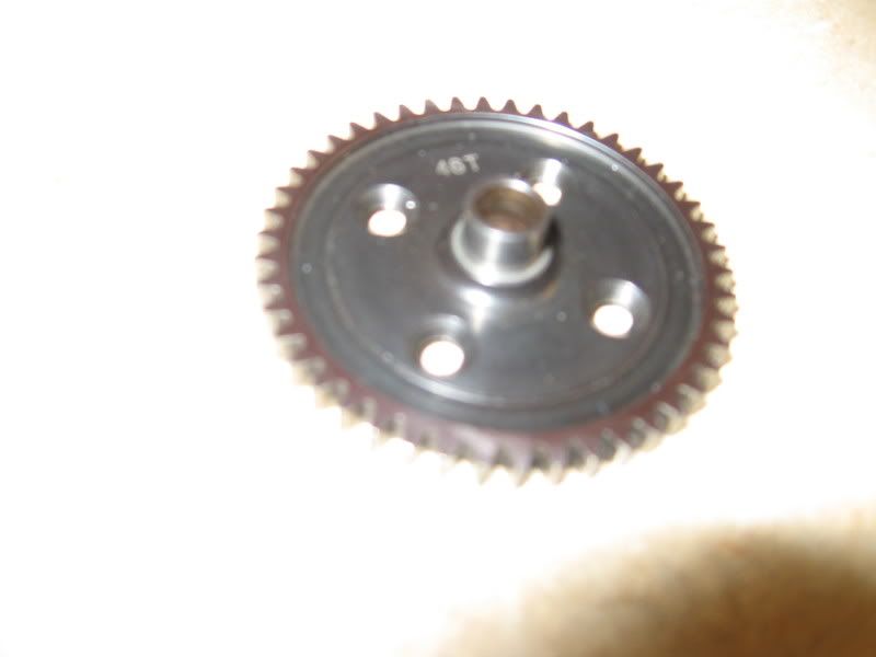

TDC57 07.04.2008 05:04 AM
Hay DB,
I've got a 46T I can ship you off a XRay if you want to pay for the postage (?).
http://i264.photobucket.com/albums/i...7/IMG_3138.jpg
Your call either way, regardless I must say that I enjoy reading your updates, I feel your pain.
Have a great 4th..
Shaun.
DRIFT_BUGGY 07.04.2008 05:23 PM
No, its right Shaun, got a spare one anyway and also have another spare one coming with the diff fluid I ordered, thanks anyway
