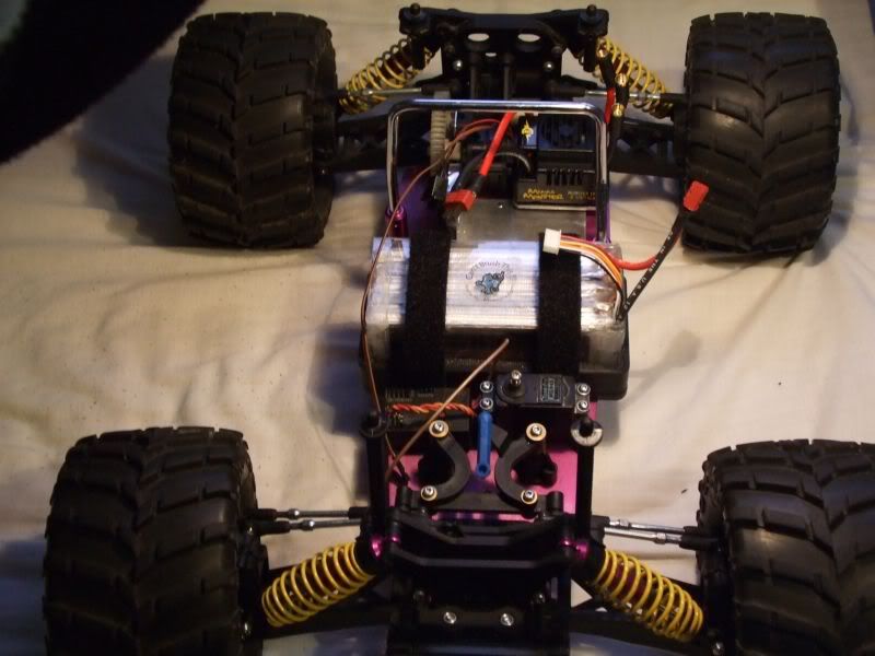

Liking that alot, that breeze-block of a lipo pack fits very nicely in the tray. You could make the velcro straps work by finding a longer piece of the double sided part and fitting that instead of the normal one (fuzzy half its length, hooks the other half). Unless you've already sorted it in which case please disregard my idea.
Dagger Thrasher 01.31.2009 07:25 PM
Cheers guys. Thanks for the tip Neil, but I've already got it sorted. I just bought some 20mm-wide velcro strapping (hooks one side, loops the other), cut it to length and used that. It's a bit less elegant than proper battery straps, but should do the job perfectly well. :smile:

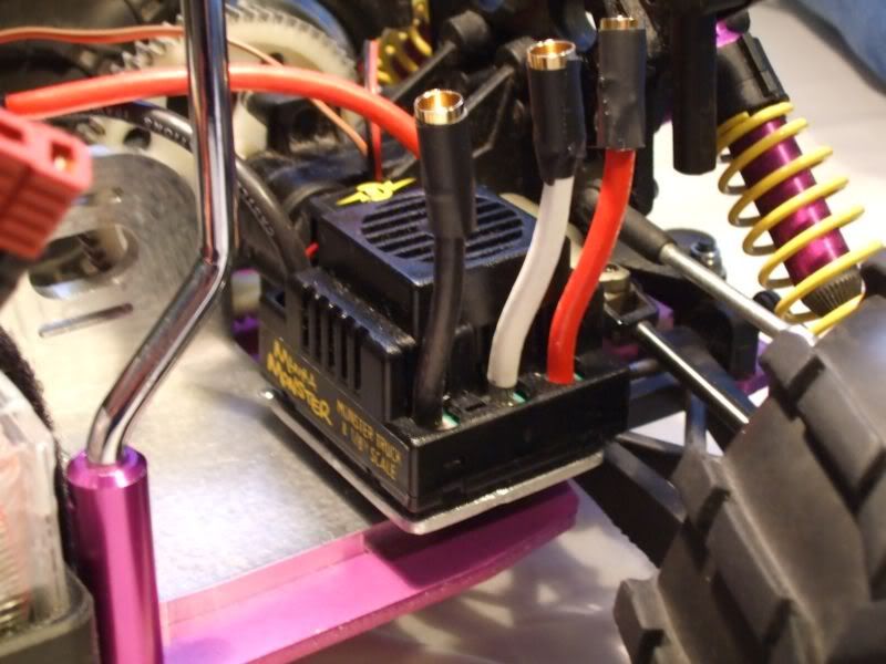

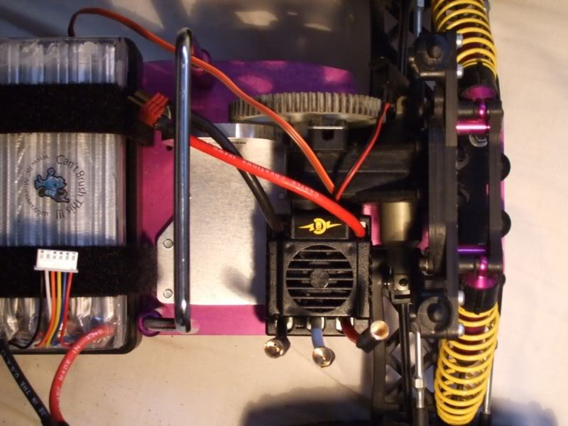

At your special request, I took some pics of the mounted MMM lol. They're a bit rubbish because I had to take them inside, as it's bucketing down with snow outside. It did need a bit of lateral thinking to make space to mount it, though:

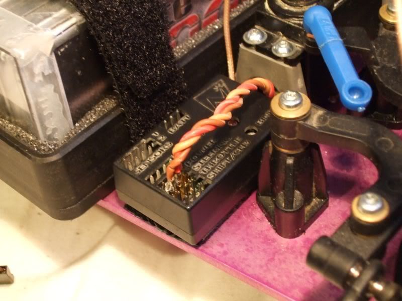

And the Nomadio Transceiver. I opted to shop the servo lead short as it's right next to the transceiver, which gets rid of a load of messy wiring:

The ESC plate is just a bit of 3mm aluminium, which I mounted on the left side of one of the inner rear hingepin brace. I'm just using slightly longer screws which go through the brace as normal, but then thread into the plate which places the ESC just above the bottom motor mount plate. Maybe not the most elegant solution, but does the job!
The only issue is that once the motor's installed, it'll be within about 2-3mm of it which isn't ideal with the radiated heat...but there's nowhere else to put it. There's also not a whole lot of gap between in and the wishbone when it's compressed, but that should be ok. I might knock up a lexan dirt guard.
