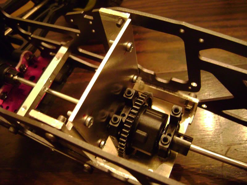

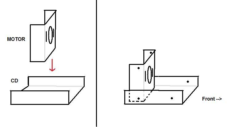

I decided to redo the center area as I just wasnt thrilled with some small mistakes I made. I ordered some 6061 aluminum and am going to re build my CD and motor mounts. Basically there will be two "C" shaped plates, one for the CD and one for the motor. The CD plate will allow me to mount the CD like it should be, screwed in from the bottom. The legs of the C will screw to the chassis. The motor C plate will have the legs attach to the inside of the TVPs and the body of the C will be facing the front so as to be close to the spur. Maybe hard to follow... have a look.
I dont know why I didnt think of this in the first place, its so much simpler than what I did before and uses many less parts.

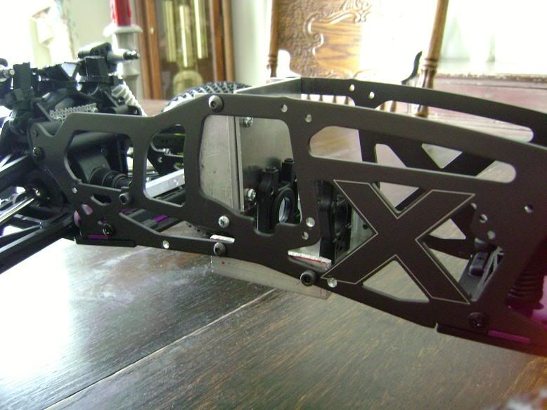

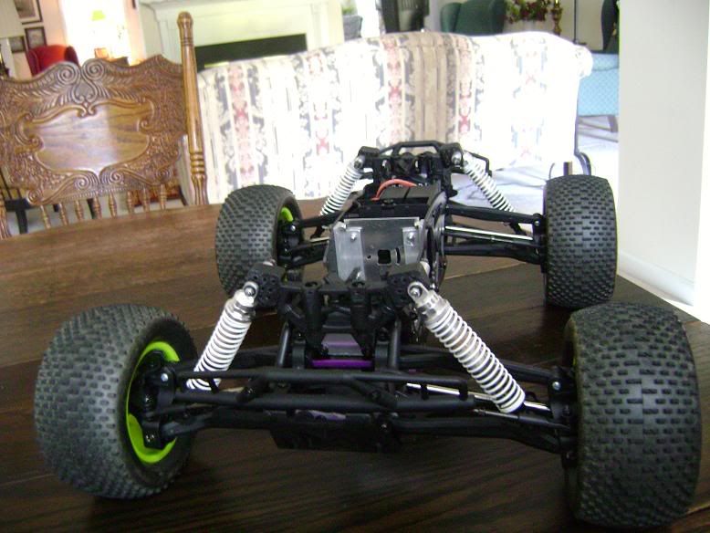

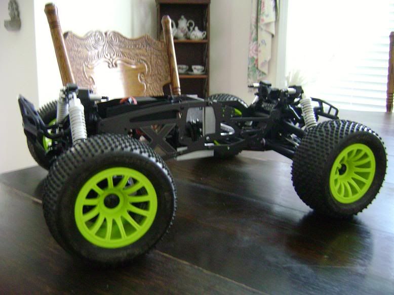

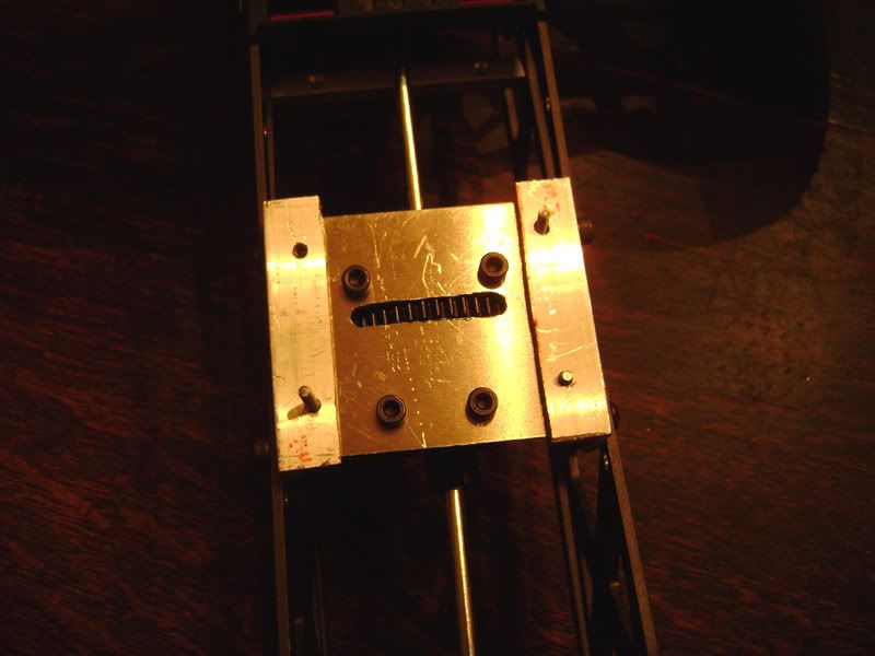

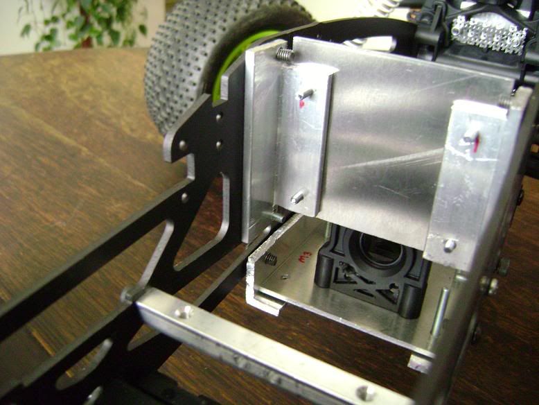

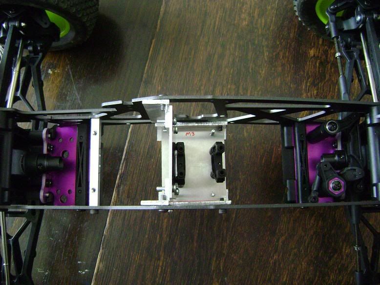

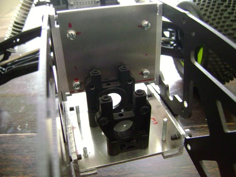

Alright Im about 75% done with the new mounting scheme. I had to use only tools I have here at my moms house since Im home from school now. So all I have to work with is an electric drill, a hacksaw, and some small clamps. No workbench, no metal files... UGH its hard and sloppy but I got the job done.
Its obviously not totally finished and its a rough draft mock-up right now but you'll get the idea. I think its going to work well, I just hope I used thick enough aluminum for the motor mount.

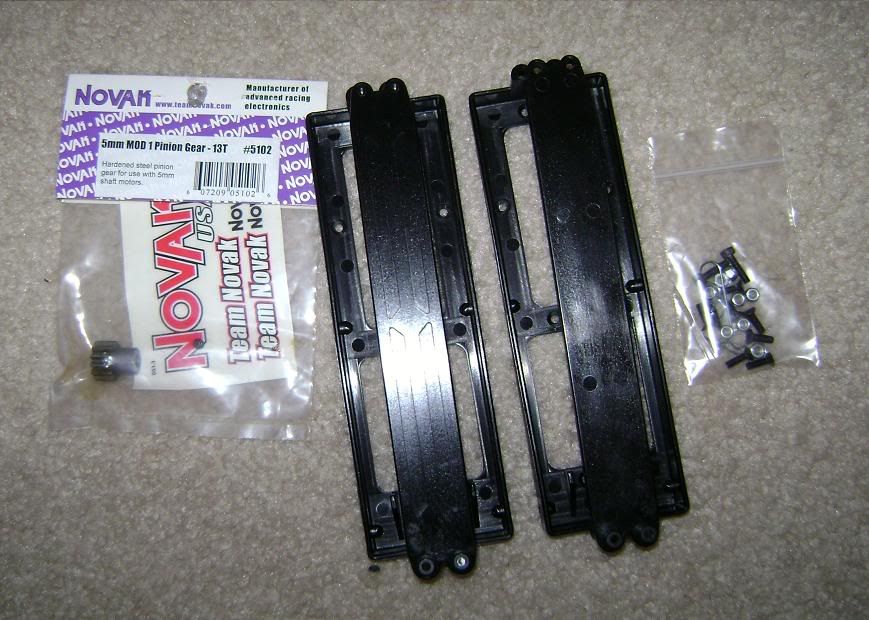

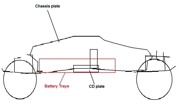

So I decided to mount the battery trays just barely below the CD plate, but just barely above the skid plates. So again if the truck bottoms out the battery trays will be fine, but if I curb the center part it will only hit the platic trays and not the CD plate, at least thats the idea. There will only be about 1 mm to spare on either side if this goes right. This is the only drawback to the way I decided to make this setup, but I dont plan on doing any rediculous bashing. Im going to be pretty careful with it, too big of an investment to trash around.
Heres an idea of what I was saying.
http://i181.photobucket.com/albums/x...yisfunny/m.jpg
The extra bonus is that it gets the batteries REALLY low on the chassis. All the weight will be very low on this truck to Im hoping itll almost be a Savage Muggy when its all said and done haha... :mdr:

Got the motor plate pretty much done. If I need to drill out the hole a little more for the medusa it wont be a problem.

The CD is a losi 8ight-t model. It is pretty easy to do the conversion, the hard part for me was lining all the holes up correctly and making the cuts correctly as I have VERY limited tools (read: electric drill, hacksaw, and metal file). I made tiny errors in lining up the holes all the time and had to constantly drill out the holes extra to make things fit. Other than that it has been pretty easy.
I wanted to be able to side mount the CD in the chassis so I could lower the motor and mount it on the side opposite the CD, but there wasnt enough room to have them side by side. On the savage-central forums in the project area, theres a guy who made a custom chassis and widened the area between the plates, and he made a CD mount for his nitro truck and has the nitro motor laying next to the CD, very cool idea.

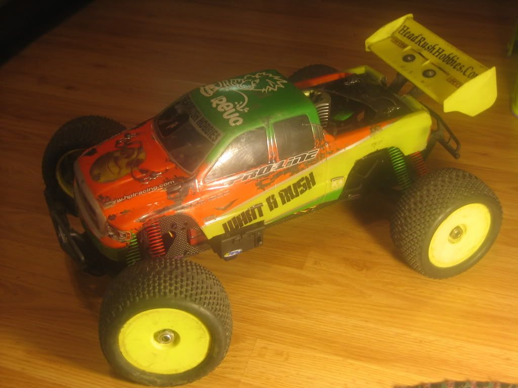

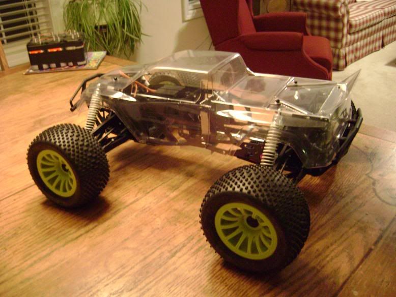

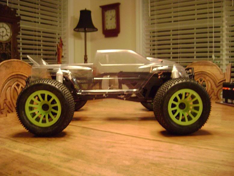

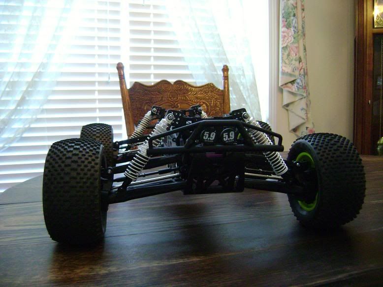

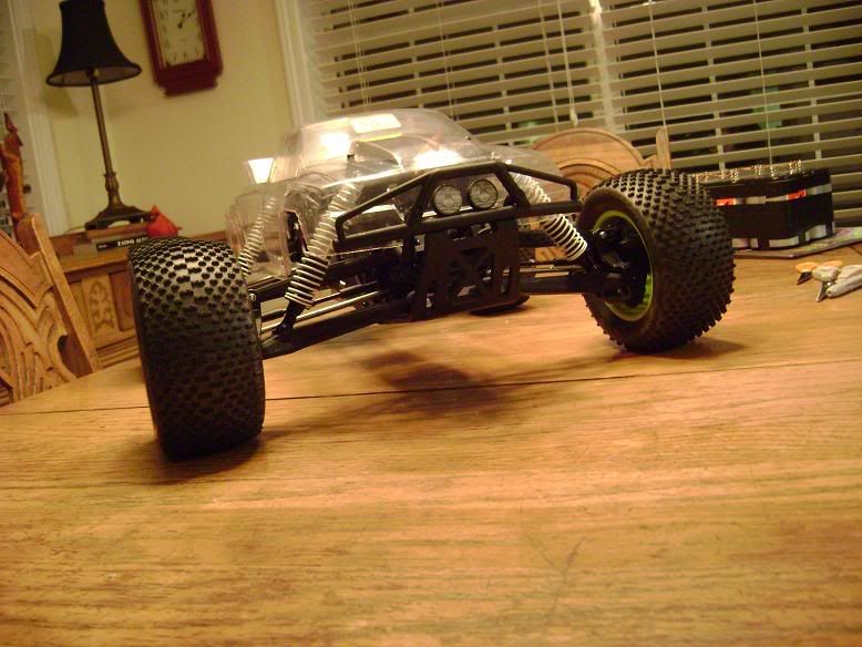

Got the body all cut and drilled, its an HPI nitro GT-2 with spoiler. Now to decide on a color scheme... I dont want to do something typical, but Im having trouble finding something I like that will match the yellow wheels. These pics are without batteries or motor, so when finished the truck will sit a little lower. I wanted the body to sit as low as possible, and this is it with these towers.
http://i181.photobucket.com/albums/x...unny/body2.jpg
http://i181.photobucket.com/albums/x...unny/body1.jpg
http://i181.photobucket.com/albums/x...unny/body3.jpg
I like what LarsenRacing has done with this body below, might give that a try.
Still alot of options to choose from, just gotta pick the right one for me.
http://i151.photobucket.com/albums/s...linkage014.jpg
littlegiant 05.22.2009 03:22 AM
That is one hot looking truck. I like the low stance. Kinda like a truggy now.
I really love the looks of it.
brushlessboy16 05.22.2009 07:40 AM
Wow I like it, that body looks great on your setup. now all you need is a wing mount :)
