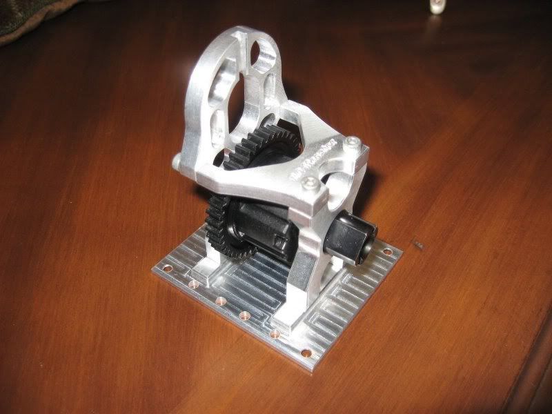

I'm going getting my G3R done next week - I'll speak to him about it but the issue is it requires precise drilling I believe of the bottom plate - Mike has a jig or programme for it but I think he's nervous of just shipping them out and people shagging up their cars
Rivermaxx 07.17.2009 10:37 AM
Actually I think he has redesigned it . It doesnt bolt to the centerskid any more. It ataches to the bottom of the xbrace where the trans bolts too. Look at the pics youll see what I mean. I emailed about one of these in early 2008 and never got a response. The first one I saw was parylized's cd and I wanted one ever since.

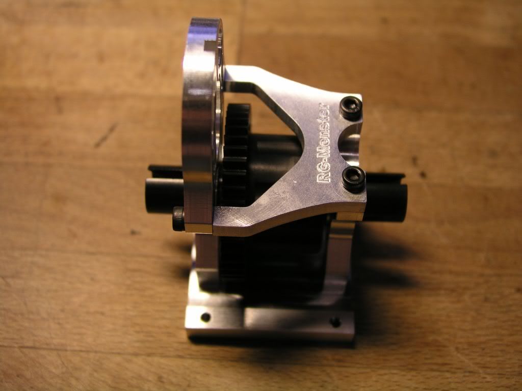

Well with the maxx chassis it is bolted right in the place where normaly the transmissioncase sits. But I think this could become an issue with the gorilla-revo-chassis as bigger/longer motors would most certanly collide with the rear shocks.
But never had a G2/3R chassis so I don't know for sure...
Nothing has changed. The shape of the gorrilla chassis can fool you.
Rivermaxx 07.17.2009 03:28 PM
I guess the lower plates are the only difference. Ones for a maxxx style chassis (top) and the other is for a g-maxx style .
http://i153.photobucket.com/albums/s...permaxx/dm.jpg
http://i153.photobucket.com/albums/s...motormount.jpg
I want one bad! it isnt fair!:cry: lol

It might be worth seeing if MetalMan or Serum can help you out- they are both talented custom builders in their own right- look in Serum's photo album and you'll see the earliest examples of the G2 / G2r specific motor mounts of this type that he worked on along with Mike (there are also threads to match floating around someplace...):
http://picasaweb.google.com/buikpijn/RevoCenterdiff
