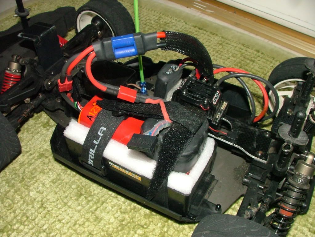

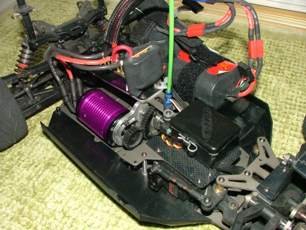

Here's another update.
I've been running the RX8 ESC on 4s2p A123 in the GTP geared 51/20 with the 4000kv hacker. Everything was okiedokie, but topspeed was not the same like the 6s1p A123 pack. So I ordered the 25T pinion from Mike and the GTP became an animal again...for like 2 minutes. I thought the RX8 smoked, but all was good and the motor plugs were all unsoldered. Soldered on 6.5 connectors instead and ESC kicked butt again. I need to datalog the sucker and see how many amps it's consuming.
Motor wires are 12awg, and battery input wires are 10awg.

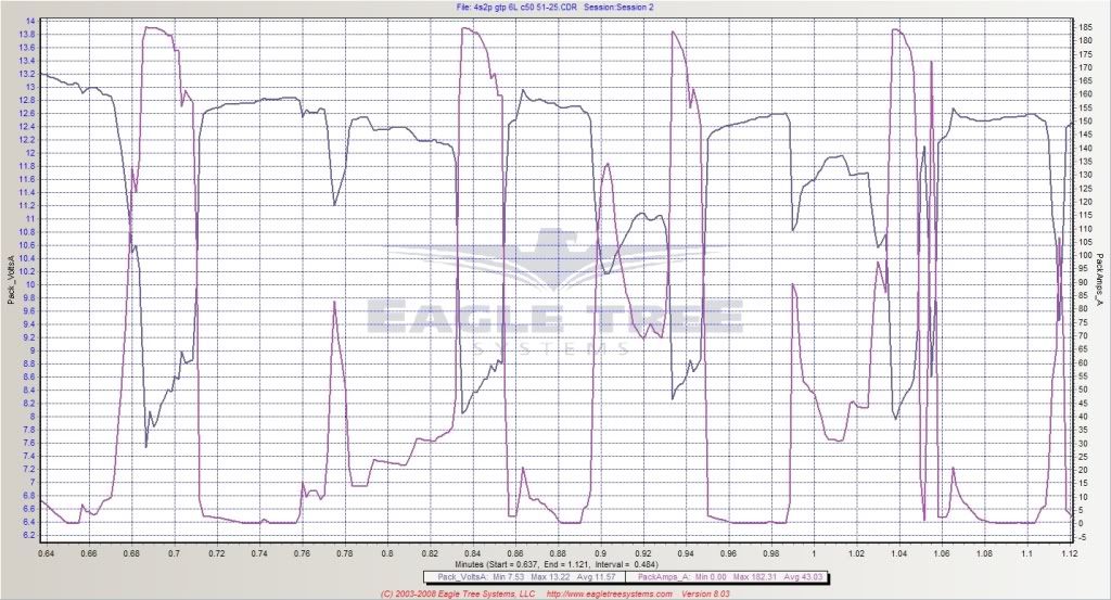

snellemin 11.11.2009 01:32 PM
Here's a snipped of the datalogger. I pull about 159Amps @ 8.68V right before I brake.

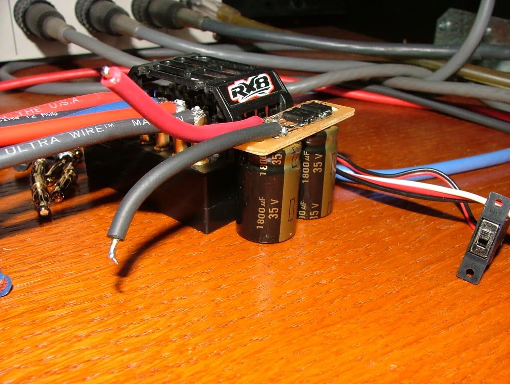

snellemin 03.06.2010 10:45 AM
Wow, I don't remember what size caps I used. I'm thinking they were 3 1000uF 35V ones and a pair of tvs's. On my other RX8 I used 2 1800uF 35V caps and a pair of TVS's as well. I've seen the Etti's cap banks and I think that is the most economical way to go. I would go with the etti-e035-lv cap bank.

florianz 03.06.2010 11:17 AM
Thanks for your reply. But tell me, what's the story about that "electronic board", where the caps are soldered on? Is it against sparks?

So what do you think, using the caps without that "board" would cause problems?

snellemin 03.06.2010 12:17 PM
That "board" is to clamp the voltage down to a certain value, so I don't go over the ESC Voltage limit during hard braking when running at max rated ESC voltage. You can just add caps with out the "board", but use good quality batteries when running at max ESC voltage. This will aid in the reduction of the Voltage spike you get during braking.

ok, thanks. If I understand that right, if I have eg. 36v caps and no "board", the spikes (up to 35) absorbed by the cap can hit the esc and damage the esc.
So adding two 25v 2200uf caps should be ok? I'm runing 5s lipos (esc max. 6s).
