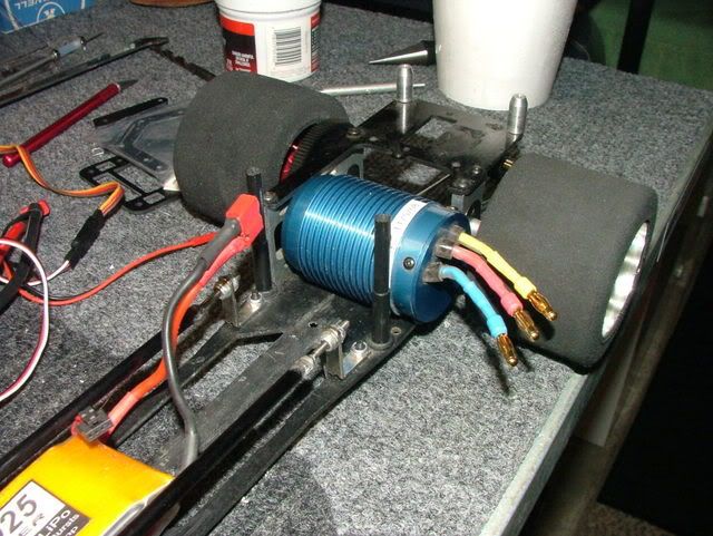

That does it. I'm putting 8MM plugs on my MMpro and run a neu motor in a dragster. :whip:
http://i189.photobucket.com/albums/z...p/DSCF4447.jpg

5mm or dual 3.5mm plugs is the biggest I would go with the MMpro. But nothing beats a direct solder connection. I just wish the MMpro motor wires were a bit longer.
