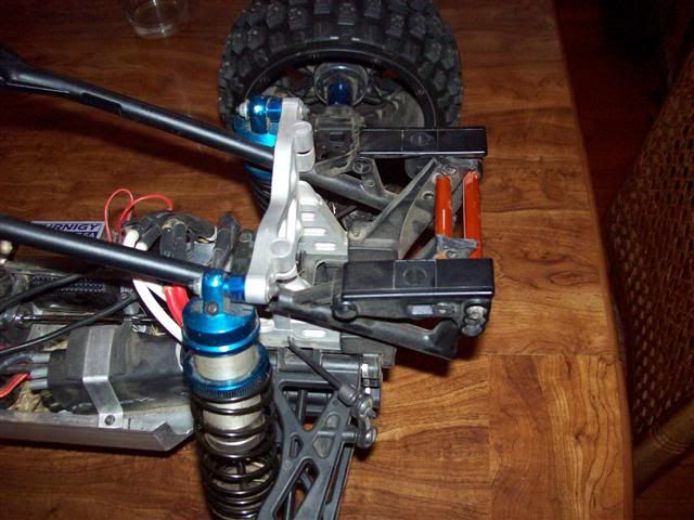

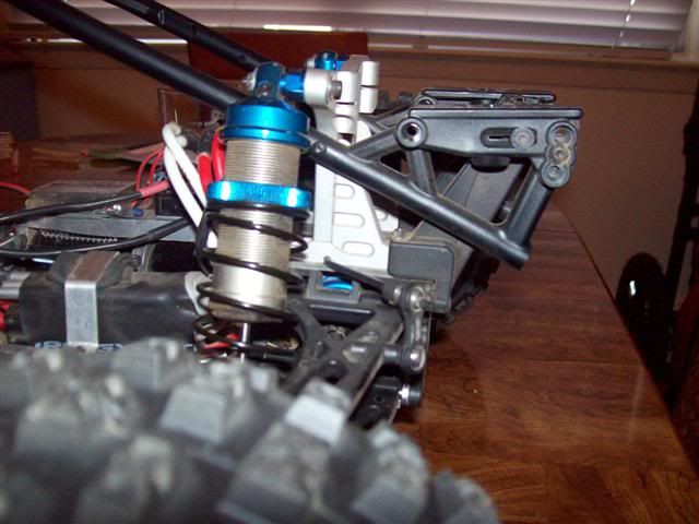

Here's how I attached the baja 5b rollcage and its wing mount to the muggy wing mount for what I think is a very sturdy wing mount (I'm waiting on a baja wing in the mail - I put a 1/8 wing on it but it looked too small).
I cut the muggy wing mounts and drilled holes through them for my extra orange tube (from the stock baja 5b rollcage) to fit through and screwed through the baja wing mount.
http://i779.photobucket.com/albums/y..._4503Small.jpg
The baja rollcage is also attached to my rear aluminum shock tower with one screw on either side:
http://i779.photobucket.com/albums/y..._4502Small.jpg
And you can see my new black rc-raven springs installed (also my custom esc mounting strap).

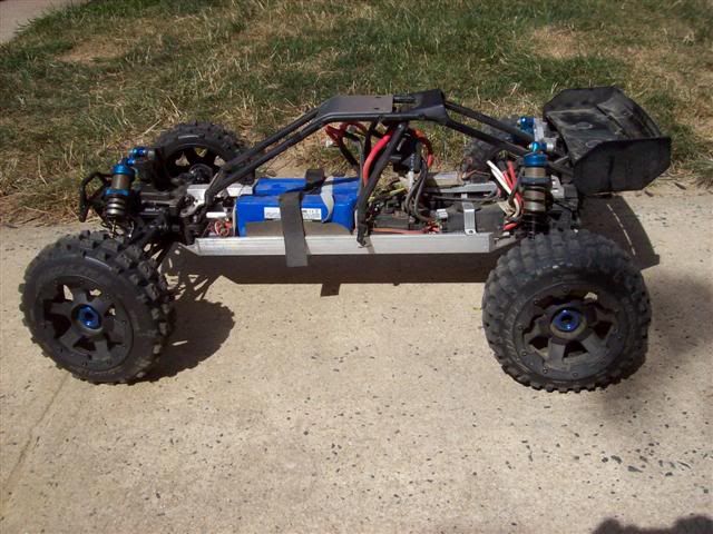

I got the rollcage finished and the wing installed. I took it to the park for the first time and ran through 8s 5000mAh in about 25min geared for 40mph. The oversteer isn't as bad with the rear shocks softened, but I'm going to do some more testing as to how I can reduce it (or get used to driving it). Outside temp today was about 81F. After I was done, temps were:
batteries 98F
esc 112F
motor 132F
I will gear for higher speed on 8s and give it a try.
Here it is, finished:
http://i779.photobucket.com/albums/y..._4505Small.jpg
edit: I looked at my new rollcage mounting brackets in the center after driving it and rolling it only once - and they're bent. So instead of 1/8" Al angle brackets, I guess I'll go to 3/16". Well, now that I'm finished building the truck, I guess I'll start fixing it.

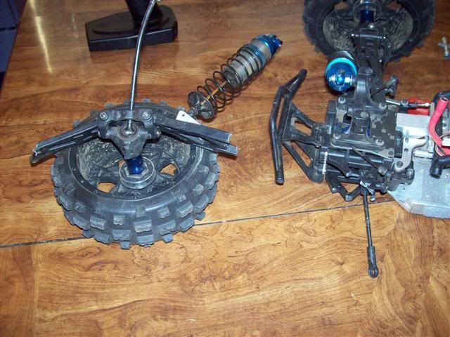

First carnage
I was driving on some soccer fields, getting it up to full throttle for some speed runs across the field. The grass is very dry and dusty - poor traction. So I was about to finish up, but did a couple more runs, the last of which, I thought I had everything under control, but drifted a little at high speed - into the soccer goal post. :oops:

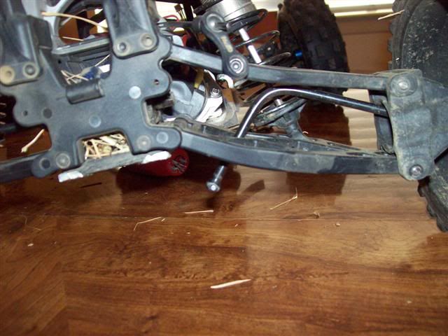

I was expecting major damage as I saw one wheel + other parts flying in one direction and the rest of it in another. So I was happy to see it was mainly the plastic arms that broke and a bent driveshaft:
http://i779.photobucket.com/albums/y..._4511Small.jpg
Then I got home and saw the right rear driveshaft :surprised:
http://i779.photobucket.com/albums/y..._4512Small.jpg
Those arms are bent and need replaced too. Luckily I have a box of extra arms and other parts - I'll have this back together to take it out tomorrow. :yes:
