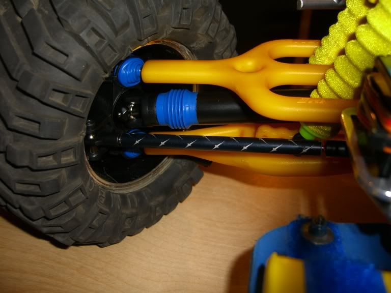

jhautz 08.05.2006 09:39 PM
Well I installed the rpm arms for the 3.3 and they work perfecty. On the tallest bashing suspension setting, its really close clearance between the 3.3 driveshafts and the arms with the suspension completetly extended, but it clears and I cant make the axels rub the arms even if I force the suspension to over travel down by hand. Looks like it should be really solid.
I like this conversion.

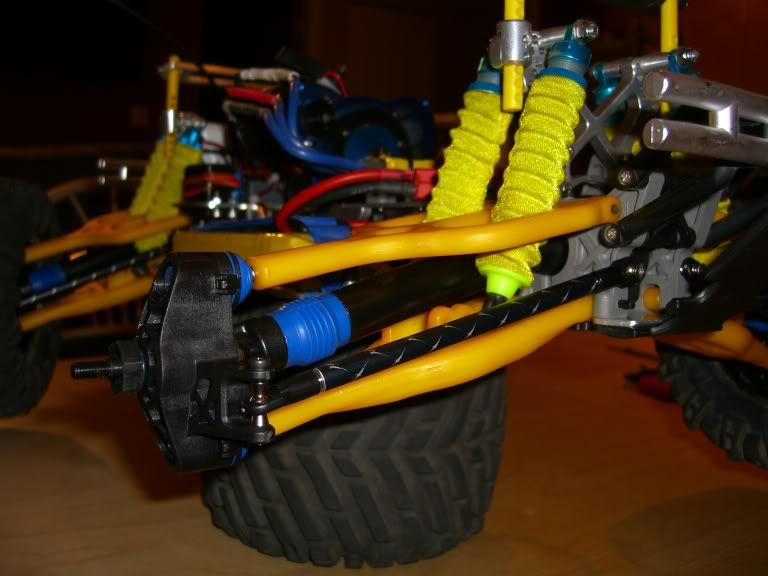

jhautz 08.08.2006 12:19 AM
This is it. Finally all went together and works nice.
Sorry... Pictures are kinda dark and cr_py
http://i66.photobucket.com/albums/h2...z/CIMG1294.jpg
http://i66.photobucket.com/albums/h2...z/CIMG1292.jpg
http://i66.photobucket.com/albums/h2...z/CIMG1291.jpg
coolhandcountry 08.08.2006 07:29 AM
Where did you get the turn buckles from?
I like them. It looks good. I think the pics turned out nice.
It looks wider now. Let me know how it handles since the improvement.
I piced up another emaxx for a conversion like this. :D
I couldn't afford it but had something brother wanted for it.
squeeforever 08.08.2006 10:36 AM
Very nice! Coolhand, I believe there from JD Carbon.
jhautz 08.08.2006 11:15 AM
Yes. JD Carbon Turnbuckles. I also have JD Carbon Hinge Pins in it. Really tough stuff. And LIGHT!!! Really Light. Makes Titanium look like lead.
You can kinda see them in the top picture.
