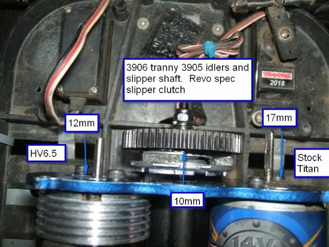

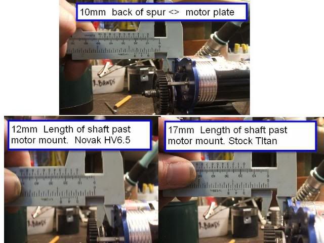

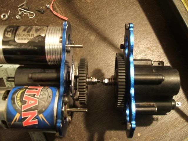

Before any asks. No, that is not the motor setup I am running. Just a couple of pictures I said I would post. Somebody might find then useful. Was just messing around but it shows the 3906 transmission case w/ the 3905 slipper shaft used and the Revo Spec slipper. I put a stock titan on one side and a Novak HV6.5 on the other to show the shaft length.

Man that looks clean. The spur does look better setting farther back. To me it looks correct setting back like that. The pics I posted above were just a FYI for anyone that might want to used the 3905 shaft and leave it the original length. I drilled the exit hole on the other side of the case. You can see it in the second picture. If you change spurs a lot that hole on the end of the shaft sure makes it easier. Next time I have my evo apart I might do what you did. The neu has a long shaft so it works well as is but I like the trimmed look. Did you use the revo shaft on yours?
