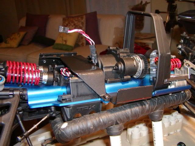

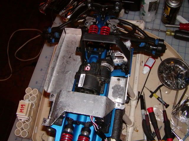

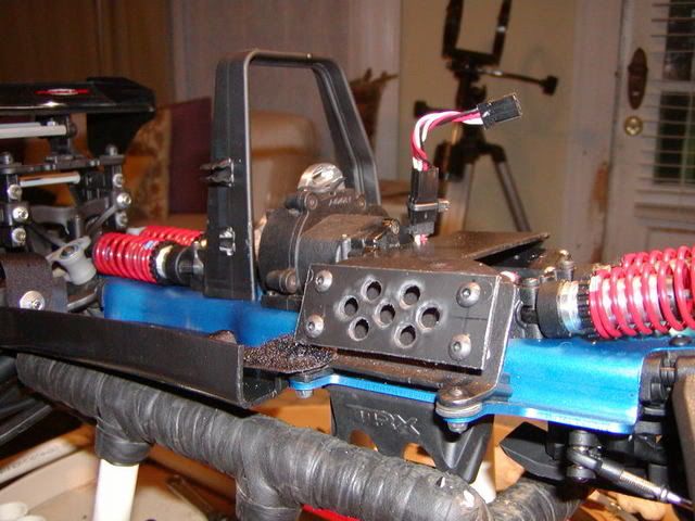

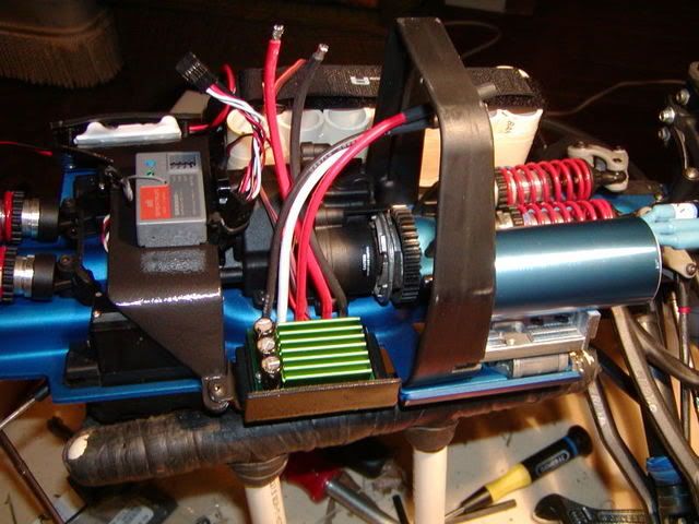

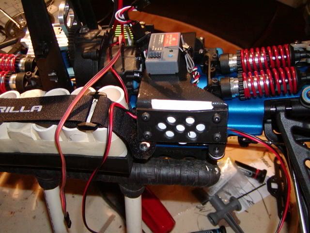

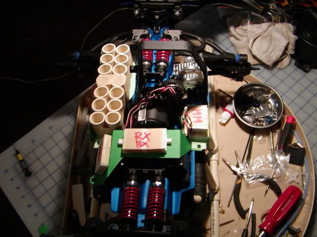

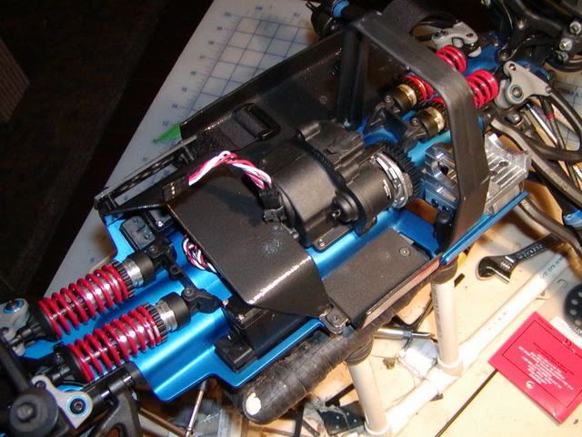

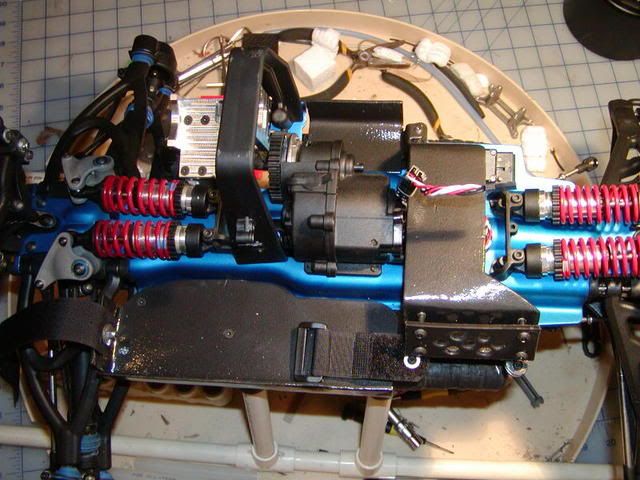

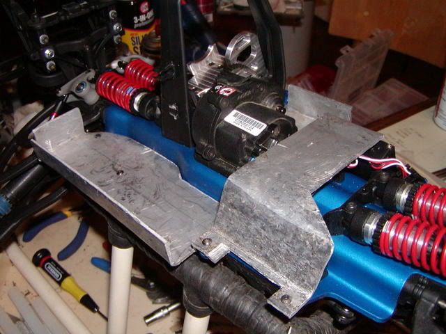

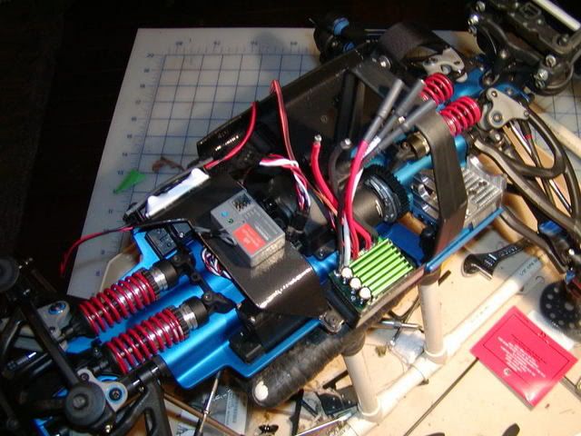

Cajun 05.03.2007 08:58 PM
Here's some progress photos:
Paper mock up of trays and mounts:
http://i128.photobucket.com/albums/p...perMockUp1.jpg
Aluminum beat into submission:
http://i128.photobucket.com/albums/p...uminumFab5.jpg
http://i128.photobucket.com/albums/p...uminumFab7.jpg
Trays and mounts sanded, painted and bolted in place:
http://i128.photobucket.com/albums/p...on/Mockup1.jpg
http://i128.photobucket.com/albums/p...on/Mockup2.jpg
http://i128.photobucket.com/albums/p...on/Mockup3.jpg
http://i128.photobucket.com/albums/p...on/Mockup4.jpg
With electrics sitting in place:
http://i128.photobucket.com/albums/p...on/Mockup6.jpg
http://i128.photobucket.com/albums/p...on/Mockup7.jpg
http://i128.photobucket.com/albums/p...on/Mockup9.jpg
Stay tuned, more to come!
BrianG 05.03.2007 09:10 PM
Good job man! That's a very different setup!
What did you end up doing with the tranny (lock into second, keep 2 speed, etc)? Also, is that Hammered finish paint I see? I love that stuff - it makes a nice hard finish.
Cajun 05.03.2007 09:24 PM
Thanks Brian! The idea was to get it as compact as possible. I want to be able to use a stock body without it being pushed out. The batt tray should accompdate up to 16 cells. The only drawback to the configuration I see is that I'm going to have to lengthen the ESC to motor leads by a few inches.
I locked the tranny into 2nd using your method. That is Rustoleum Hammered finish paint. I love that stuff too, nice and hard plus it hides all the imperfections better than any other spray paint I've found.
I have a couple of little things coming from Tower to finish the setup, then I'll be ready to run.
