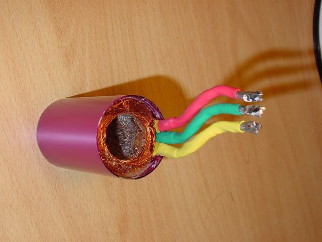

Hey mike. THe winding you said you think i scuffed. It must have been on them because they are all twisted up in side. I don't think they supposed to look like a rainbow. You think it is junk.
coolhandcountry 07.10.2005 12:19 PM
If you every have anyone mike that knocked the end out of motor. I put a small dab of glue on it. It held up much better. Never come out until I knocked it out again.
RC-Monster Mike 07.10.2005 12:20 PM
Hard to say without seeing it.
coolhandcountry 07.10.2005 12:51 PM
It is not much doubt in my mind mike. They are not consistant. They have a bad bow in the middle. I has cracks in between the windings to. I think it is toast.
RC-Monster Mike 07.10.2005 12:59 PM
It is normal for the coating on the internal windings to seemingly be "cracked". If the coating is worn away or discolored, there is likely a problem, though.
coolhandcountry 07.10.2005 07:22 PM
The winding them selves are all messed up. The look like a snake cause of the curves. It is not the same through the whole motor. They are different form side to side. The timing can't be right cause the winds will engage at different times on different parts of the shaft. If you know what I mean.

sure can't serum. I have trashed it. It was mussed. Not a doubt in my mind. It looked like you took and twisted the winding in one spot.

Anyhow, here's how my dead 9L looked. Not the windings died, but the magnet split, as some might remember
http://img.photobucket.com/albums/v313/duffnee/BL_3.jpg
RC-Monster Mike 07.11.2005 05:12 PM
thanks for the picture, Daf. The grey color on the windings is likely due to the rotor rubbing on them when it split.
Coolhandcountry - The motor has no timing. The controller does the timing on a sensorless system.

You see How the windings are in daf's motor that is what they look like only worse with out the grey. If the windings are not where they supposed to be. Then the Force on the rotor will be applied at wrong time. Thus throwing the timing out. If some of the winding starts to push the rotor and the rest has not come close. You know me means.
RC-Monster Mike 07.11.2005 06:55 PM
Do the windings move inside the can(can you spin them?)?
coolhandcountry 07.11.2005 06:58 PM
I not going to worry with it mike. I took rotor out. Pitched the rest. It was touch the rotor some. So it was wrong some where. I just buy a new one. Just have to figure out what i going to get this time.
