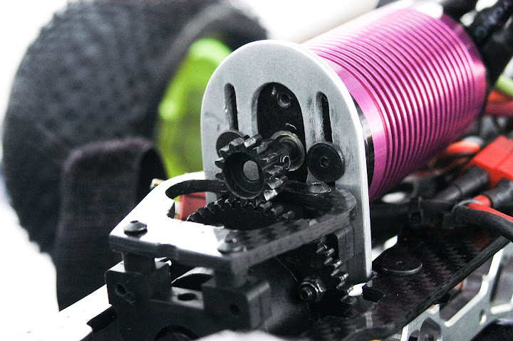

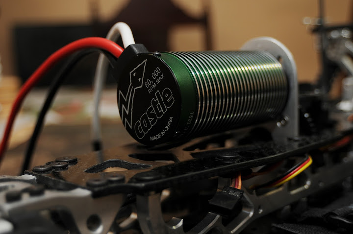

An update... I recently employed a CC Mamba Monster for my truck the when the Quark 125B went up in smoke after one of the
Caps got loose and shorted it out... Also... my new Lipos are finally here... I am now running the truck on Turnigy 40c, 4000mah
2s and 3s... I am loving this new power combination... I did notice that the Quark was still much smoother on slow starts than
Mamba Monster... On roll off, the Monster cogs noticeable... but when the trigger is squeezed, the Monster puts out... Nice ESC...
lots of power and who lot of features to play with. Oh... I pick up a set of Novak Mod 1 pinions (15t, 16t and 17t) off ebay for .99c :lol:
... I am currently running the 16 tooth and it's looking really good so far... Pics and a updated parts list below.
Differential Ratio: 4.3
Transmission Ratio: 1
Other Ratio: 1
Spur Tooth Count: 52
Pinion Tooth Count: 16
Total Voltage: 18.5
Motor KV: 1600
Tire Diameter (inches): 5.65
Tire Ballooning (inches): 0
Motor Current Draw: 0
Motor Coil Resistance: 0
Spur/Pinion Ratio: 3.25 : 1
Total Ratio: 13.975 : 1
Tire Circumference (inches): 17.75 inches (450.85 mm)
Rollout: 1.27:1
Total Motor Speed: 29600 RPM
Vehicle Speed: 35.6 mph (16t) | 33.38 mph (15t) | 37.83 mph (17t) | 40.05 mph (18t)
Effective KV Value: 1600
On the truck:
electrics/power
CC 1520 1Y 1600kv
CC Mamba Monster
Airtronics steering servo (94359)
Airtronics 3ch Receiver FHSS 2.4 GHz MX-3
chassis
Custom carbon fiber upper and lower plates
FLM Aluminum bulkheads
FLM Aluminum chassis brace
Hardcore Titanium skid plates (front and back)
Unlimited Engineering monoblock chassis extension
suspension
Pro-line steering/servo saver
pro-line 23mm Velocity wheels with 'Slicks' and Badlands
Unlimited Engineering Widetrac Control Arms
Unlimited Engineering shock towers
Unlimited Engineering Supermaxx shocks X 4 (blue springs in front and blacks in the rear)
40 Series USE Hot Racing hubs (23mm extension nuts)
Aluminum knuckles
drive train
Custom CD/Motor mount with a OFNA Spider center diff
Unlimited Engineering diff ultralite 7.5 housing
Unlimited Engineering drive cups
Hot Bodies Lightning Hardened Differential and Pinion
HPI Savage XL center drive shafts/dogbones
MIP CVDs all around
Pro-line 23mm hex hubs
Pinions - Novak 15t, 16t, 17t and RCM 18t

ANGRY-ALIEN 08.02.2010 03:42 PM

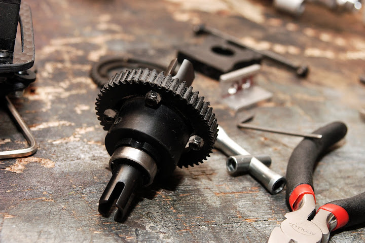

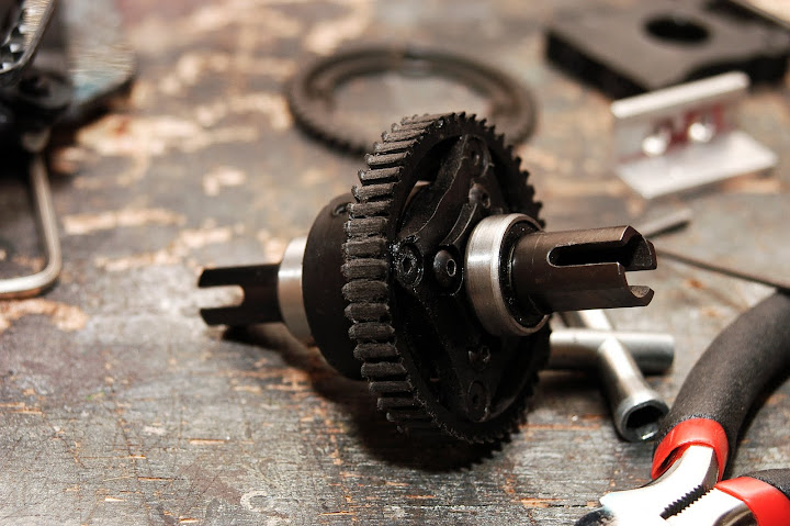

Did a run today to see what kind of temps I would be getting from the new setup... the bash session went on for about 25 minutes...
Lots of long 'high speed' passes and hard braking too... it's quick... a ton of torque got to the rears pretty quickly even when the
diff unloaded to the fronts, resulting in some really cool launches from a standing... braking was great... I think I can still turn
down the percentage to reduce locks ups... see the below temps...
ESC - 30% punch control | 3.5v per cut off | 50% reverse| 50% braking | 125°
CC 1520 1y - 17t Novak | 140°
OFNA Spider diff - 50wt oil (half full) | 168°
Batts - 105° average
Bow-ties - (now tread free :lol:) 130°
I am really happy with the setup at this time... but it will need some more work...
Alien

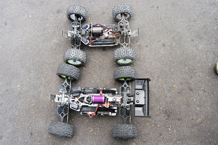

RC toy 11.27.2010 04:44 PM
Hi. Any upgrades? What's the thickness of FLM braces?(red line in the picture)
http://www.part.lt/img/854b9696c4a55...443b0f6709.jpg
ZippyBasher 11.27.2010 09:57 PM
6mm...
ANGRY-ALIEN 11.28.2010 01:39 PM
Hey Rc Toy, I measured the chassis brace and got 7mm... regarding upgrades, I recently with some help from Zack got the 'Motherlode' suspension repair kit from UE and
rebuilt the shocks...I saw big improvement in dampening and balance of the truck during acceleration and deceleration... I also employed a set of RPM knuckles with 15mm bearings...
I have done an extensive test with them yet for me to give a feedback... I'll throw the truck around as soon as i get some time and you'll know how well it works out...
Alien

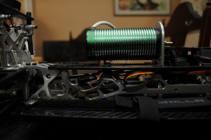

ANGRY-ALIEN 03.30.2011 01:22 AM
Making a small update... I added some Losi sway bars this weekend... it was not the easiest mod so far, but i had fun doing it... didn't make any runs with the truck yet,
so I have no feedback regarding performance... the sway bars are also being used as 'limiters'... I had some issues with the shocks shafts popping out of the balls ends
whenever the truck had a rollover... see the below pics... I will make some more updates on this soon...

Kcaz25 03.30.2011 12:24 PM
Cool man! I can't wait until you get some behind-the-wheel feedback. When you lift up with your hand on one wheel does the other side come up aswell? Does it move any? Mine moves slightly. I wonder if the wire is too stiff on mine. I'm not sure.
My Maxx has been at home for several months while I've been away at school. I can't wait to run it on the upcoming spring break. I still have to install the front sway bar.
-Zack
ANGRY-ALIEN 03.30.2011 01:05 PM
-Zack
Hey Zack... the mechanics of the layout works well... but i think the bars are a little thin to make good influence with the heavy springs installed on the shocks...
for 1" of movement I make with one arm, I get about 1/4" of travel on the other... I am currently using 2.5mm and 2.7mm bars for now... I am going to do a search
for some 3mm or 3.5mm spring steel to see if the movement can be increased further...
Regarding your setup... I did try a similar orientation to yours, but i noticed that the angle of the bar did not allow for enough leverage... The bar had little movement...
Did you try to see what kind of movement you would get with the shocks off? I looked at a few setups from different makes and they all seem to have the same orientation,
perpendicular to the suspension arm...
I'll see if i can get the truck together this week for testing...
Alien
Kcaz25 03.30.2011 02:26 PM
When comparing my setup to my cousins Losi 8t my bars actually have more influence. I can't remember if I've tested with the shocks off. Remember mine is attached to the lower arm. I'll have to get some better shots when I install the front as well. Long live the Maxx! Right? I love it. lol This has gotten me anxious to get my hands back on it.
ANGRY-ALIEN 03.30.2011 03:42 PM
I see... I actually looked back at your post with bar installed... I am not sure why you are getting this problem then... btw, how thick is your sway bar?
looks beefier than mine... I am more likely needing something with that diameter...
:lol: Long live the MAXX in deed... I have seen recent posts on this forum that people are still investing in them... I have enjoyed this truck for so
many years and I am sure I will continue to... :yes:
Alien
