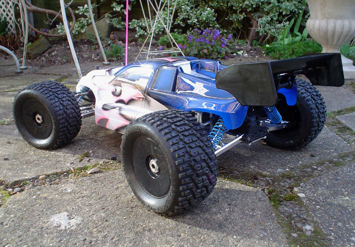

Hard to tell, but you also used small chrome contrours too, right?
Candyman2 03.22.2009 04:17 PM
yeh chrome around the edges
http://www.ukmonsters.co.uk/lsp/lsp-33.JPG
http://www.ukmonsters.co.uk/lsp/lsp-34.JPG
http://www.ukmonsters.co.uk/lsp/lsp-35.JPG
