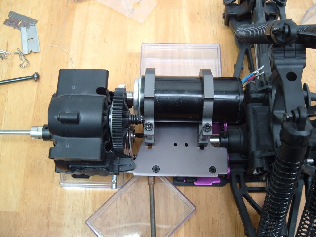

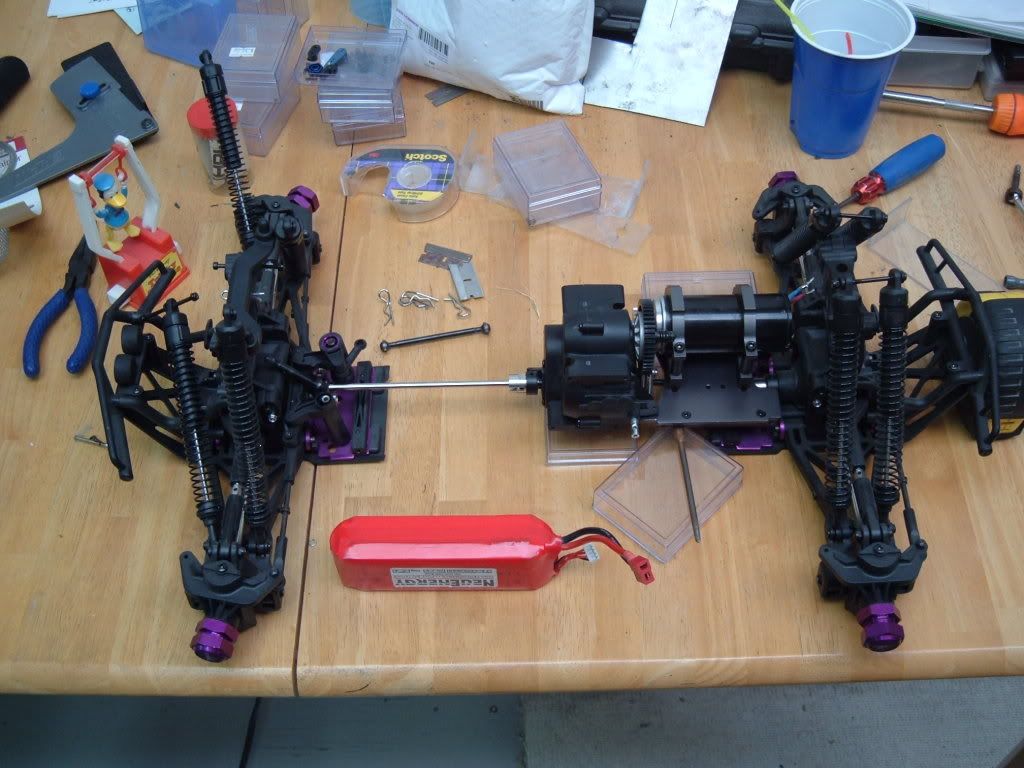

1offrc 05.20.2009 12:46 AM
extended flux xl
I'm going to paint the rims black and the Orange TVP's will match the proline beadlock rings

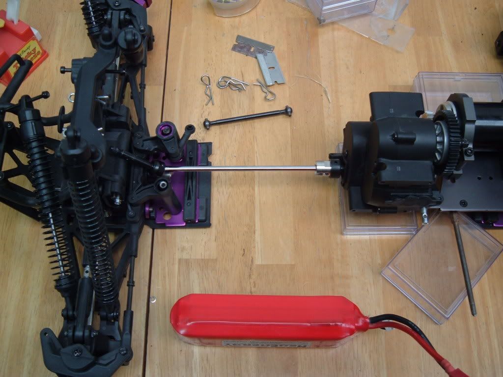

1offrc 05.20.2009 01:31 AM
streched flux
ahh a all blacked out flux would be so stelth and ez to paint body mask windows and spray black
