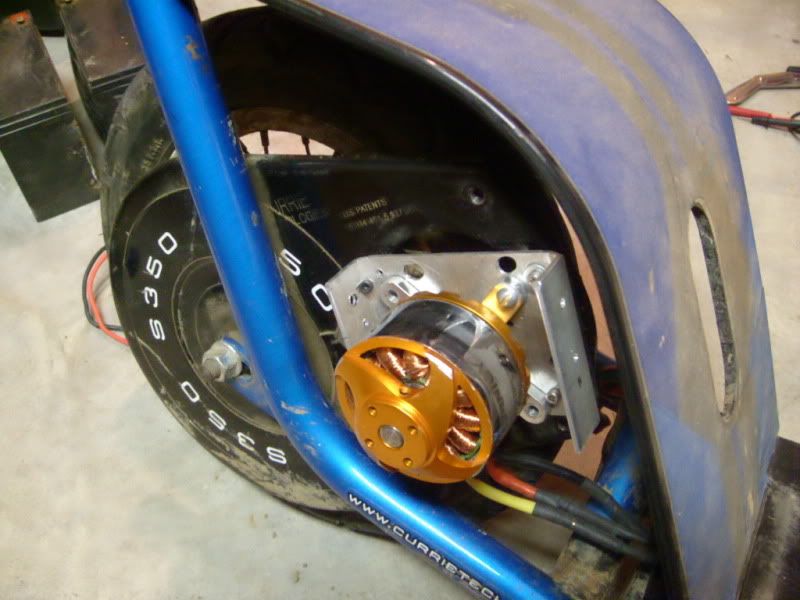

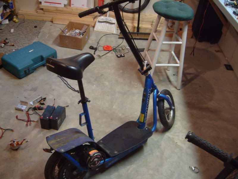

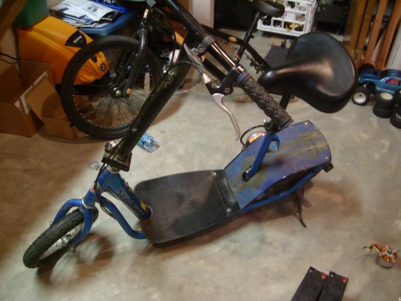

Well last night I took a look on craigslist. Someone was selling a scooter for $25. After a few communications, they said they wanted to do a gas conversion. I threw a trade out there for my mini-bike as a roller and they took er up. I went and got it this morning. Everything is good except for the batteries. I am going to put my BL electronics on this scooter. :yipi:
It should be more efficient with the skinnier tires. It has better brakes and an optional seat. It has a larger "spur" so top speed will probably be slower.. Let's see how it turns out.

I just got er all wired up. Works perfect! my gps tells me my top speed was 16.2mph... Not to impressive. :sarcastic: The batteries measured 23.5v at the end of the run. I hope I can crack 20 or so with some lipos...

I forgot to mention there is no losing sync or cogging! :yipi:
I have pretty noticable acceleration. I have to put one of my feet on the back and push myself forward or else I fall backwards.
And last night I went to test it after I charged the batteries, and it didn't turn on. I think the servo tester is getting too much voltage, the battery is around 12.5v. I'll need a new way to power the servo tester. I'll have to use a bec, especially after I get lipos.

I just took it out with fresh batteries and I got 19.3mph. With the added power I need to accelerate slowly or something starts rattling real bad. Maybe it's the motor starting to lose sync... It had noticably more power and a pretty acceptable top speed. It would beat the stock scooter for sure. Looked it up and the stock is supposed to be 15mph. I would say 19mph is pretty fast, which is probably why the stock doesn't go that fast.
With some lipos I expect a full 20-25mph after what I saw tonight. Possibly more if I risked 7s.
