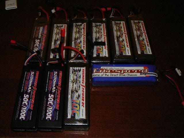

My default is a 3S 40C/80C 4200mAH Thunder Power pack, but something tells me that I should be able to get away with a 40C/8C 5000mAH pack with this motor if the track can hold the power.
Edit: FYI, here's all the batteries I get to play with at any given race (their's another 3S 4200 40C pack in my dragster that I didn't take out for the photo). I run three classes if possible so I need to have these options for best results.
http://i256.photobucket.com/albums/h...40242Small.jpg

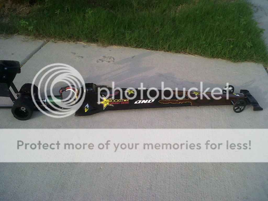

yep , went 1.36 with the 1406 7700 testing yesterday, The motor is very smooth and very consistent, I am at a little disadvantage since there is no gear changes I can make since I have a dd car but i changed tire size and it helped, haven't played with timing yet but so far I am very happy with it and I am sure there is more in that beast. Not sure if I can make it out next week or not but if times get better I will let yall know.
here is a pic of the car that the motor is in now.
http://i756.photobucket.com/albums/x...TkxNS5qcGc.jpg

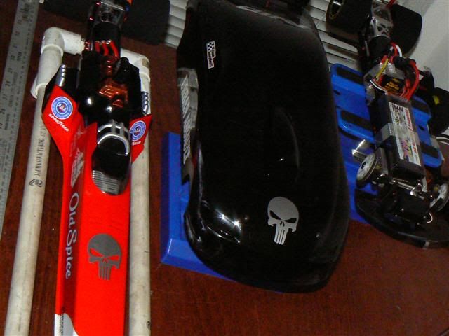

OK y'all, this week is Autorama and I'm getting stuff ready for the event. I can't wait to run the 1406-7700, and I get to do it for 4 days!!!
Funny car with the 1406-7700 is on the right, body off, battery on.
http://i256.photobucket.com/albums/h...40244Small.jpg
Team SunnyHouTX AKA Team Punisher
