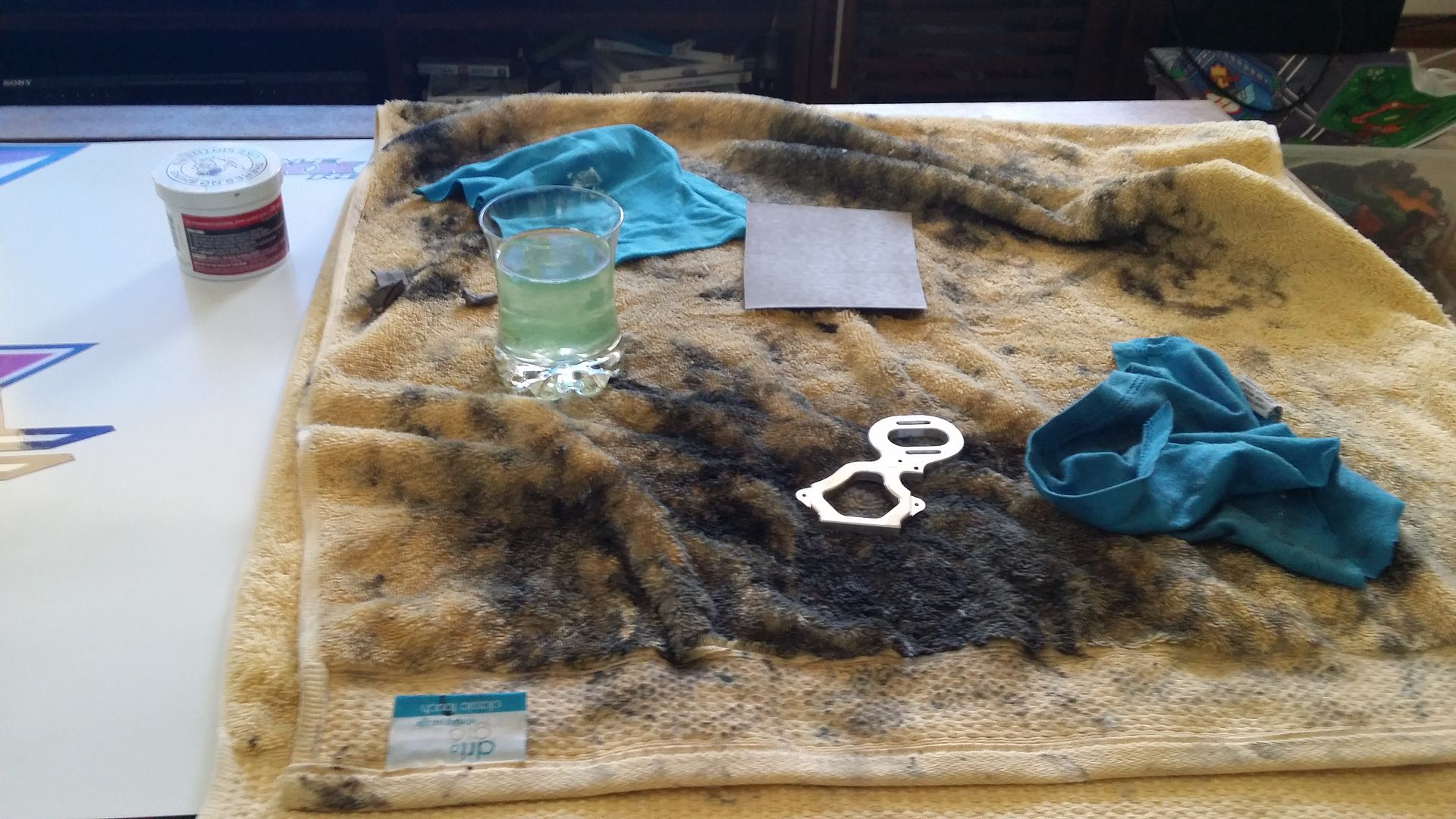

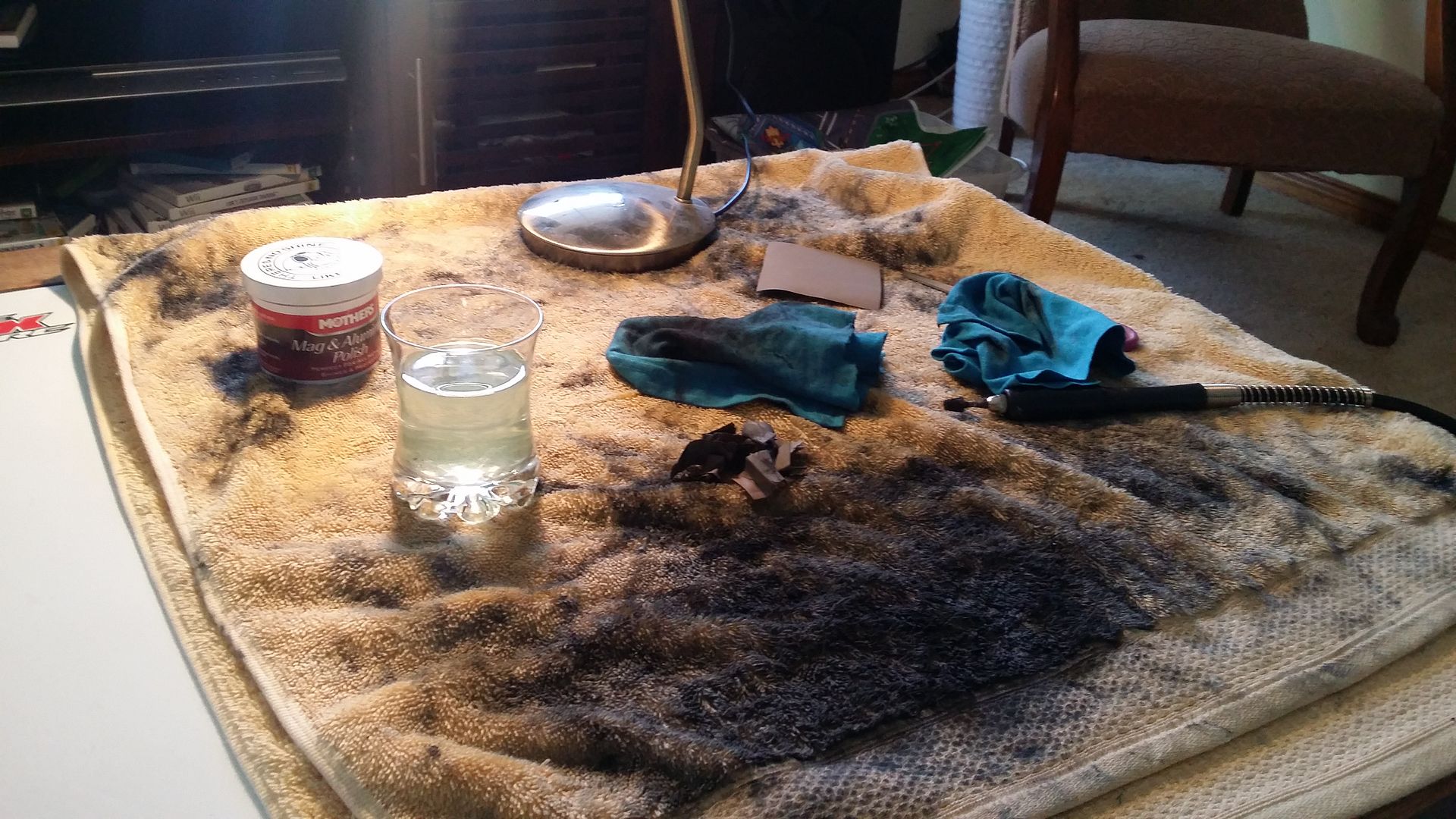

DarkSammy 11.06.2015 11:58 PM

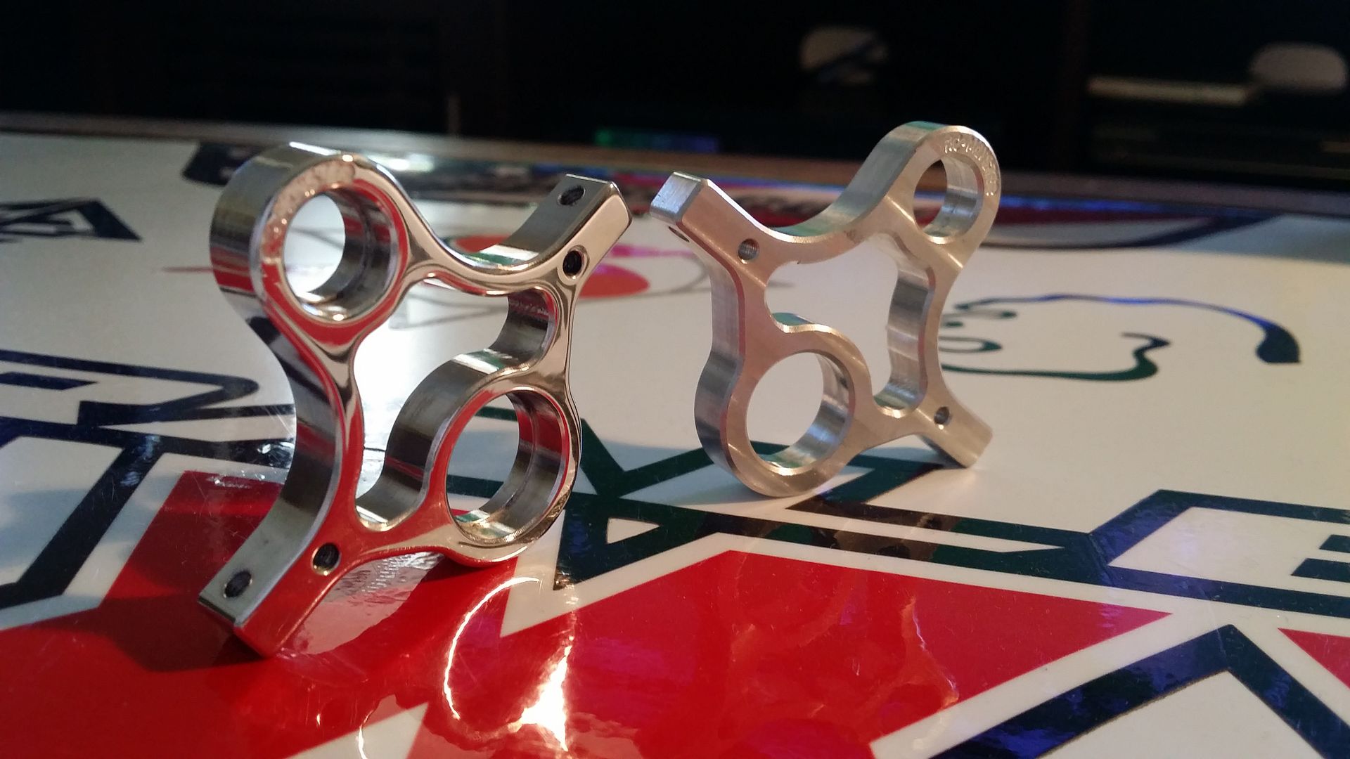

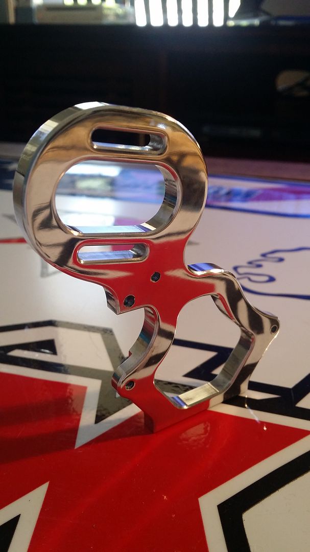

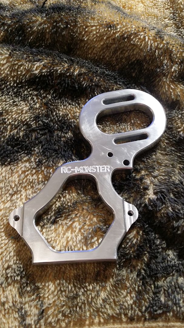

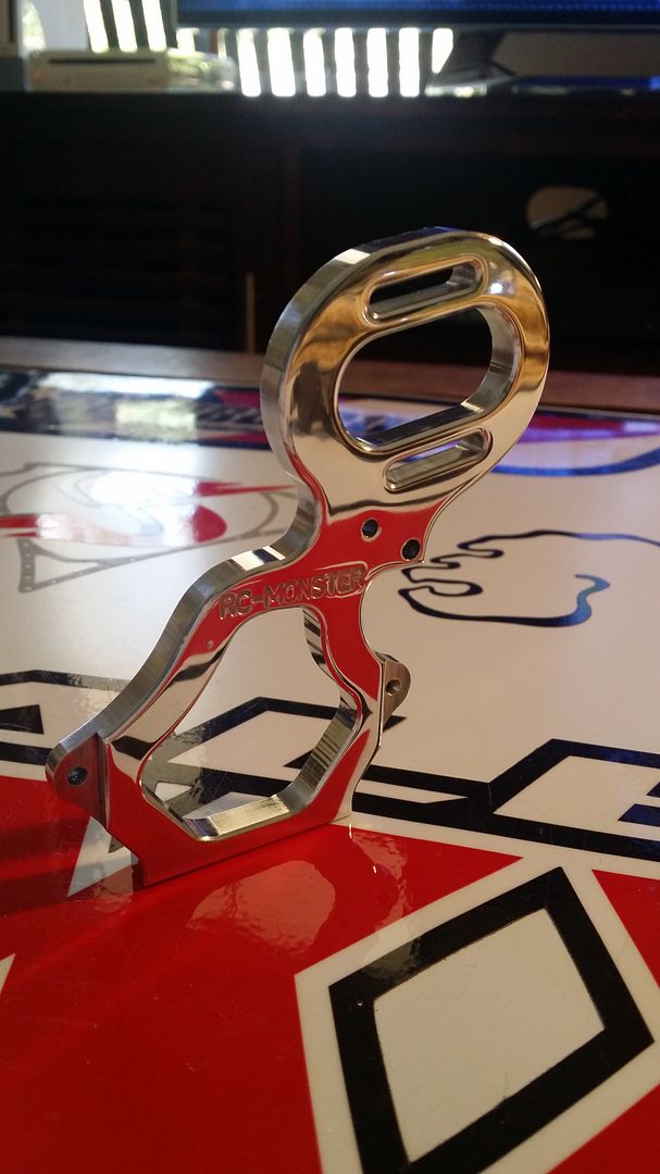

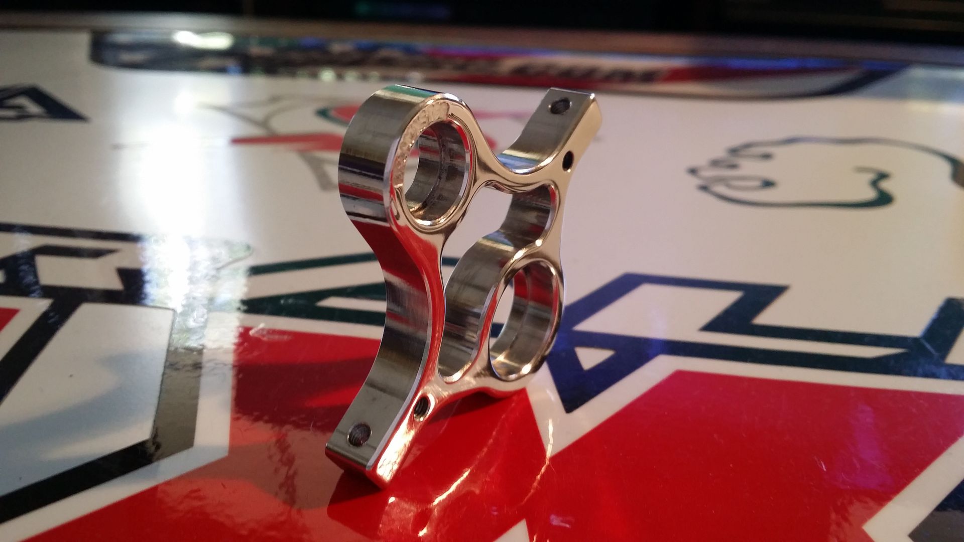

Ever wondered what 4 hours of your life looks like?
Before:
http://i1186.photobucket.com/albums/...106_202932.jpg
During:
http://i1186.photobucket.com/albums/...106_215206.jpg
http://i1186.photobucket.com/albums/...107_130356.jpg
After:
http://i1186.photobucket.com/albums/...107_141919.jpg
http://i1186.photobucket.com/albums/...107_141935.jpg
http://i1186.photobucket.com/albums/...107_142004.jpg

Thanks guys. @Tinuss, sell me a pair of carbon straps and I will polish yours to a mirror finish, deal? ;-) I think the G1 would look awesome with a pair of carbon straps, am not happy with the purple straps that are on there now...

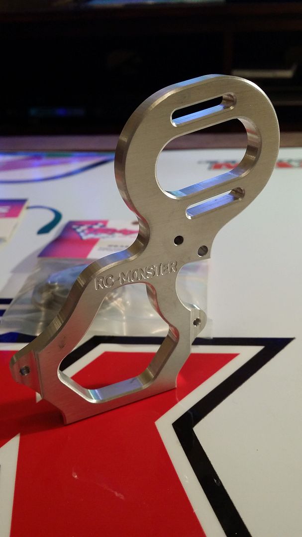

DarkSammy 11.08.2015 01:41 AM
More work done today, unfortunately will need to wait till next weekend to finish up, have run out of time this weekend unfortunately.
http://i1186.photobucket.com/albums/...108_152530.jpg
Comparison pic for Ralf with what I could do to his ;-)
http://i1186.photobucket.com/albums/...108_152559.jpg
Mr E-Maxx 11.08.2015 04:13 AM
Wow! Your polish Skills are incredible!

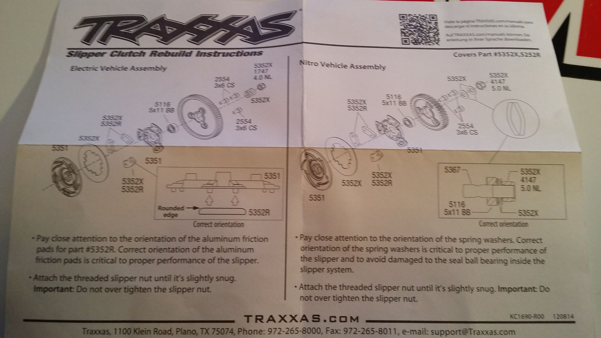

DarkSammy 11.13.2015 04:37 AM

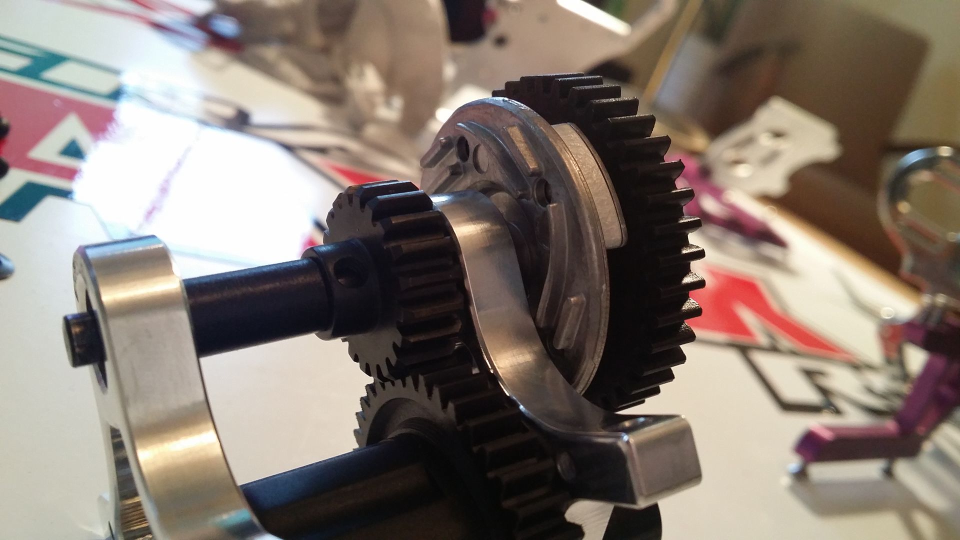

Ok so some help needed if that is ok. Following the traxxas slipper assembly instructions, it just doesn't seem to match what I see in Serum's assembly pics.
Here is what traxxas shows the setup should be as:
http://i1186.photobucket.com/albums/...113_185547.jpg
http://i1186.photobucket.com/albums/...113_185121.jpg
http://i1186.photobucket.com/albums/...113_185041.jpg
But the fins on the outside of Part# 5351 rubs on the RCM Mount. If you take a look at Serum's pics, this part does not seem to have fins....
http://i1186.photobucket.com/albums/...al%20V1/22.jpg
http://i1186.photobucket.com/albums/...al%20V1/25.jpg
It has got me scratching my head. Maybe I'm looking at it wrong, maybe traxxas have changed the design of their part# 5351?
Thoughts?
DarkSammy 11.13.2015 04:46 AM
The more I look at it, the more it looks like part# 5351 has either changed, or this part is different between nitro & electric models. The pic in the traxxas instructions show a difference in the number of fins, yet they have the same part #... If you look at Ralf's pic of his old slipperential as well, it looks like his had only 5 fins, instead of 10 like mine. Maybe I need to order a different kit...
http://i1186.photobucket.com/albums/...1/IMG_0846.jpg
DarkSammy 11.13.2015 04:55 AM
It looks to me there are 2 variations of this part, both seemingly with the same part#.
Looks like the one I got from amain is the wrong electric version?
http://www.amainhobbies.com/rc-cars-...-tra5351/p3376
And the correct nitro one we need can be ordered from Tower Hobbies?
http://www3.towerhobbies.com/cgi-bin...&I=LXHGC5&P=ML
What I don't want to do is go ahead and order from tower, pay $15 in shipping and find out I still receive the wrong one and tower just haven't updated their part pic... Wish it was as easy as picking up the phone, maybe I might shoot them an email before I place the order...
