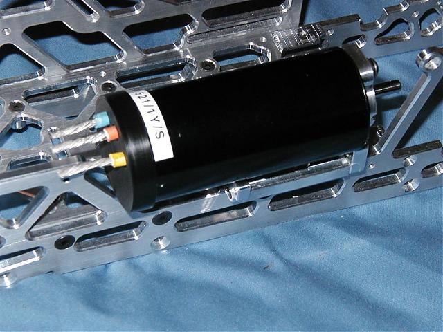

Just started my build and wanted to let people know that a Neu 1521 will fit. Just add a frame spacer under the 4 motor mount bolts and it will lift the motor high enough to clear the rear part of the frame. And of course some Dremel work on the front mount for the 4mm screws the Neu uses.

BlackedOutREVO, a Neu finned will fit fine, you just might have to remove the rear motor support. My motor is not even resting on the rear support, it is just a few millimeters above it. I think the support is only there to help in extreme violent bouncing situations.
David, my Flightpower 6S packs fit fine in the frame. The frame itself is very, very rigid! I was suprised at how rigid it is for its length. It is 6061-T6 and almost 5mm thick. The whole kit is very well made and includes some surprising extras. Like a micro servo mount with appropriate frame holes, so that you can use the reverse module if you want! Bargain for $185.

You think it will clear the chassis? It looks like it wouldnt fit...
Are you going to use the 1521, or did you just test it in there?

It will fit BlackedOutREVO! The pictures do not show small spaces well, so it looks like there is less room than there really is. A finned 1515 will go in easily. Even a finned 1521 will fit. Yes, I use the 1521 in my Savage now with a homemade piece of junk mount. My whole setup is getting moved to this new chassis. It includes the 1521, an MGM 22418, 6S lipo and all three servos. I found a Hitec 65HB to use for reverse. Also, check out HPI's new hardened, machined ring and pinion (#86922). They just came out with it last month and it will be tested to the limits.
