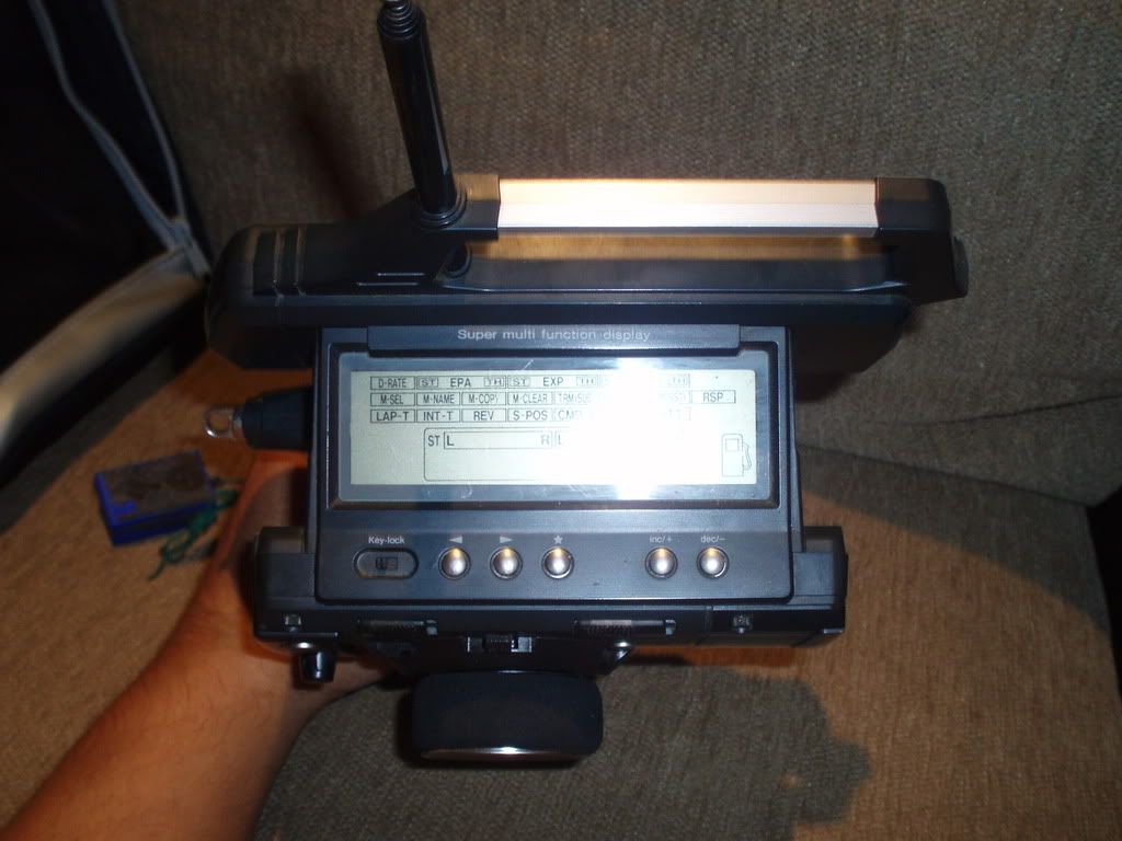

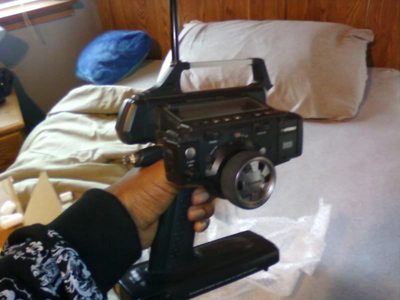

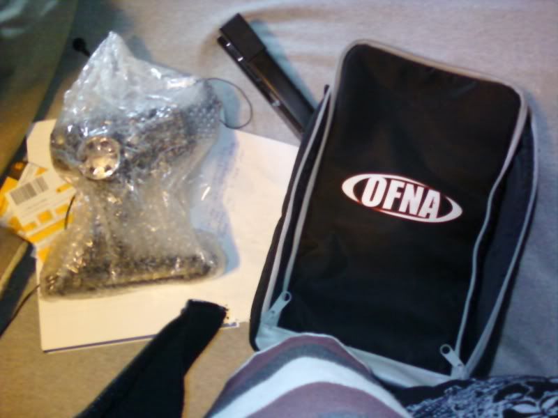

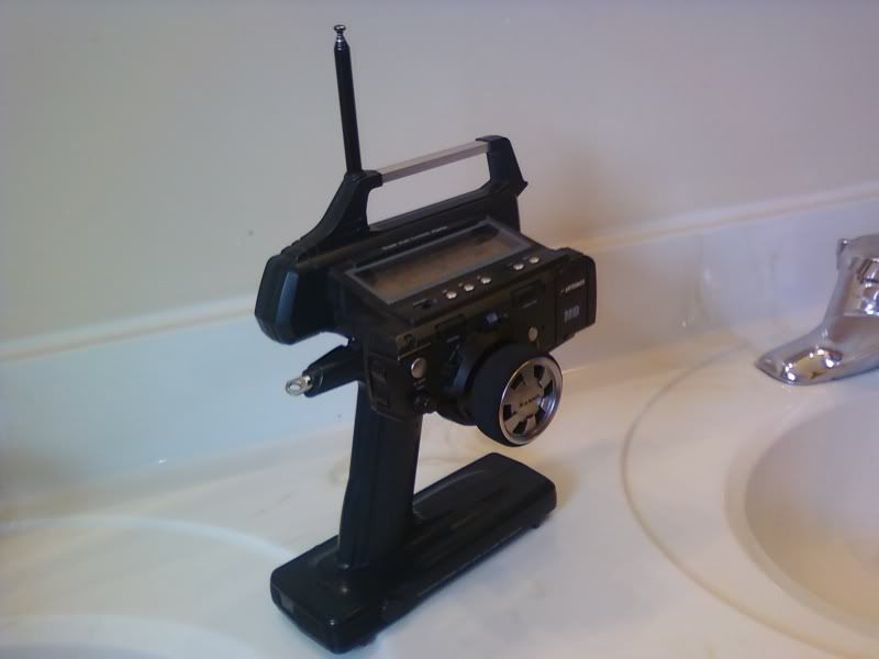

just got another addition, a used AirTronics M8 radio, its 75mhz FM which is what i run in the truck now but much nicer transmitter... 's got stuff like EPA, an LCD display, Dual rates, servo speed chraging jack, 10 model memory....and only $50 shipped

BL_RV0 08.31.2008 01:51 PM
That's a GREAT deal! Is there a way you can find out (for me) if JR and Hitec RX's work with the M8? :yes: Also, if you find any more great deals on M8's or M11's lemme know! :mdr:
brushlessboy16 08.31.2008 02:04 PM
m11 are expensive as Hell, and any rx will work as long as its the same frequency. the only problem i see that the rx that comes with it has "s" connectors where the power and signal wires are flipped- might use my current rx
BL_RV0 08.31.2008 03:52 PM
Actually, my XR3 wouldn't work with Airtronics RX's. :oops:

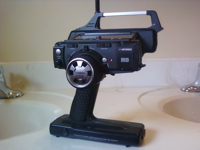

I think this deserves a new post :D
http://i152.photobucket.com/albums/s...0912081458.jpg
http://i152.photobucket.com/albums/s...0912081501.jpg
http://i152.photobucket.com/albums/s...0912081503.jpg
works great, only thing is my lipo that i got for it dont fit... anyone need a 2500mah 3s lipo?

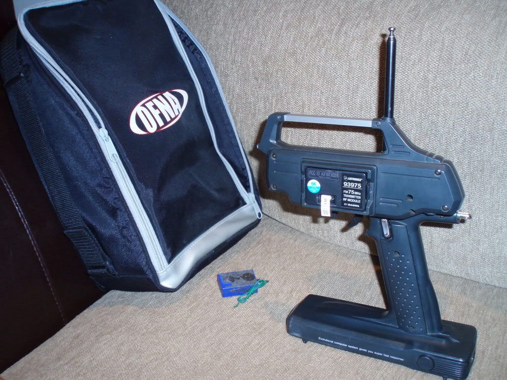

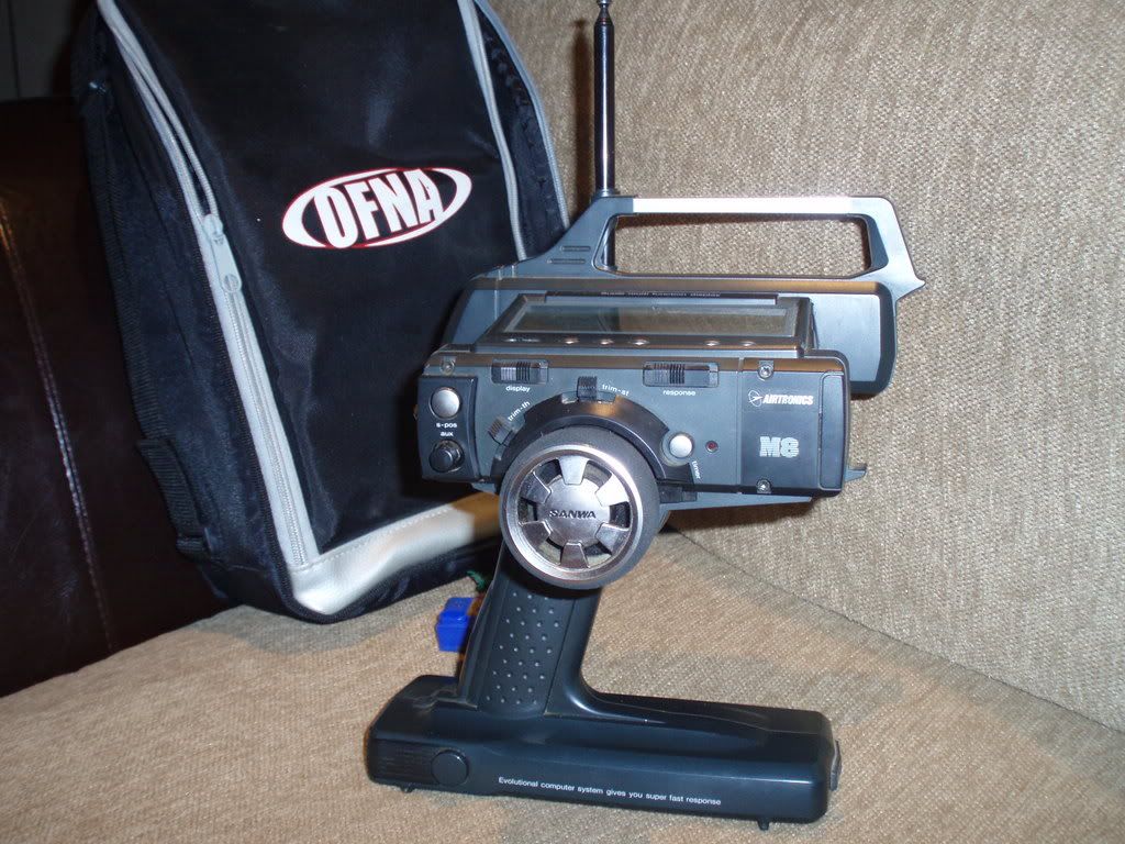

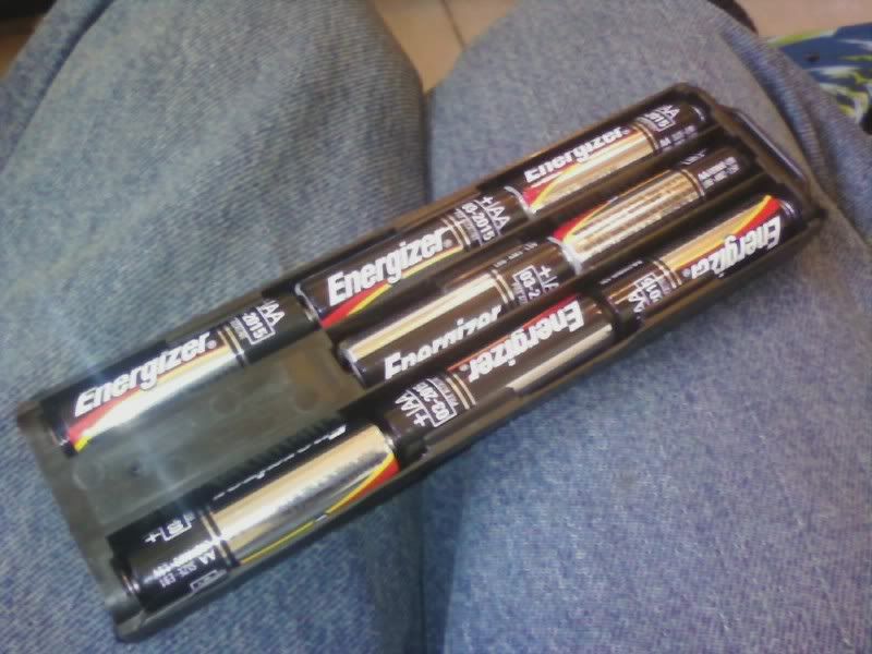

Some more pics, and yes the m8 does work with futaba rx's :D
http://i152.photobucket.com/albums/s...ad/M8/m8-2.jpg
http://i152.photobucket.com/albums/s...ad/M8/m8-1.jpg
http://i152.photobucket.com/albums/s...ad/M8/m8-3.jpg
Takedown 09.13.2008 01:55 PM
Looks good. Still needs a rechargable TX pack.:yes:
tc3_racer_001 09.13.2008 06:43 PM
problem is, ive had range issues using nimh x8 so i had to use 9x nimh to fix this (i had dead energizers which wouldnt hold their voltage.)
lipo = best option. u could do it if you can cut out that plastic bit and move anything which is housed in it at the moment, u may need 2 flat packs as the pack ive got is like a square (cost $16 from HC)
brushlessboy16 09.13.2008 07:07 PM
i dont know if i want to tear up the controller at the moment:whistle:
tc3_racer_001 09.14.2008 01:31 AM
not hard to undo a few screws to see if theres anything important in the way. then u can re-assess the idea.
brushlessboy16 09.18.2008 07:45 AM
i tried... and failed- tried to make as much room as i possibly could, lipo was just tooo wide. so i ended up making an extension for the power connector inside the controller and mounting the lipo on the front portion of the radio's foot.. i know its not the cleanestsetup bbut it works like a charm:yes:
