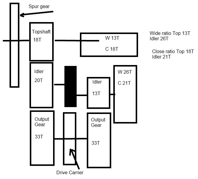

@Chris: Provide me with the internal gear tooth counts (and the final ratio just so I can check to make sure the gears are in the right order) and I'll gladly add them. This pic should give you an idea what I need:
http://scriptasylum.com/rc_speed/images/trans.jpg

OK, so what are the gear tooth counts for each speed?
SnoopMaxx 11.04.2010 07:13 PM
Will this do ?
They are similar to an E-Maxx 3905 with 2 speed
http://i190.photobucket.com/albums/z...ummitGears.jpg
Morten
BrianG 11.04.2010 08:24 PM
Summit transmission added. Thanks SnoopMaxx!

That pic you drew is a combination of a 3-gear setup (2nd gear) and a 4-gear setup (1st gear). Then, there are two versions of 1st gear (wide and close ratio). Took me a minute to see what your pic meant, but was easy after that. :smile:
SnoopMaxx 11.05.2010 03:55 PM
:mdr: Well all my years as a machinist hasn't gone to wast then :lol:
