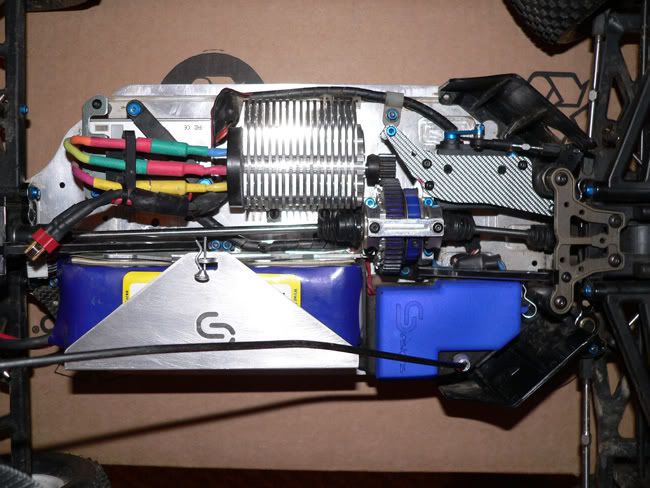

CAD is more fun when you get to see the fruit of your labor, that is...............getting the parts made in real life! :yipi: Here's a pic of the real truggy that was made from the above CAD files. Considering it was my first truggy, first 4wd, and first 1/8, I think it was sweet and still to this day when I dream of new layouts for truggies I find myself circling back to this one as a valid solution to the project objective.
if you want to see the project, there's a thread on the thing from initial CAD concept to final design. The truggy was stolen and I even got it back. Quite a trip that truggy's had.

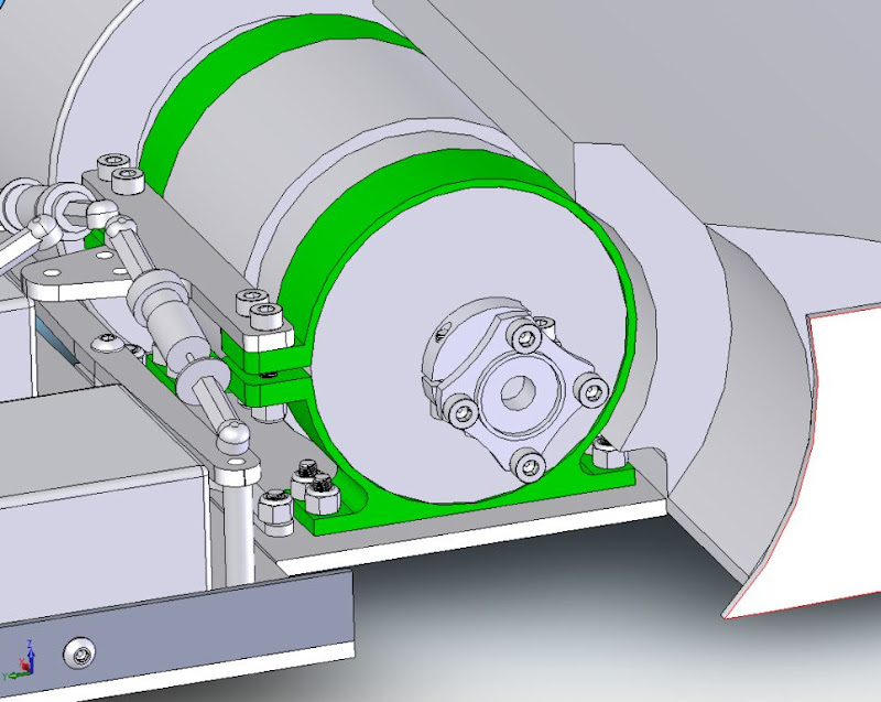

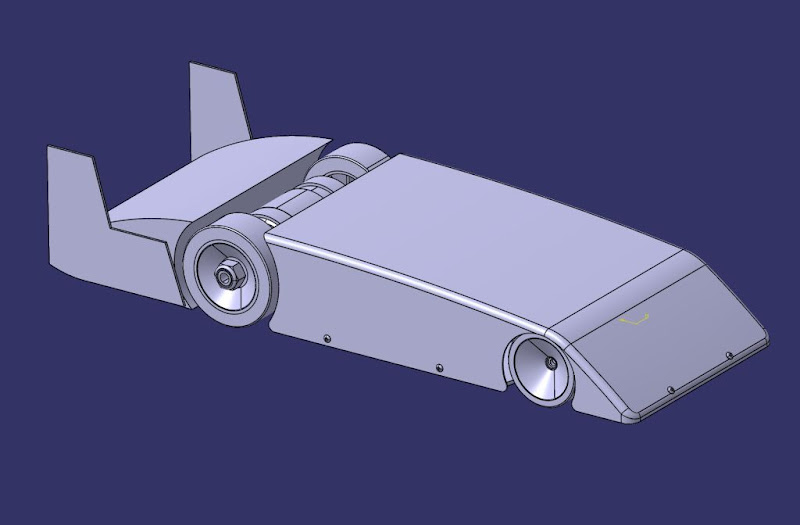

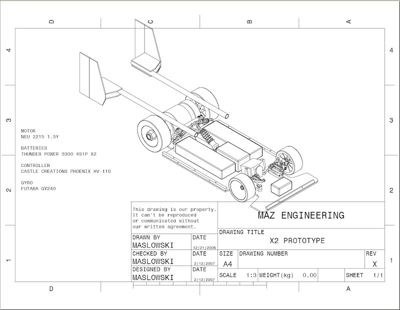

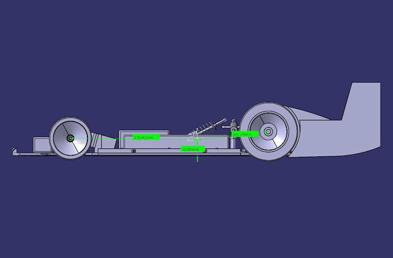

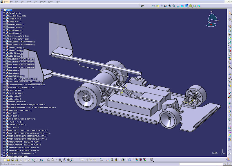

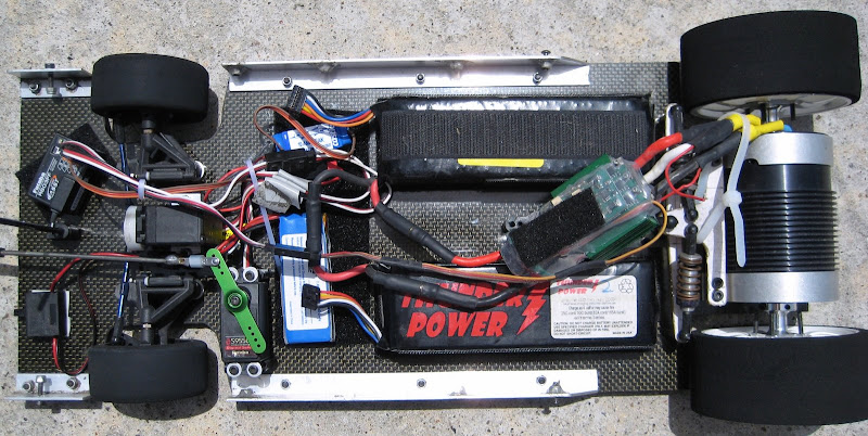

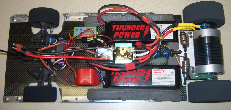

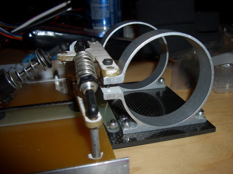

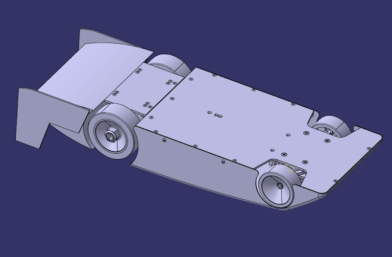

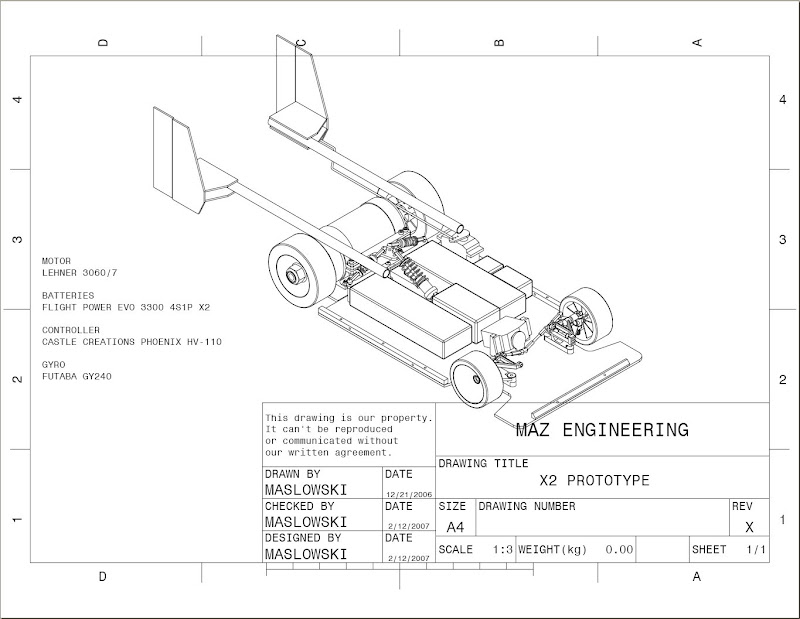

These are CAD pics of my "X2" speed run car. I initially designed the whole car in CATIA V5 then did some tweaking in Solidworks. I started designing it in late 2005. There are a couple different iterations that the car went through before I started to fabricate.
I had initially designed it with a Lehner, then I switched to a Neu. My first design used a 1/8 scale type wheel connection then I switched to a 1/10 hub. I am still testing the X2 today.

wow, thats a work of art b4Maz... How fast has it gone?
B4maz 11.15.2008 08:06 AM

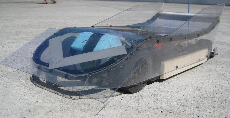

Thanks Brushless! 89 mph as of last weekend. I keep blowing tires but I think I have solved the problem. I needed a lot more down force. Its front wheel drive. I found that I cant run the car rear wheel drive. Its impossible even with a gyro. This is what it looks like in its current form:

89 is still fast..
keep us posted :D
B4maz 11.15.2008 12:01 PM
Originally Posted by brushlessboy16 (Post 232933)
89 is still fast..
keep us posted :D
No problem. Its designed to go around 110mph on 8s.
