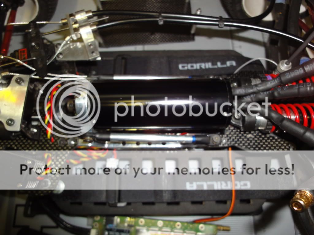

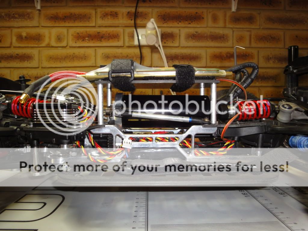

Hey guys i have an update on the build here are some pics
http://i705.photobucket.com/albums/w...0/DSC00004.jpg
http://i705.photobucket.com/albums/w...0/DSC00005.jpg
It wasn't easy but i managed to shove a 1527 1Y in there. So far testing on 6s looks very promising. Next in line for future mods are motor mount mod, i need to make it a little thinner so the pinions have more shaft to bite onto, and i may also convert to 1/8th shocks as the packs get bigger and heavier. Its the only draw back from doing an all out revo build. You are eventually limited by how much sprung mass the stock shocks and springs will support.
suicideneil 03.27.2010 07:15 PM
1527? You plannng on launching it off a ramp & into obrit? :lol:
Look forward to sering it running :yes:
Kcaz25 03.27.2010 10:06 PM
Looks great! I like neil can't wait to see it run. Should make some BIG power.
Nard Cox 03.28.2010 04:47 AM
X3 on the above. That is totally sick !! That thing can practically fly.
Manne 03.28.2010 03:05 PM
Awsome build man, truely impressing, havenīt ever seen anything near it! keep up the good work:)
SV6000 03.28.2010 10:09 PM
