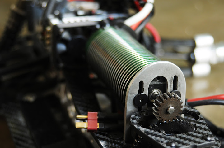

Continuing with the experiments... I was getting a little concerned again about the temps and them getting higher when I eventually switch over to lipos.... so I decided to make some changes
with ESC setup and pinion to see if I would get better results... and I did... I remembered when I was first testing the hacker, the 'Torque Selection' was change from 'Soft' to Dynamic Initial Torque'...
So I went back through the Quark programming and changed the initial torque to 'Normal 1', one step above 'soft'... I swapped the 15t pinion for a 18t just too see what would happen... this motor
had so much torque I assumed it could handle the gear up... I was not wrong about this, The motor showed off what it could really do with it's power and pulled the truck just as hard when it was fitted with the
15 tooth... Very impressive to say the least... the temps were also surprising... the esc only got to 112° F :surprised: (well it had some help from the heatsink)... I thought it would have been much higher with the
larger pinion... the motor stayed in the high 120s :mdr:

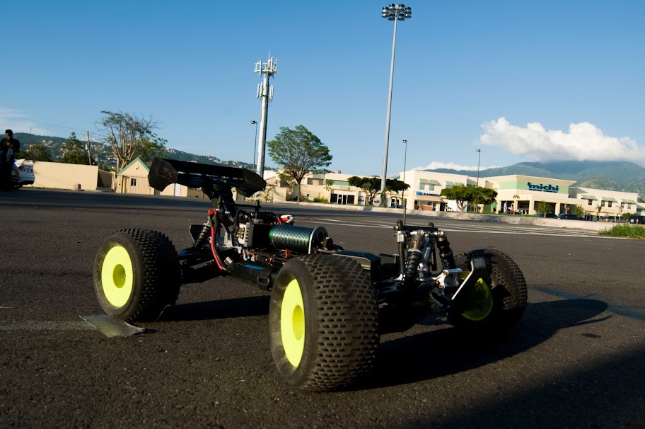

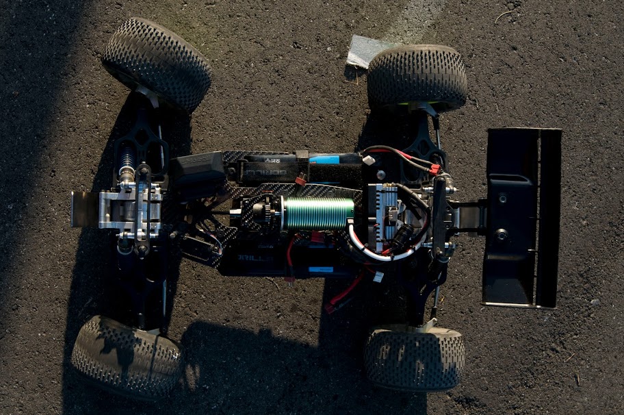

Well, I went out on Sunday to have a little fun with new motor... Still geared 18/51 and running it on polyquest packs (5s), the truck was a handful... torque, torque, torque, torque and more torque!!!:yipi:
When front wheels finally settled to the ground, it ran beautifully... ballooning was the major issue for the day. I think most of the oil in the center diff has leaked out, therefore allowing majority off the torque
to be quickly transferred the front tyres... this made them balloon wildly (they're not taped)... so much in fact they came off the rims (even after re-gluing them on site)... the tyres didn't last very long with
the abuse they suffered and after two packs, the tyres had little grip left on them... there was still quite a bit of torque going to the rears... enough to have the truck doing wheel stands whenever I squeezed
the throttle aggressively... it made it a little challenging to get the truck off the line in drag races with my friend's G4... I lost two races because the truck could not keep all fours on the asphalt...:whip:
The temps were real good... the motor saw high 120s to 130°F and the esc peaked at 122°F... all in all... the truck was a whole lot of fun...

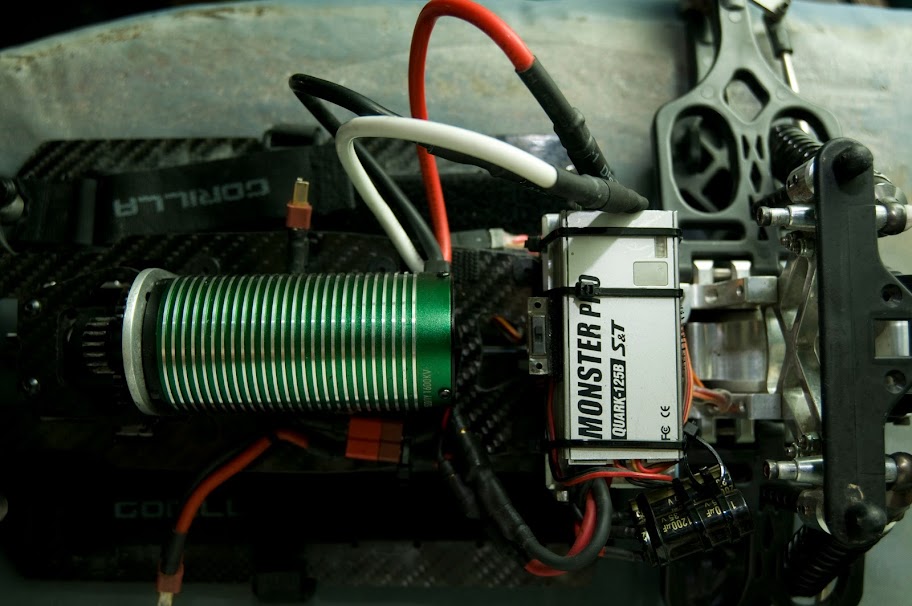

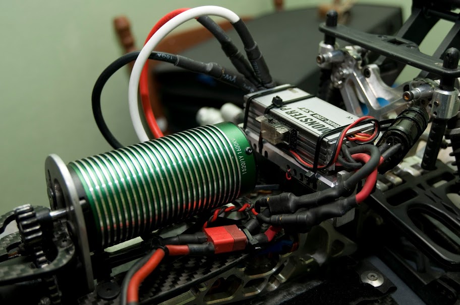

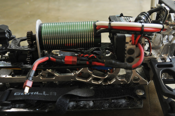

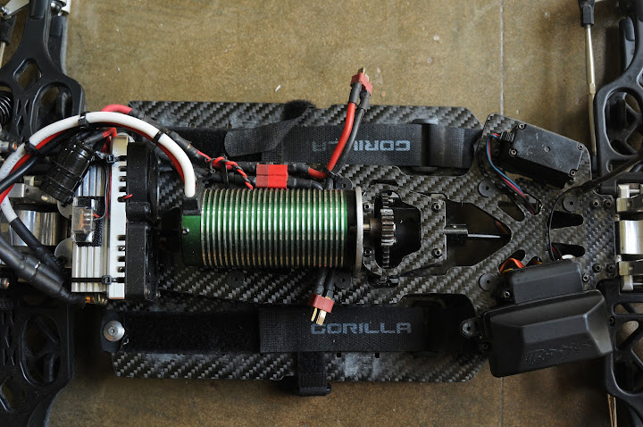

I'm still messing with the orientation options for the esc... the fan is now facing downward... didn't do any test runs yet to find out if it made any difference with cooling...
http://lh5.ggpht.com/_4vPm5E8J5HA/S0...2/DSC_1803.jpg
http://lh3.ggpht.com/_4vPm5E8J5HA/S0...2/DSC_1804.jpg
The motor wires will be shortened as soon as I'm settle with the layout
