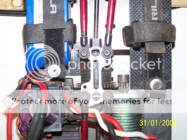

Originally Posted by Kcaz25 (Post 358489)
Those red 7075 T6 TRX rods are a great choice for chassis bracing, but I'd(and am using) use bigger rod ends(links). These (by Dubro)are about 20% percent bigger and are made up of harder plastic. The screw hole that attaches to the rod will need to be drill out a touch as they are too small. I highly reccomend them. I've got 12 of them on my truck LOL and haven't broke one after about a year.
http://i420.photobucket.com/albums/p...a/100_1822.jpg
http://i420.photobucket.com/albums/p...a/100_1806.jpg
The other 4 links are in the steering making 12 monster ball links in all.
Nice trucks by the way!
-Zack
Great idea, but only IF you have a set up like this. I'm not sure where you would mount this stuff using a stock tranny and a Dude mount.
Kcaz25 05.28.2010 02:30 PM
I meant to quote THIS post(minus the pics) when posted that comment. Retrospectively I guess I was just trying to show off my Maxx lol I'm sorry JT and MisterC
