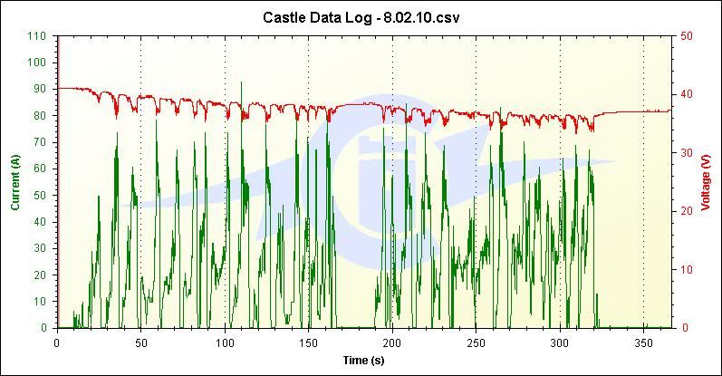

brian015 08.02.2010 04:12 PM
I tried this on 10s for the first time today. I again geared for 50mph (16t pinion) so that I could compare performance and temps to my 8s setup. Unfortunately my run was cut short by a broken pinion :cry:
I drove it hard again and used up 2.03Ah in just over 5 minutes. Comparing temps to my last logged run, it appears that both the esc and motor are running cooler.
Temps at end of (shortened) run:
ambient: 76F
esc: 105F external 118F internal
motor: 136F
batteries: 108F
The batteries I used for this were Turnigy 3600mAh 30c - and they didn't seem to have as much punch as the 40c batteries I normally use.
Here's the voltage and current plot:
http://i779.photobucket.com/albums/y...read/80210.jpg
Max current: 92.5A
Max power: 3147 W
What this tells me is that 10s is better, but I should stick with batteries with a higher current rating (although the 3600mAh 30c's should easily be capable of the currents I logged today). I'm looking at buying some new packs since my 40C 5000mAh packs are losing some capacity, and this shows me that I want to plan on running this on 10s in the future.

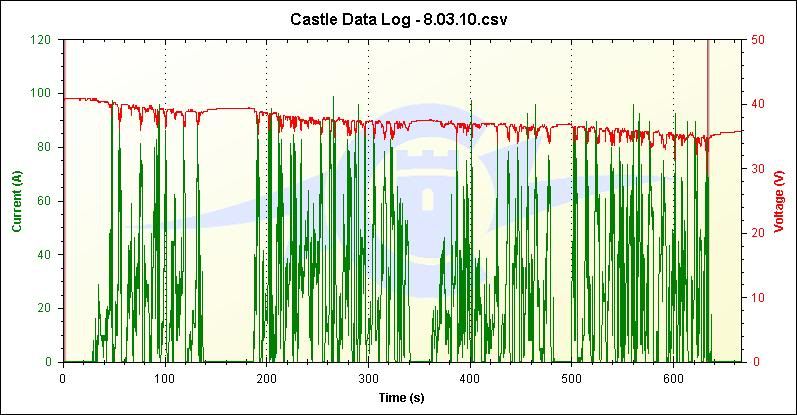

I ran this today with 10s Turnigy 5000mAh 40c. I had to gear higher since my 16t pinion was broken. Gearing set-up:
Differential Ratio: 4.090909090909091
Transmission Ratio: 1
Other Ratio: 1
Spur Tooth Count: 48
Pinion Tooth Count: 17
Total Voltage: 37
Motor KV: 825
Tire Diameter (inches): 6.84
Tire Ballooning (inches): 0
Motor Current Draw: 0
Motor Coil Resistance: 0.012
Spur/Pinion Ratio: 2.82 : 1
Total Ratio: 11.5508 : 1
Tire Circumference (inches): 21.49 inches (545.81 mm)
Rollout: 1.86:1
Total Motor Speed: 30525 RPM
Vehicle Speed: 53.78 mph (86.38 km/h)
Effective KV Value: 825
KT constant: 1.64 oz-in/A
Motor Torque: Amperage not specified...
Final Torque: Amperage not specified...
Final Power: Amperage not specified...
Here's the voltage and current log:
http://i779.photobucket.com/albums/y...read/80310.jpg
Max current: 98.9Amps
Max power: 3619W
Temps at end of run:
ambient: 80F
esc: 122F (internal) 138F (external)
motor: 168F
batteries: 112-120F
So, I'd say my temps are about the same as 8s, considering I was geared slightly higher today. So much for my hope that 10s would bring my temps down. The only advantage might be battery temps were slightly lower - since I'm not pulling as much current as on 8s.
Then other thing I see is that my 5000mAh Turnigies seem to be giving out. I only used 3.97Ah today before hitting lvc.
So I need to look for some new packs - as much capacity as I can fit in this, I'll probably go with 10s, although it doesn't seem to matter.
