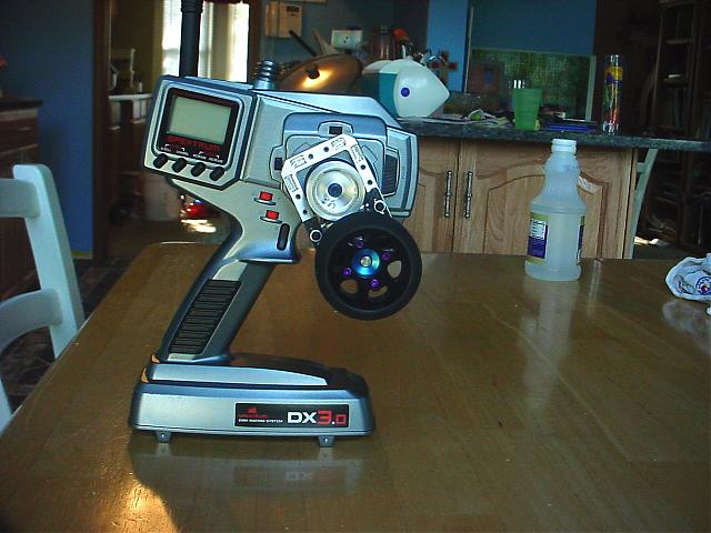

BrianG 05.02.2008 02:27 PM
Does anyone use a Spektrum DX3/3.0 and HV-110 in your setup?
I'm curious how to set up the controller and radio so they work together; things like EPA, trim, etc. I got CH3 mixing for the rbake working on my setup, but the ESC does not want to arm. I have the ESC set to auto-range on startup, but no-go. I can also get into programming via the radio (just to test the radio), but cannot change settings. So, I assume the ESC is not seeing the low throttle point. I'm trying to think of how an air radio would work and emulate that, but that's obviously not working.
I currently have the forward EPA set to 125%, and the reverse EPA set to 0. Trim is at the default 0. TBH, I didn't spend too much time trying this, but wanted to get a test run with 28 Ni cells just to see.
jzemaxx 05.02.2008 02:31 PM
I have the 2.0 which is the same.....I had to use the pix stix convertor. Works like a champ after that.
BrianG 05.02.2008 02:51 PM
Hmm, I know there are those who did not need the Pistix. I might just call Castle and see what they say if I don't see any responses here in the next hour or so...
jzemaxx 05.02.2008 02:52 PM
I know it made it a snap to program.
BrianG 05.02.2008 02:56 PM
Yeah, I WAS going to get one, but remember hearing others not needing it with the same radio/ESC. Maybe I should try the "fixed endpoint" setting instead of the auto-calibrate mode. Truthfully, I don't see myself programming via the stick - I was just trying it out to aid in radio troubleshooting.
lutach 05.02.2008 03:02 PM
I didn't have a pistix. For running the controller I had a hard time finding the right setting which was more like a aircraft radio setting (TH trim all the way to brake and adjusted the EPA accordingly). For programming I used an different model in the controller with default setting.
B4maz 05.02.2008 03:05 PM
Brian, you're exactly right. I didn't need any tools to setup my HV-110. You need to take off the auto-calibrate in the castle program for the HV-110. Its the same problem I had in that it would never remember my endpoints. Once you set it to fixed endpoint, it will be easy to do. Your setup is close to mine. I have a Futaba 3PM 2.4ghz 500mW amplified with a HV-110, 8s Thunder Power, Neu 2215.
BrianG 05.02.2008 03:18 PM
Hmm. I just got off the phone with Castle Tech support and they said there was no way to set the radio or ESC up to do this without the pistix. I didn't feel like arguing that it HAS been done so I just thanked him and moved on. I will definitely try the fixed point setting now (did not see the post before I called).
BTW: In case anyone is wondering, pistix is apparently pronounced "pie-sticks". I was saying "piss-sticks", lol. Foiled again by inconsistent English grammar! :dramatically shakes fists at sky:
B4maz 05.02.2008 03:26 PM
You can definitely do without the pistix. It might help using it, but once I changed the HV settings to fixed endpoint, all I had to do was adjust the throttle EPA and trim until i got the HV-110 to arm. The only problem is that I have to hold brake to keep the motor from running. If i have the trigger in neutral position, the motor will run slowly. Its just an annoyance and I should fix it, but it works just fine.
lutach 05.02.2008 03:51 PM
That's what I did as well and to program the radio, I used to switch to another model memory with everything at defualt and I could get into program mode fine.
BrianG 05.02.2008 04:32 PM
Eh, having to hold full brake is not really acceptable. I guess I'd better go order the pistix...
Mod Man 05.02.2008 05:17 PM
You do not need the pixstix. I have a DX3 with an HV110 and it arms just fine.
You cannot use auto calibration mode.
Actually, mine was very easy to setup. I can power mine up and view my settings through my USB and get back to you with them if you want.
